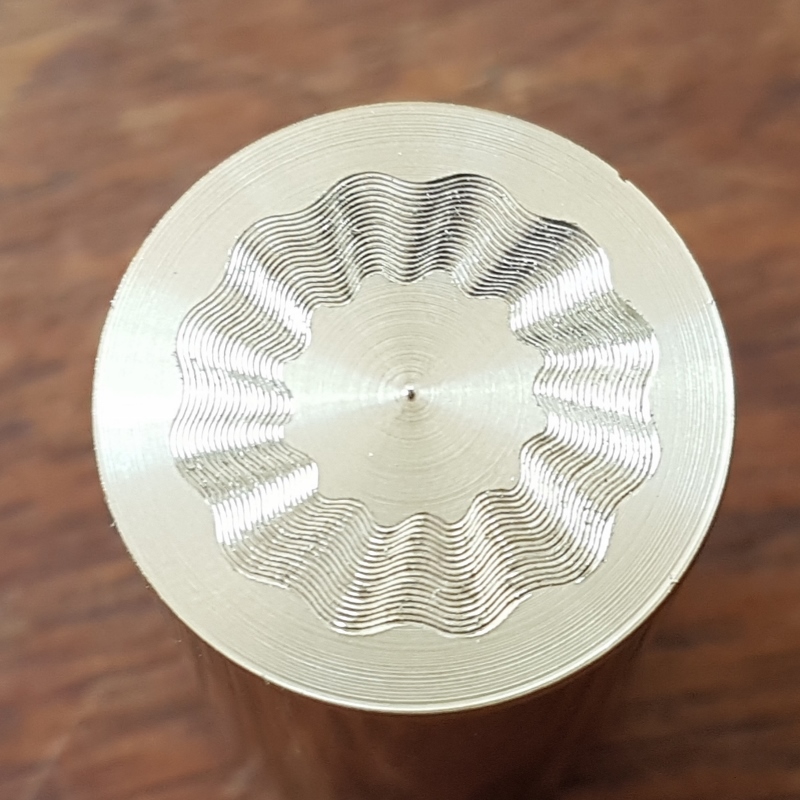

02 Dec 2018 00:26 #121694
by Peter_Cassar
Replied by Peter_Cassar on topic eccentric turning
Here's a small pic of a sine wave modulation on the end of brass bar. I have added a reduction drive to the spindle to achieve sub 20RPM so that more than 12 peaks can be achieved.
- Posts: 12170
- Thank you received: 4153
02 Dec 2018 01:43 - 02 Dec 2018 01:46 #121695
Looks awesome Peter. Great to see the external offsets in action.

02 Dec 2018 03:04 #121699
by Peter_Cassar
Rod, I was thinking that as I watched the cutting action, it's not far off how a gear could be produced.
