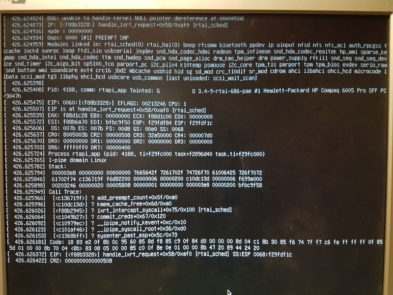

Even with a RIP the configs will live in ~/linuxcnc
I suggest copying the config from the config.old folder into a config_2.7 folder in the root of linucnc/configs if you want to retain both versions on the same machine.
It might help if you could take a photo of the screen after the crash (assuming that copy/paste isn't going to work)

27 Nov 2018 22:48 #121496
by Peter_Cassar
Replied by Peter_Cassar on topic eccentric turning
Andy, I didn't see my post in the forum but here it is again See the screen shot from my controller. Only the Mesa configs are crashing. I'm using the 7I43 400k board with spindle encoder input . The other sample configs seem to work.
Peter.
Peter.
- Posts: 19899
28 Nov 2018 00:12 #121501
Replied by andypugh on topic eccentric turning
How does the latency test do? This looks at first glance like an RTAI problem.

- Posts: 19899
28 Nov 2018 10:35 #121521
The question was actually whether the test ran at all without crashing, so that seems like a yes.
The function that is crashing is inside RTAI, not LinuxCNC. (Google for handle_lxrt_request ) so this might be a hard problem to track down.
As far as I can ascertain LinuxCNC doesn't even call that function directly.

- Posts: 19899
28 Nov 2018 16:57 #121532
I don't know why it only affects Mesa, but it could be related to the hardware access.
Did you do the "sudo make setuid" stage of the build?
at the ./configure stage, did you specify a realtime library to be used?

28 Nov 2018 19:38 #121543
by Peter_Cassar
All sorted. I failed to configure it for RTAI. I rebuilt and it now runs properly with my Mesa Hardware. Now to test the external offets and eccentric turning!
Thanks for your help.
