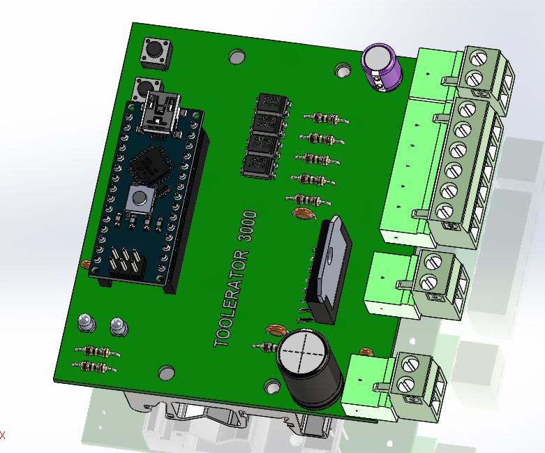

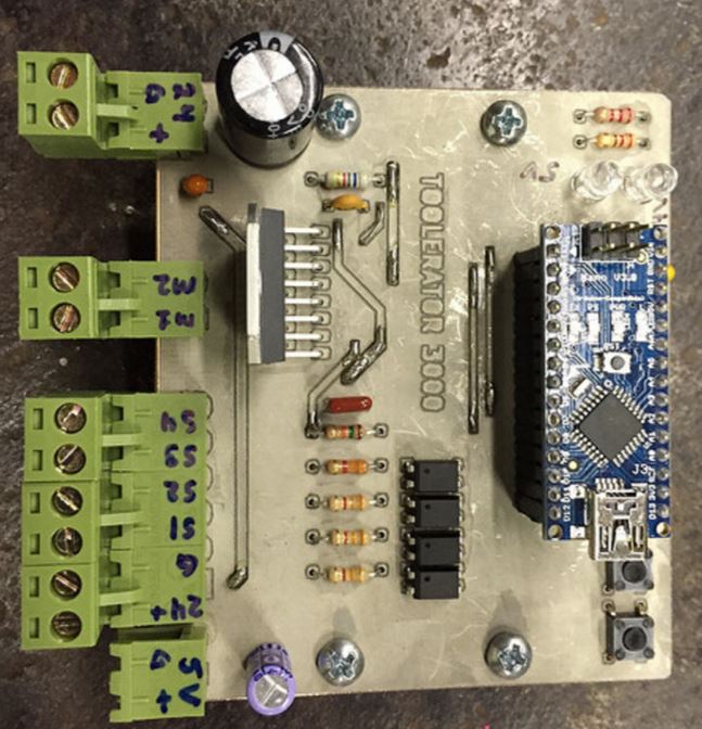

I am helping a friend, Dale Grover, to retrofit his Emco EMCOturn120P lathe with new controls. On our lathe we have what is considered the "older style" 8-position tool turret which is driven by a 24V DC BLDC motor. There is also a position encoder on the turret that reports the 8 tool positions in gray code. Dale developed a nice Arduino Nano based hardware board that uses the Ti LMD18245 Full-Bridge Motor Driver to drive the motor and to drop current when the motor backs against the pawl. He also wrote the Arduino code (called a Sketch in arduino speak) to drive the turret.
The operation is, you issue a tool change in Linuxcnc (ie, M6 T1), it sends that request along with the tool number via the USB port to the Arduino. The Arduino reads the turret encoder, drives the motor to change the tool if necessary, and returns the same tool number as an indication of success. Linuxcnc receives the tool-changed success and Bob’s your uncle.
Since we have 1-8 physical tool positions on this turret we map tool numbers 9-16, 17-24, 25-32, etc., etc., back to physical request for tool 1-8 (essentially mod-8). That way you can set up a tool table for different jobs. i.e., job #2 uses tool numbers 9-16. You load those tools in the turret: tool 9 in position 1, tool 10 in position 2, and so on. The component will map the tool request back to physical positions 1-8. Tool 0 request (no tool) is ignored.
I suspect this solution may work with the newer style Emco turret as well, but I don’t have one to try. I am fairly sure it wouldn’t take much modification in any case.
Anyway, we are making this solution open source so have at it - if you care. All the files are currently located here: bgp.nu/~tom/pub/toolerator3000/

PDF viewable schematic of controller board: mstc_schematic.pdf
PDF viewable board layout: mstc_pcb.pdf
KiCAD schematic and board layout files: mstcPCBFiles.zip
Linuxcnc userspace component source code: toolerator3000.comp
Arduino sketch source code: Toolerator3000.ino

Indeed you get credit, Thanks ArcEye! The component looked very much like yours when I was done. Peter obfuscated it quite a bit, but all the serial init stuff is yours verbatim.
I am happy and don't anticipate any changes. I haven't done EXTENSIVE testing but have done enough to believe it is done. Feel free to add it to the wiki.

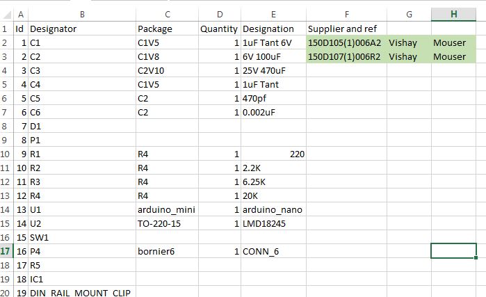

I am planning to reproduce your Toolerator 3000-C PCB for use on my emcoturn120. I have the files from the open source site listed above but I cant find a way to output the BOM from KiCAD. would you happen to have your BOM list? I imagine with some work I will be able to find all of the components but I thought you may already have a spreadsheet bom you could post. Any help would be appreciated.

I will check with Dale to see if he has a list of parts. I was able to find these two hits for producing a BOM from KiCAD:
forum.kicad.info/t/kicad-bom-wizard-plug...tml-and-csv-bom/2142
rheingoldheavy.com/kicad-bom-management-...detailed-components/

no problem. I did figure out the output from KiCAD and got the attached, but it was a little generic so I am guessing on some of it. I started going through and identifying the actual parts and where to buy them and thought since you are very organized you might have a spreadsheet already. Between this and the photos of the Toolerator 3000 PCBA on your picture site I think I can get it done. I will post it when I finish, if you could review it to make sure I did it right (Im an ME after all
