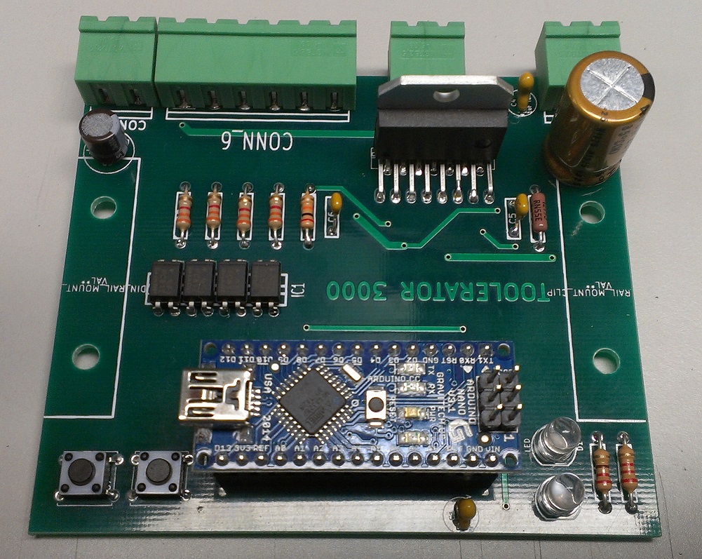

Looks very nice. By the way, did you send the PDF layout of the board that was include with the files to the board house? Or did you produce gerber files from KiCAD? Just curious because I just realized that all the component labels are underneath the parts (once populated). Dale did that because he was cutting the board on our cnc pcb milling machine. So he didn't arrange the mask as it should have been for a board layout. If you were ever to do another run of boards, I would suggest KiCAD be run and the component labels be moved out to where they can be seen when components are populated. If you ever need to replace the electrolytic caps, for example, you want to know which is + and which is -.

Toolerator 3000 PCBA built but not tested. I still need to get a 24vdc power supply and the turret assembled.

I just dumped gerbers from the KiCad. This was my first experience with a pcb. Its funny because I soldered it at work in an esd workstation because its slow right now. The tech I had review my solder joints was confused by the silkscreens, he was worried I had the optical couplers 90 degrees out becuase of the silkscreen, but after we reviewed a bare board he saw they wouldn't fit the other way. so that makes sense now. Of course I don't know what is normal or not, I never really looked at pcb boards because the EE's at my job always handle that. I ordered the din rail power supplies same as the ones you linked so Ill be able to power it up by the end of the week and maybe cycle it. That will be a thrill
