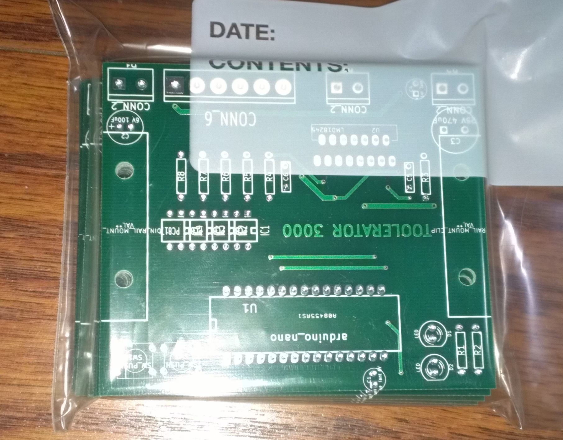

I have 10 bare boards coming because that was the cost structure of the board house. I was going to try to build 10 and share those at a little over cost to recoup some of the costs for my PCBA but some of the parts are quite expensive so likely I will get 2 sets of parts and that way I can practice and maybe have a spare. So if someone wants a board I will have some available, I may buy the small discretes for all 10 but the connectors and the driver likely not.
this sounded terrible
. not trying to make money. The bare boards were $41/10, the place was minimum 10, so If someone wants a bare pcb then I will be making 5 available immediately for $5 sent in a 1st class envelope (should be safe).

19 Apr 2016 16:24 #73604
by LutzTD
Replied by LutzTD on topic An open source Emco 120P lathe tool turret control
IM me your address, Ill send you a couple for free.

19 Apr 2016 20:09 - 19 Apr 2016 20:11 #73614
by LutzTD
Last edit: 19 Apr 2016 20:11 by LutzTD.

19 Apr 2016 20:41 - 19 Apr 2016 20:41 #73615
by tome
Replied by tome on topic An open source Emco 120P lathe tool turret control
Look nice! I sent you a message (I think - may have been sent twice actually)...
-Tom
ps: where did you get them made?
-Tom
Last edit: 19 Apr 2016 20:41 by tome.
- LutzTD
- Posts: 216
20 Apr 2016 01:00 #73625
by LutzTD
I'll send a board out tomorrow. I got them from a proto house in China, they turned them very quick. www.pcbgogo.com/ stateside sources were 10X, much as I would have liked to get them made here in the US the price is prohibitive.
