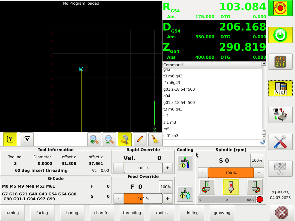

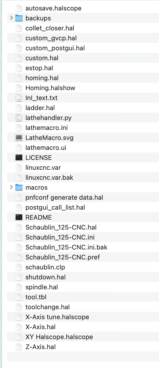

I finally got back to my Schaublin conversion, and am just trying to get Andy's lathe macros installed and working. I am missing something here. Still on 2.8 with Gmoccapy. I saw the issues with NUC's performance on 2.9, and think I'll stick with what is working fine for now.
The macros are installed and linked:
If I click on one, loads it.
I thought I had all the necessary widgets added to my INI, but the SVG picture and selection boxes are not there, nor any extra tab.
Here is the directory structure:
I have attached my INI. I'd appreciate if someone could point out my error/ omission.

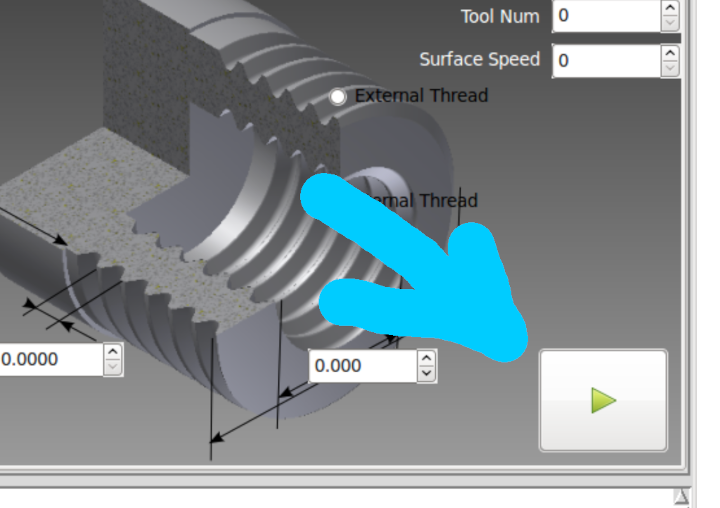

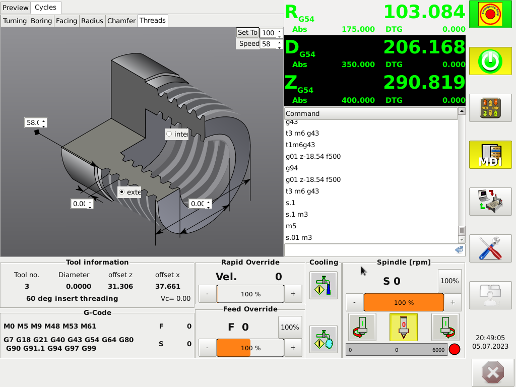

I have been working through Andy's Lathe macro thread, and picked out a couple of nuggets which have moved me along in getting this installed and working.I now have the tab installed.
However I don't have the start button available:
What do I need to add to get that button?Also, the scaling of the input fields needs to be adjusted. It is not clear to me what I need to do to modify that.Any suggestions to address these two issues is greatly appreciated.
The INI is attached below.

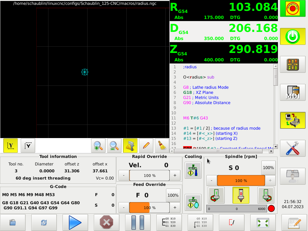

You can't run a program on the MDI tab. Click on the button below MDI to enter auto mode and I;m sure you will find what you are looking for!
- Posts: 4806
- Thank you received: 2163
06 Jul 2023 04:28 #274877
Replied by Aciera on topic Schaublin 125-CNC retrofit.
You might already have seen this but here was a discussion about that button not showing and andy seems to have posted a fix here:
forum.linuxcnc.org/41-guis/26550-lathe-macros?start=400#271603

Thanks for your help guys. And a big thanks to Andy for doing the lathe macros. That is a really nice conversational interface.
I now have it up and running. That last UI update has the button visible, and corrects the input field sizes.
I have a half-arsed rough spindle scaling set up, but am getting to the point where I have to stop procrastinating, and sort out my over complicated spindle control algrythm.
