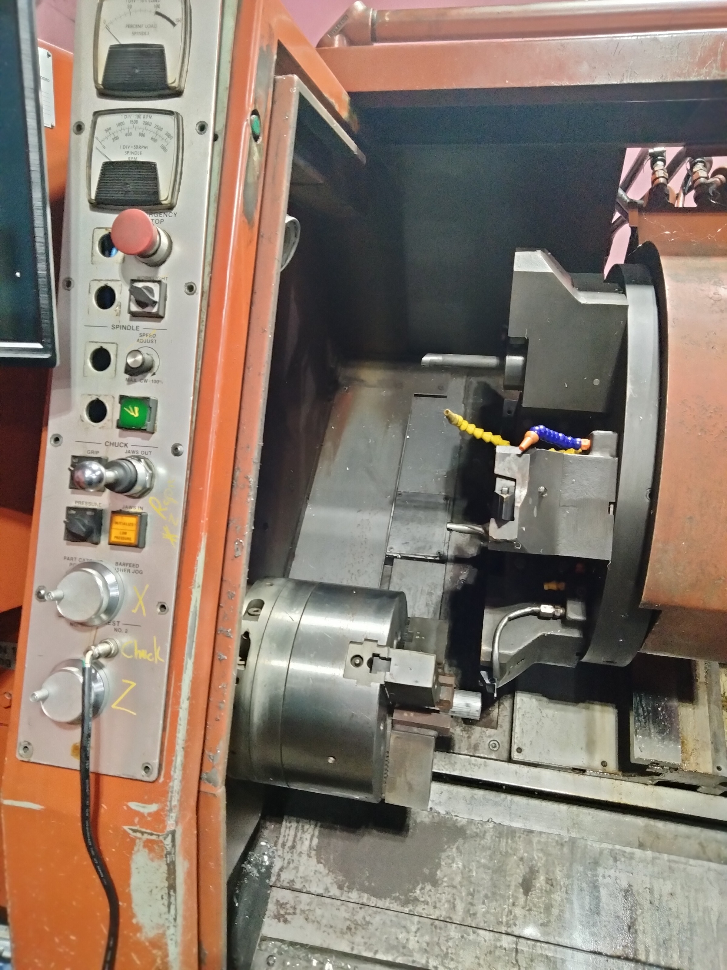

this is my temp configuration, x z rapid joystick, x z mog dials, connector for my foot switch for my chuck " i wrote a hal component for this check hal examples" .
everything else is pretty much dead. I'm not a fan of having turret jog controls, long borings etc will hit stuff. better to write a macro that calls g28 for a tool change and move the carriage somewhere safe
I'm still prototyping my controls layout, but it's going to be a variation of this with some dedicated buttons.
Very, very good point.

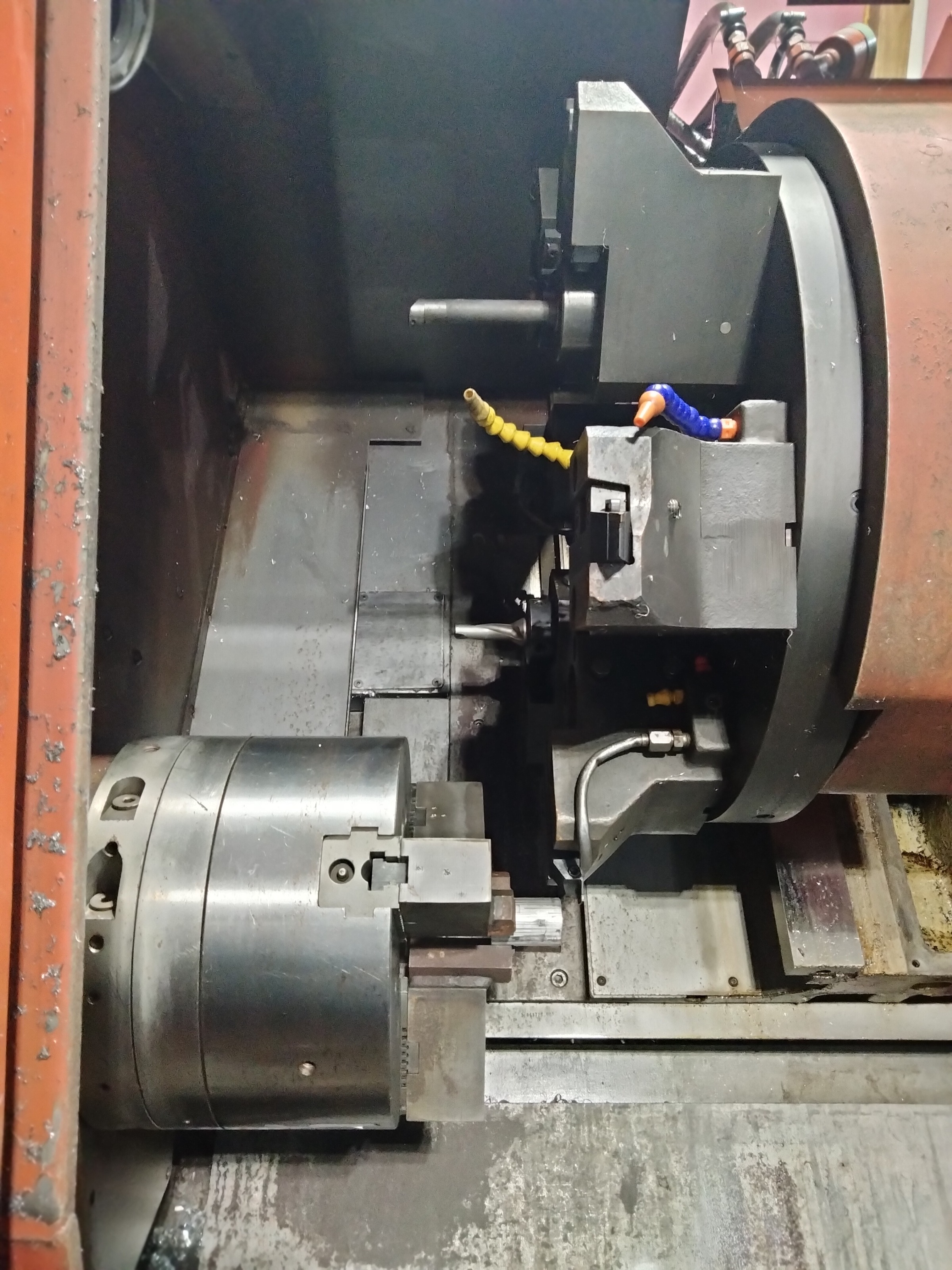

I get super paranoid with some of my large drill bits, I have a 3 inch drill that is 14 inches long out front of the tool block, and that thing will smash shit. I am working on writing some macros for tool change related stuff. heres my attempt
see post below for edit
and some hal file stuff
net jog-tool-up halui.mdi-command-00 <= your_input_pin_for_tool_up
net jog-tool-down halui.mdi-command-01 <= your_input_pin_for_tool_down
setp halui.mdi-command-00.string "O<jog_tool_up_down> CALL"
setp halui.mdi-command-01.string "O<jog_tool_up_down> CALL"
and more info
[RS274NGC] ... SUBROUTINE_PATH = /path/to/your/subroutines/directory
I think this will require adding the macros to the INI file as well. I haven't made it that far yet. I started working on a macro to move y Z up and down during toolchanges, because the carousel on my SLV40 only goes left/right or along the X , the bmc20 has the carousel move up and down and the bmc30 is like the slv40, so I started with the carousel I had the most of.
I scratched this down on some notepad and had chat gpt clean it up, TEST CAREFULLY I HAVE NOT TESTED THIS CODE
and more info

I hate to divert Mark's thread on a tangent... but how do you GOTO in LCNC? I thought that was verboten because reasons.
Or is this for a non-LCNC machine?
