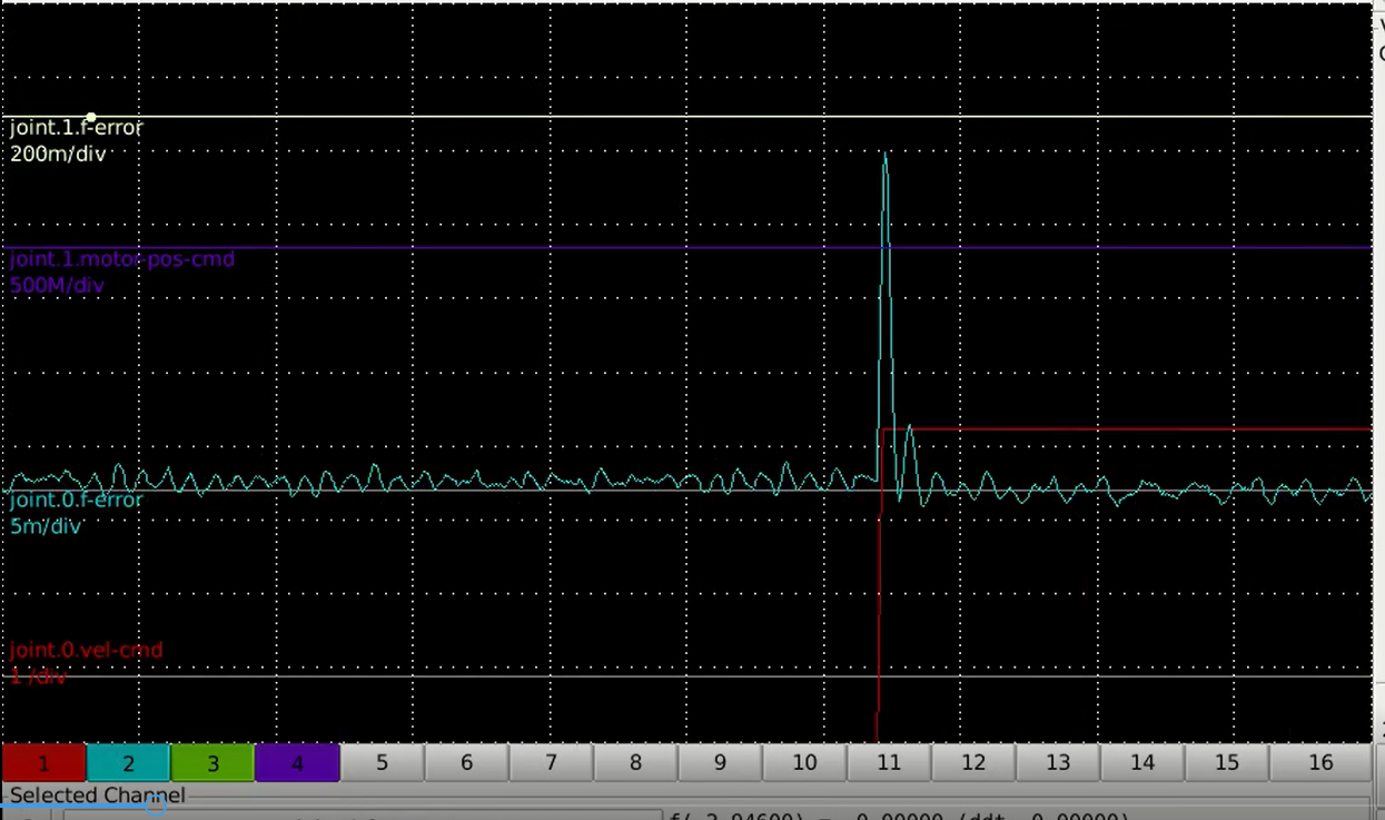

linuxcnc calculates vout from voltage and velocity
if you have 3m/m in your ini over a 10v span, than you need to make sure the drive gives 3m/m over the same span.
that is why you have the gain error. yes my math was backwards, I've been busy trying to solve a different issue.and my brain crossed some wires.
so let me illustrate your gain issue.
of you send a command of 3v, do you get 1m/m ?
if you send 6v do you get 2m/m
lets say the machine could go say 5m/min
same thing
you voltage scaling to velocity is effected by you values in your ini. afaict, your drives are runnig below the requested velocity as it stands. So you can lower you total max velocty setting this in the ini, or increase the drives total velocity to match.
the other possibility, with your current overshoot, is that your declared acceleration rate in your ini is higher than what the drive can achieve.
can you zoom that scop output more ??

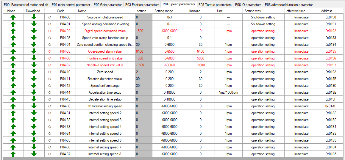

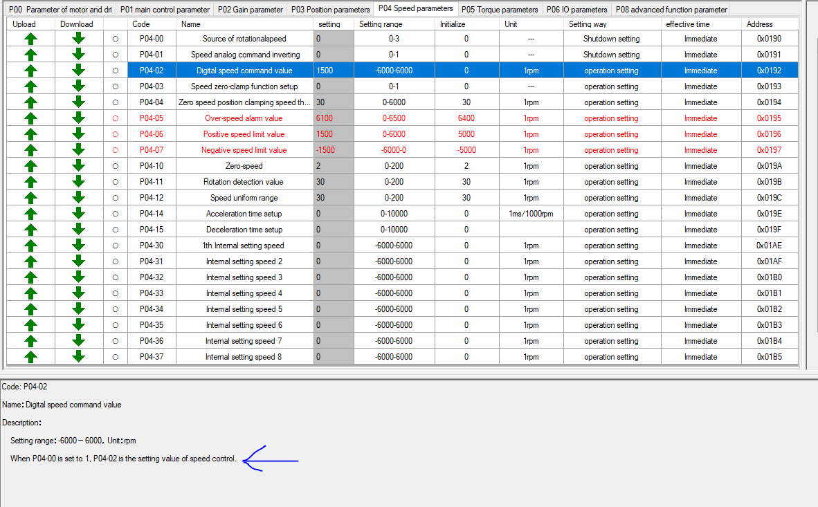

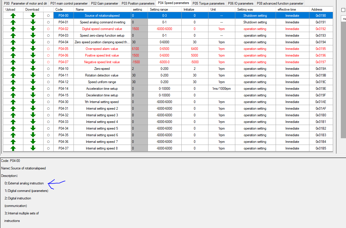

Oh, I think I am slowly understanding. (Thanks for your patience).
Since I want the axis to run a max of 3m/min, I should change the digital motor speed command value in the driver P04-02 down from 3000rpm, to 1500rpm, so that a 10V max speed command from LinuxCNC will result in that 1500 RPM being commanded by the driver, rather than the driver running the motor up to 3000rpm, and and getting told to slow down by LCNC.

I left P00-03 MOTOR RATED SPEED = 3000,
but changed the following:

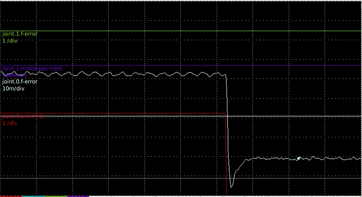

This is the resulting plot with the same P 15, FF0.1 as yesterday. This is the motion reversal with a slow feedrate of 200 mm/min.
EDIT: I just noticed that I doubled the sensitivity. The change made no significant difference yet. The motor is not ringing at idle.

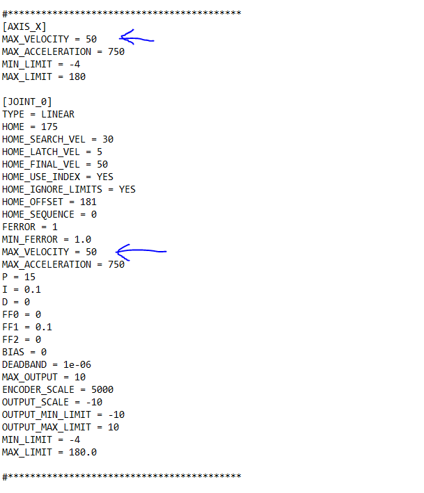

Is this the reason for the separate (to me seemingly redundant) max speed settings in the INI, for both axis and Joint?
Am I supposed to set the Joint to match the driver (MAX Velocity 100 --> 10V --> 3000RPM motor rated speed), and then just limiting it to the desired half that, by setting the X Axis max speed to 50?

I ran up the drivers auto tune till I got resonance (at 21). Backed it off, first to 20, and then after more testing to 19.
The best tuning I came up with so far on X is the drive auto tuned at 19, Linuxcnc P15, FF 0.2.
Next angle of attack is to look whether I have the Accel too high.

yes, you got it. I wasn't sure if your servo was geared down or up from your lead screw. so yes, you need to tune your velocity for your lead screw pitch. Linux CNC calculates your velocity from pulse count versus travel distance.
Motor velocity & gear ratio = actual velocity with lead screw pitch etc accounted for.
Most of my tuning has been with brush dc motors, they have a lot more grunt on acceleration at low speed. If you have extra servo speed, maybe increasing giving the servo motor to lead screw more ratio would help if you can't get reasonable acceleration response. More TQ at the lead screw, More HP at the motor. did this lathe originally have DC servos ?
as to yor prior question.
Yes your drive velocity total travel needs to match in the drive and linux CNC.
For instance
If the drive has to run the motor at say 10,000rpm to go 10,000mm/sec, then your ini value is 10,000mm/sec
you need to account for ALL of the gearing and pulse counts. definitely looks like the acceleration rate is to high, by about 100%. try cutting it in half.
MAX_Accle is currently 750, make is 375, see if that helps
