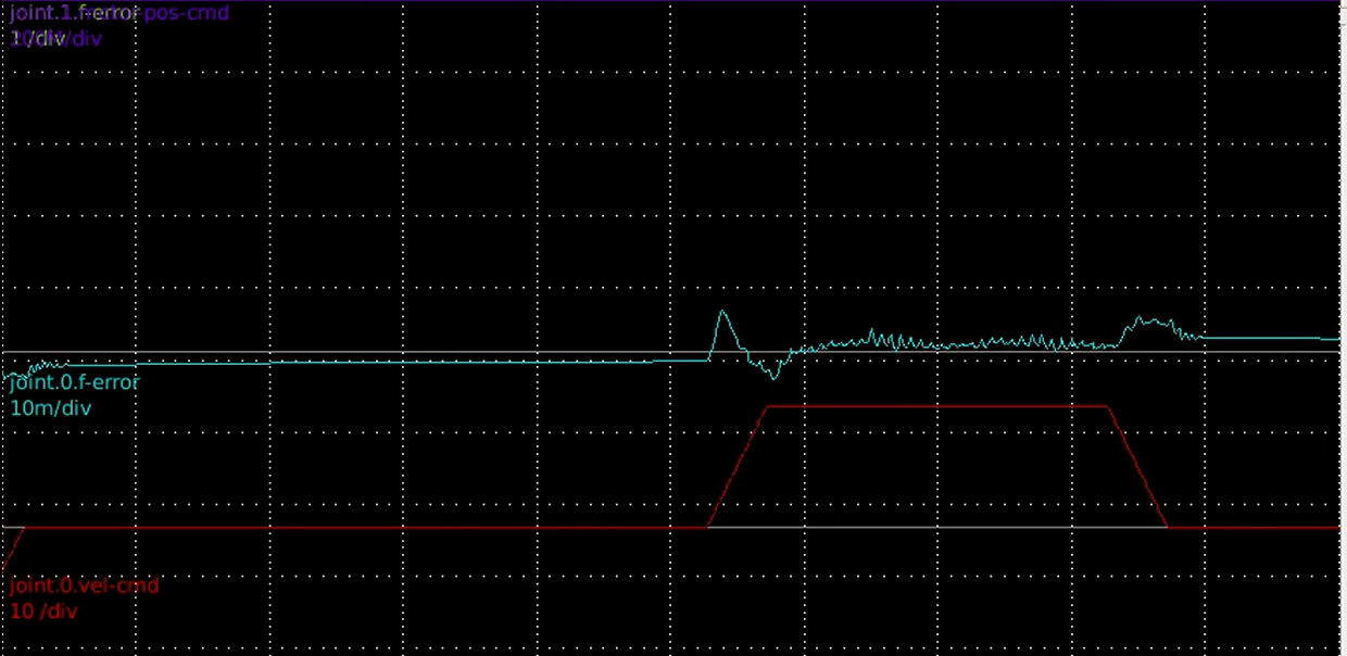

"I'd remove all the lcnc pid authority, tune the drive and ini values to get tight control,"
I halved the accel, and set LCNC to open loop (P0 FF1), and did a 0.25mm feedrate move at 50mm/min. This still creates a following error. Current INI settings are FERROR =1 and MIN_FERROR= 1 on this axis.
Why would I trip a following error, every time, with a slow 0.25mm move if MIN_FERROR = 1?
Once everything is tuned, What would be a normall FERROR allowance for a pretty slow, but hopfully quite precise machine like this? 0.01 Min and 0.025 at speed?
This is the plot.
This is the plot.

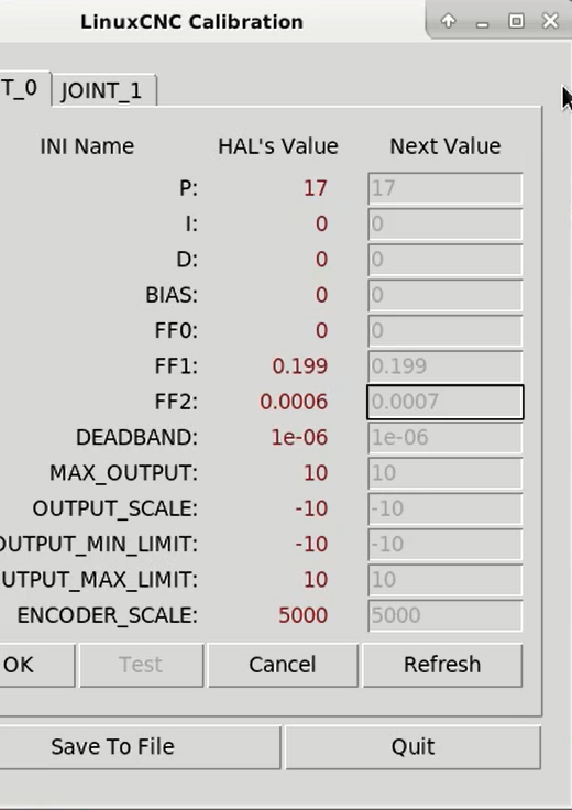

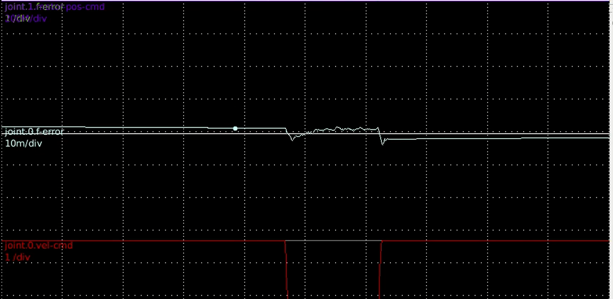

I really cnt see any better way of tuning the drive than using it's "autotune" settings (which are just a look up table of discrete configurations). With LinuxCNC in openloop mode, and doing short jogs within the FERROR, I cant do better with the LinuxCNC Osci, than I can get by just increasing the auto tune to instablity and then backing off.
Having done that, I then used Tommy's tuning instructions once again.
At 200mm/min this is the best I can get tuned.
At 500mm/min :
And these are the best settings I came up with and the plot at 1000mm/min
What are your thoughts on this? How anal do I need to go on this. You can keep zooming and zooming, and can always have it looking terrible.
I rewatched Peter (Talla83) excellent video, where he just used a vise as a crute linear way, and he seems to have only stayed at 1/Div, whereas I am used 10m/Div. At 1/div, my plot is a flat line.
At 500mm/min :

17 Dec 2022 17:37 #259746
Replied by tommylight on topic Schaublin 125-CNC retrofit.
At 10m/div that looks really good.
Try faster.
Try faster.

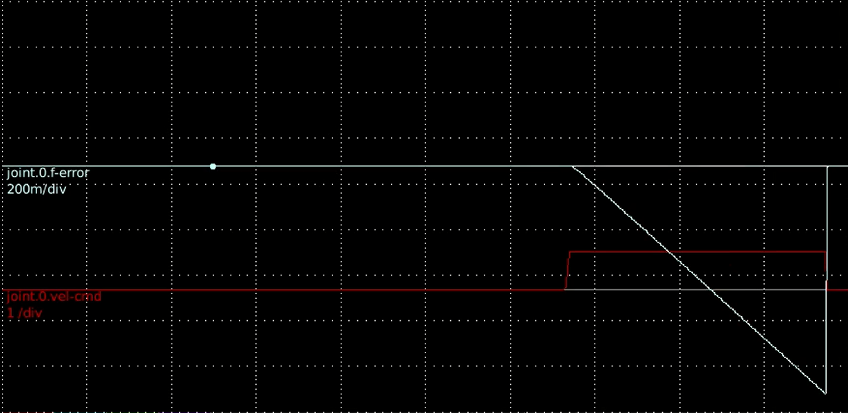

"have you calculated out the variables fpr the servo control and drive ??
max motor rpm = x velocity mm/sec"
Yes, I have both drives set for 150 RPM / V, so they will max out at 1500RPM.
X 1500 rpm -->1:2 --> 750 rpm screw --> 4mm pitch = 3m/min
Z 1500 rpm --> 1:3 --> 500 rpm screw--> 6mm pitch = 3m/min
My Ini is set for max rapid = 50mm/sec --> 3m/min
Those plots are with the LCNC PID. With the LCNC in open loop, the FError plot is useless, as it is just a divergent graph. In LCNC Open loop, all I could do was keep increasing the drive stiffness with auto tune values till is resonated, then back it off till stable.
