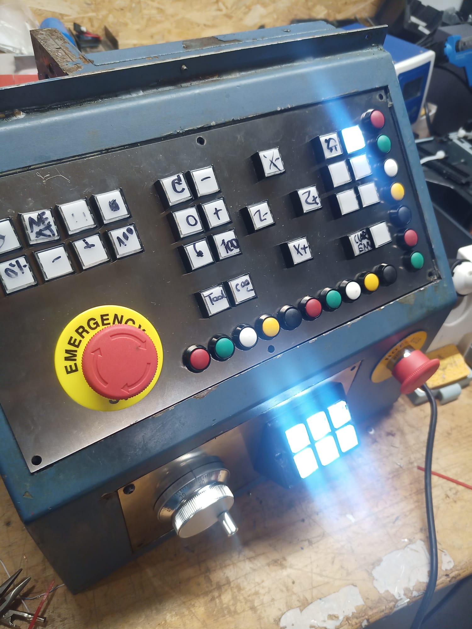

have now the config folder on github, as a personal backup.
github.com/DoWerna/padovani_retrofit/
There is still some Hal logic to be written, but slowly the electronics can be mounted on the lathe.
btw
The wiring of the matrix was more work than I thought.
I think if I have to make a panel again, I'll get a PCB made that fits directly on the buttons from behind, with the matrix there fixed in traces.
You also have to draw it first but i think its the faster way...
btw

Now I have connected 7 control lamps to 7 outputs of the 7i73.
Driven by a uln2003a...

trying to write my HAL as far as possible already here, to have less worklather in the workshop.
Configure now my spindle.
What seems strange to me.
The index signal of the spindle seems to be connected to nothing.
hm2_7i92.0.encoder.05.input-index is not connected to anything in the hal.
this is the section in the hal

- Posts: 19904
17 May 2022 11:09 #243176
Replied by andypugh on topic Padovani LE-200 Retrofit
Looks right to me.
net spindle-index-enable <=> hm2_7i92.0.encoder.05.index-enable net spindle-index-enable <=> spindle.0.index-enable

18 May 2022 02:39 #243251
by DoWerna
Replied by DoWerna on topic Padovani LE-200 Retrofit
thanks for checking.
My Maho has no spindle encoder, so I had no comparison.
The panel is now configured.
Also the simplehandwheel logic works.
now it goes to the lathe
