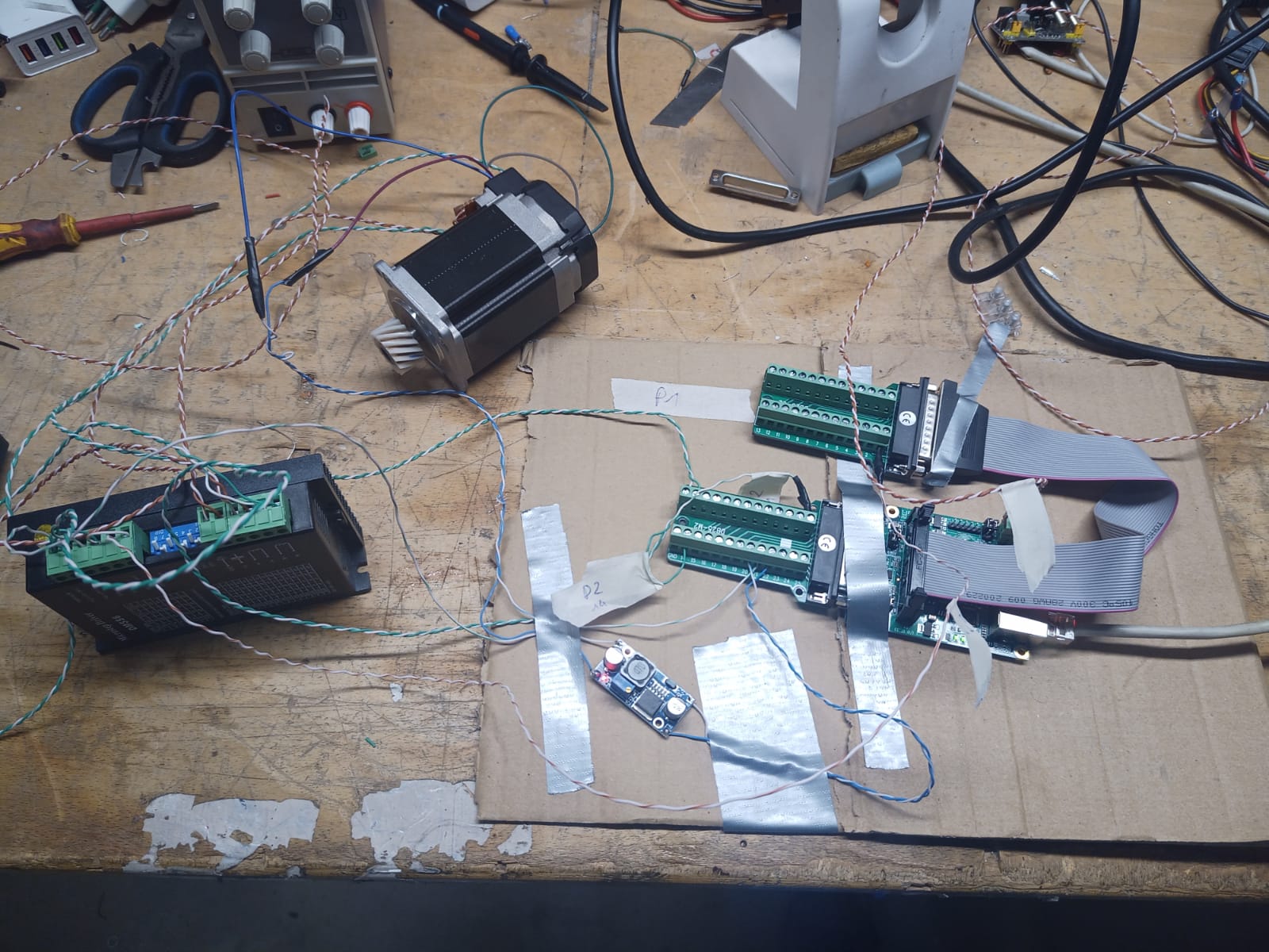

I made a small test setup to test a possible manual operation.
7i92 drives a stepper with encoder, the encoder gives feedback directly to linuxcnc.
So a closed loop setup.
Haven't found a way to turn off the servo driver without the axis going into ferror when you move the servo too far.
Only possibility I found is to turn off the machine.
The dro still works.
However, with the machine turned off, I obviously have no spindle and no coolant.
Search has also found only one topic.
www.forum.linuxcnc.org/38-general-linuxc...manual-combo-machine

yesterday I wrote a small Hal logic.
a hal pin that disables the drive.
the falling edge from the same pin turns the machine off, to prevent the machine from moving back to the last given position.
With ferror set high everything worked as intended.
Then wanted to assign different ferrors with mux2 depending on the machine state.
Unfortunately, the ferror is read directly from the ini and is not available as hal pin.
So I can not change the ferror on the fly
Translated with www.DeepL.com/Translator (free version)

Thank you, that was the decisive tip.
I have now got it working.

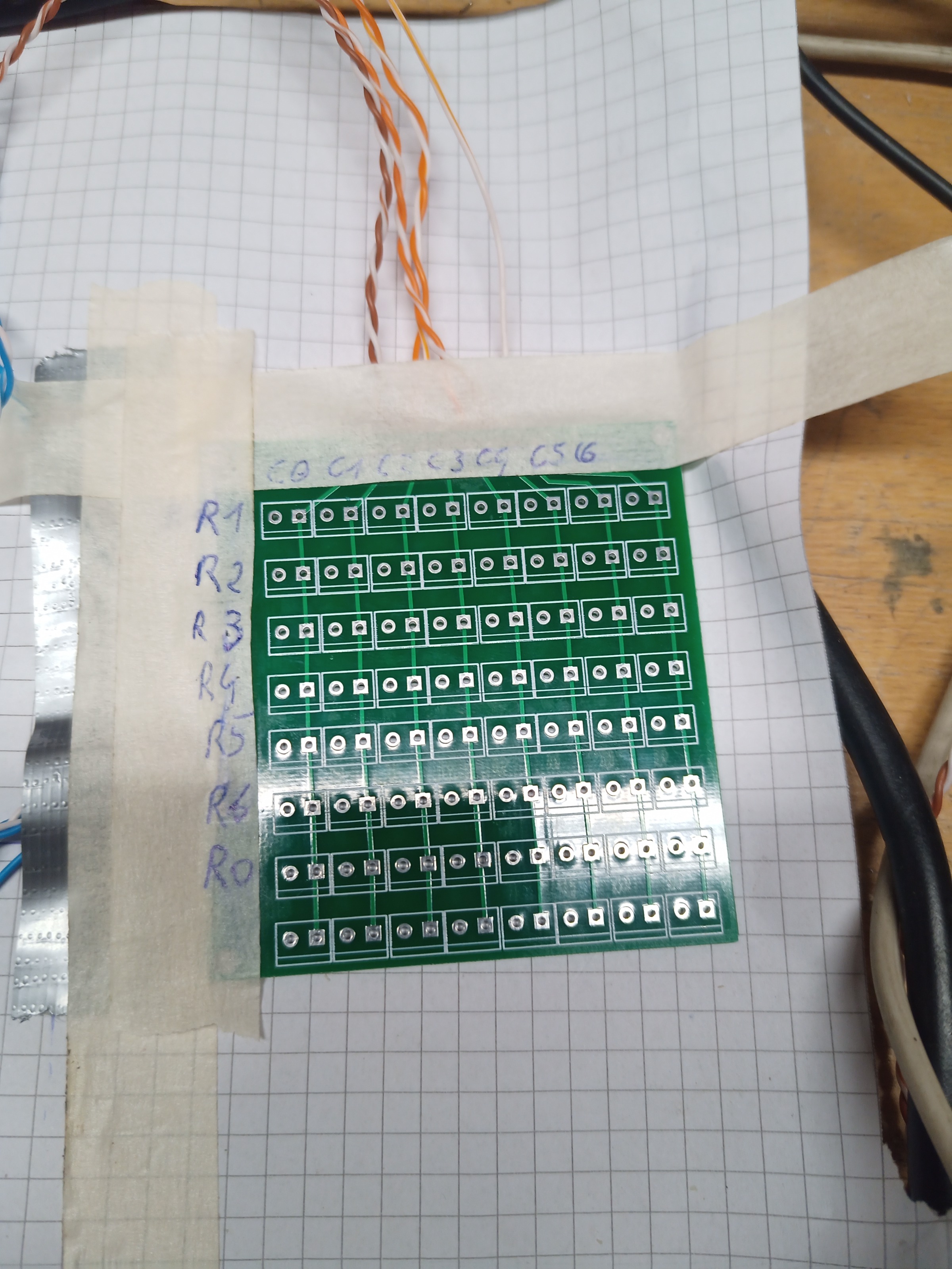

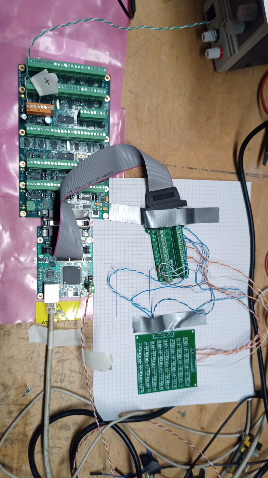

have set up a small keyboard matrix.
on P1
with a small Matrix-PCB
strangely it does not output the rows correctly
when i bridge button r0c0 on the board key.r1c0 is set high
button r6c0 outputs key r0c0.
have checked all the wiring, should be correct
this applies to the complete row.
so everything one row offset.
