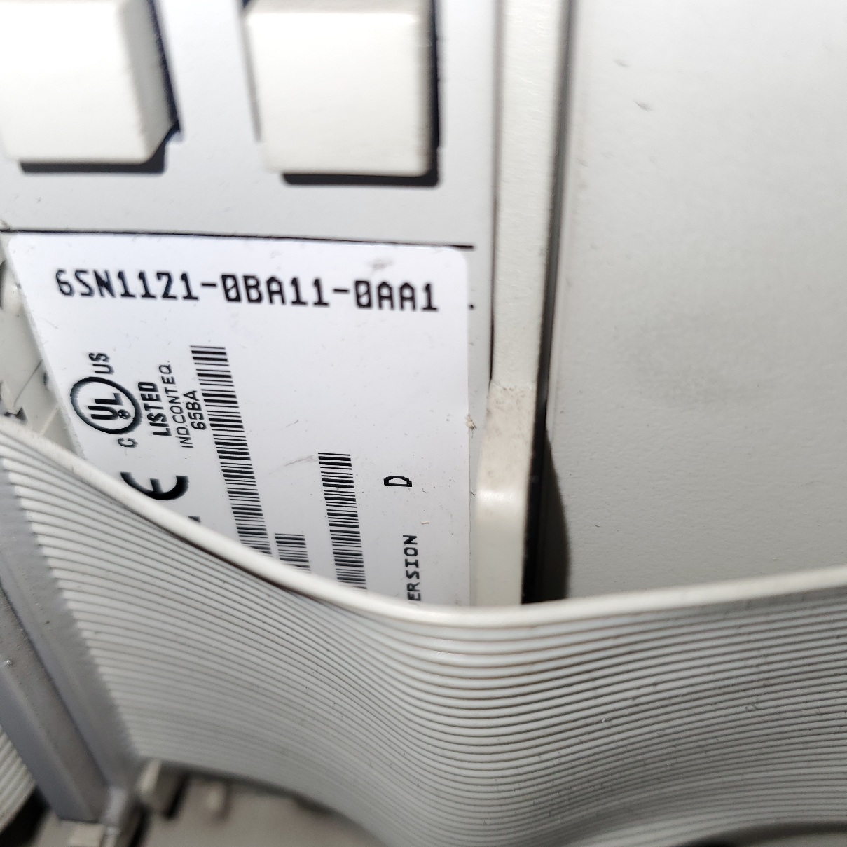

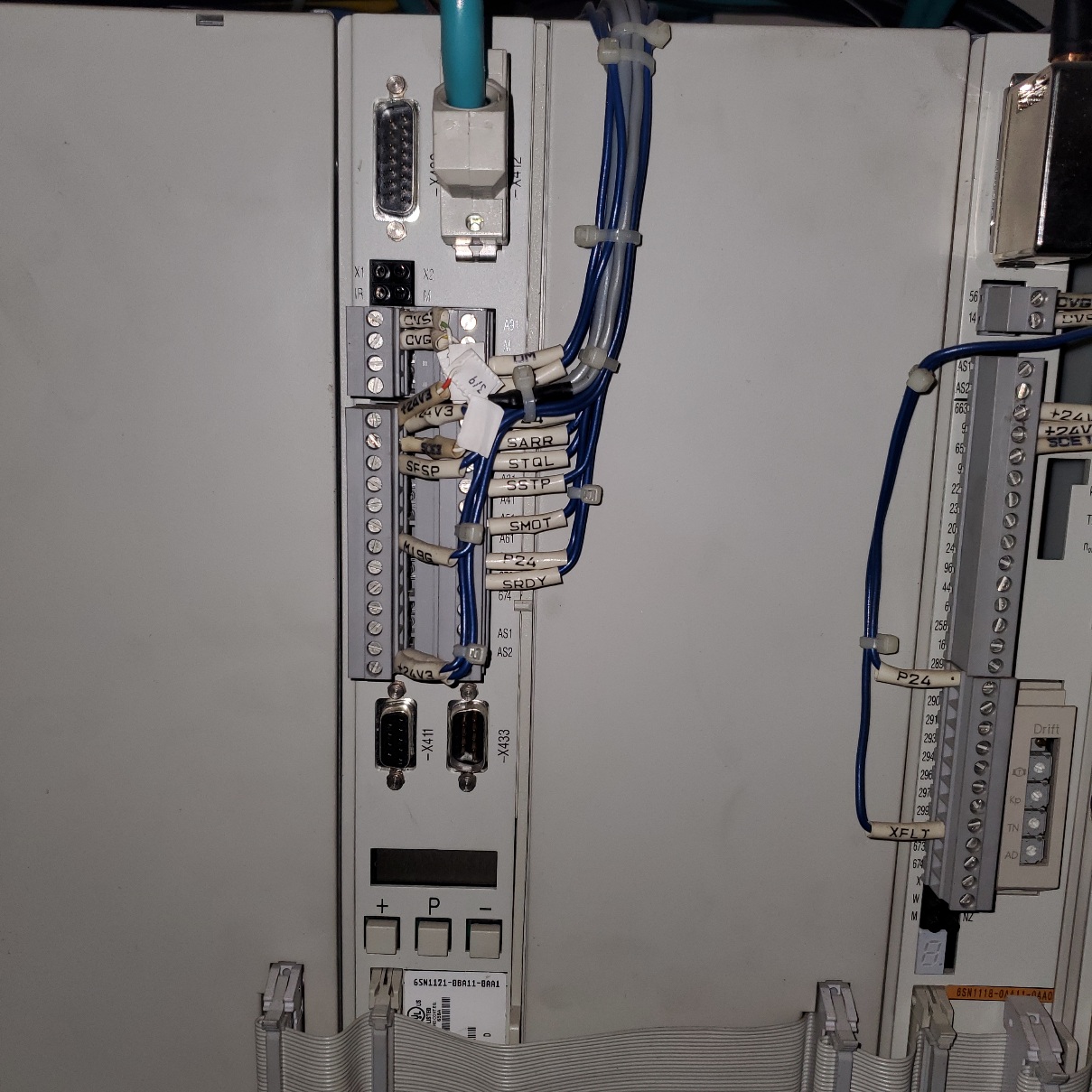

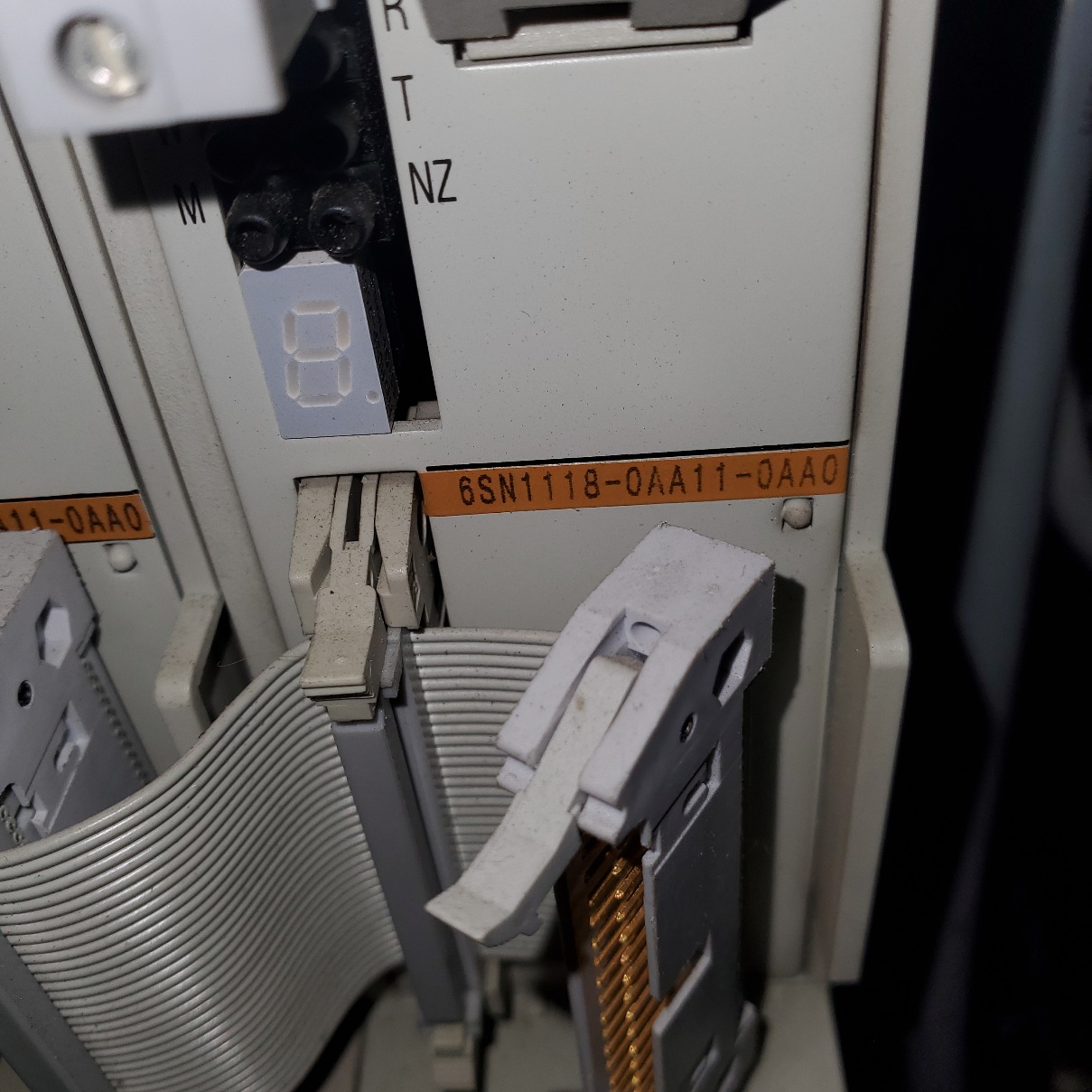

Any idea if theres a visual differance between the 2?

- Posts: 21928
- Thank you received: 7468

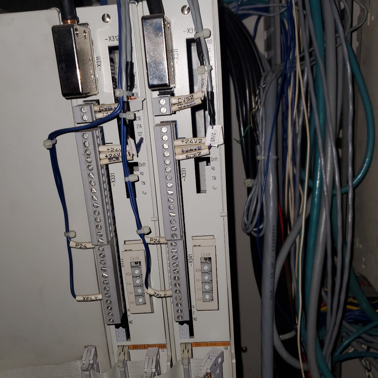

24 Dec 2022 00:22 #260197
Replied by tommylight on topic Huyndai hit 15s retrofit
Wires:
P24 = +24V from other source used for signaling
+24V = what it says, not the same as above, should not be wired together or mixed.
SRDY = servo ready
XFLT = X fault
0VG2 = 0V ground, goes with +24V, not with P24
ZFLT = Z fault
no more
SRDY = servo ready
XFLT = X fault
ZFLT = Z fault
no more

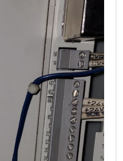

I have the manual in pdf but its a pain to decipher it lol
Ovg2 is cvg2, that and cvs2 are the -+10v
X311 is the encoder but i think its t tapped to the other plug on the encoder card
The 2 +24v are +24v to pluse enable
Sce1 and 2 are controller enable
P24 says speed controller at its end stop, whatever that means lol
I tried to post this before but the fourm is stupid sometimes

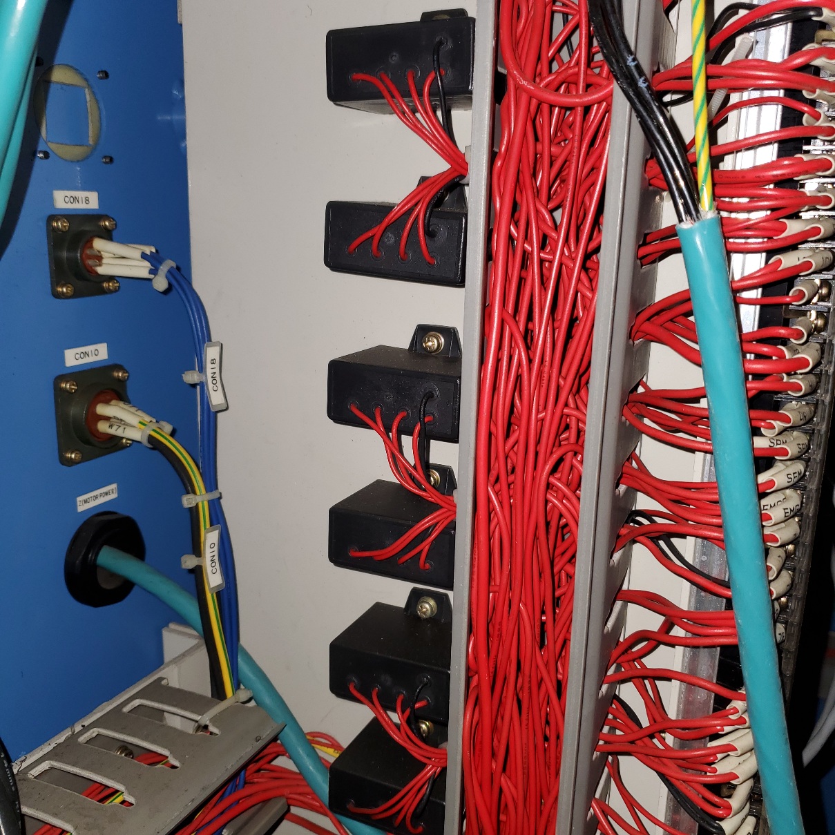

I still need to find what all the factory i/o stuff was connected to the the po helped himself too, this machine has a huge relay board im assuming most goes there. Also im gunna need to figure out the encoder stuff and get some connections to the mesa io
