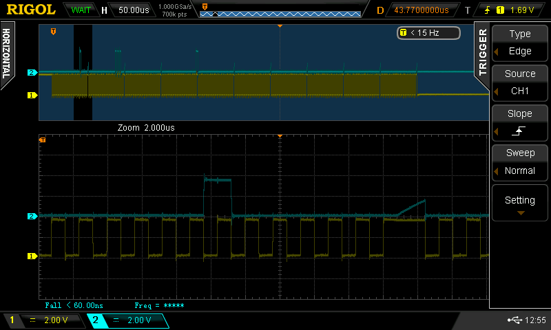

I tested the SPI by looping the master SPI IN and OUT signals as jepler suggested. Then I noticed the 7i90 SPI output always responds by the same word as in case where SPI IN is connected to the ODROID's master SPI or not..
The data word responded is 0xAAAAAAAA as is mentioned in hm2_spi.c source. Therefore I expect the root of the problem is in fact that 7i90 board do not understand to the SPI data sent by ODROID.
Copy of hm2_spi.c source code. where the A code is expected? - I do not understand this code well.
But If I look on the SPI IN signal (At the 7i90 board side with using the 7i90 board ground) The data signal looks fine without any significant signal integrity failures. The oscilloscope image follows. The blue line is SPI data IN (MASTER output) and yellow line is SPI clock signal..
Have you some suggestion what other signal parameters may affect the SPI transmission and could be different from Jeff Epler ODROID-U3 setup? The TXB0104 voltage level translator used in case of ODROID-U3 is non-inverting. Therefore the signal polarity must be the same as in case of direct signal connection between ODROID-C1 and 7i90 board.

The AAAAAAAA is transmitted when there has been a frame timeout (SPI master idle for more than 50 usec) so can be used for detecting the card as long as you guarantee 50 usec of idle time before checking
The SPI "data in" looks bogus in your scope plot, you would expect the first doubleword of a burst
to have a 0xA or 0xB (read or write) command, but it does not (32/64 bit issue?)

22 Mar 2016 16:33 #72039
by kaklik
Replied by kaklik on topic Mesa 7i90 in SPI mode
OK, it looks like a problem with 32bit block write on ODROID-C1 SPI interface.
What is correct frame which should be send to the 7i90 board to get correct cookie response ? eg. {0x55aacafe, 0x54534f48, 0x32544f4d}
I do not know how could be possible to make trouble to odroid to realize 32bit transfers. Because according my understanding of hm2_spi.c driver github.com/LinuxCNC/linuxcnc/blob/master...stmot2/hm2_spi.c#L92
The data are sent per bytes.

Yeah looks like the SPI driver and/or hardware has bolluxed up the 32 bit sends
(the hardware sends a burst of 32 clocks correctly but the data is busted)
