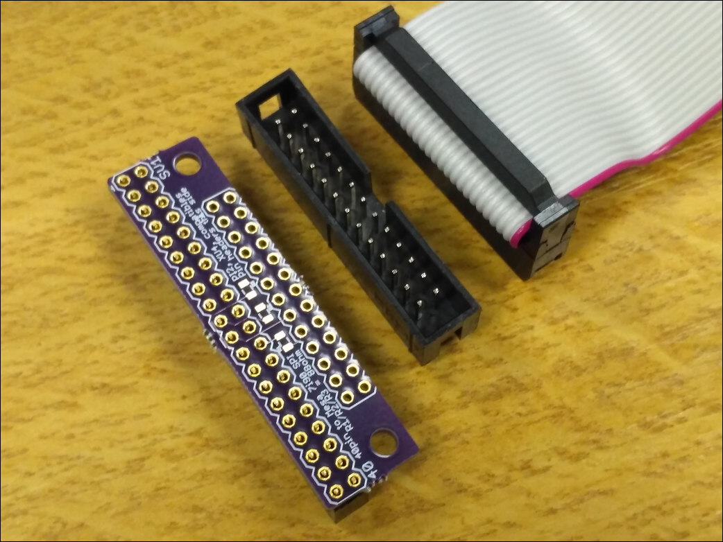

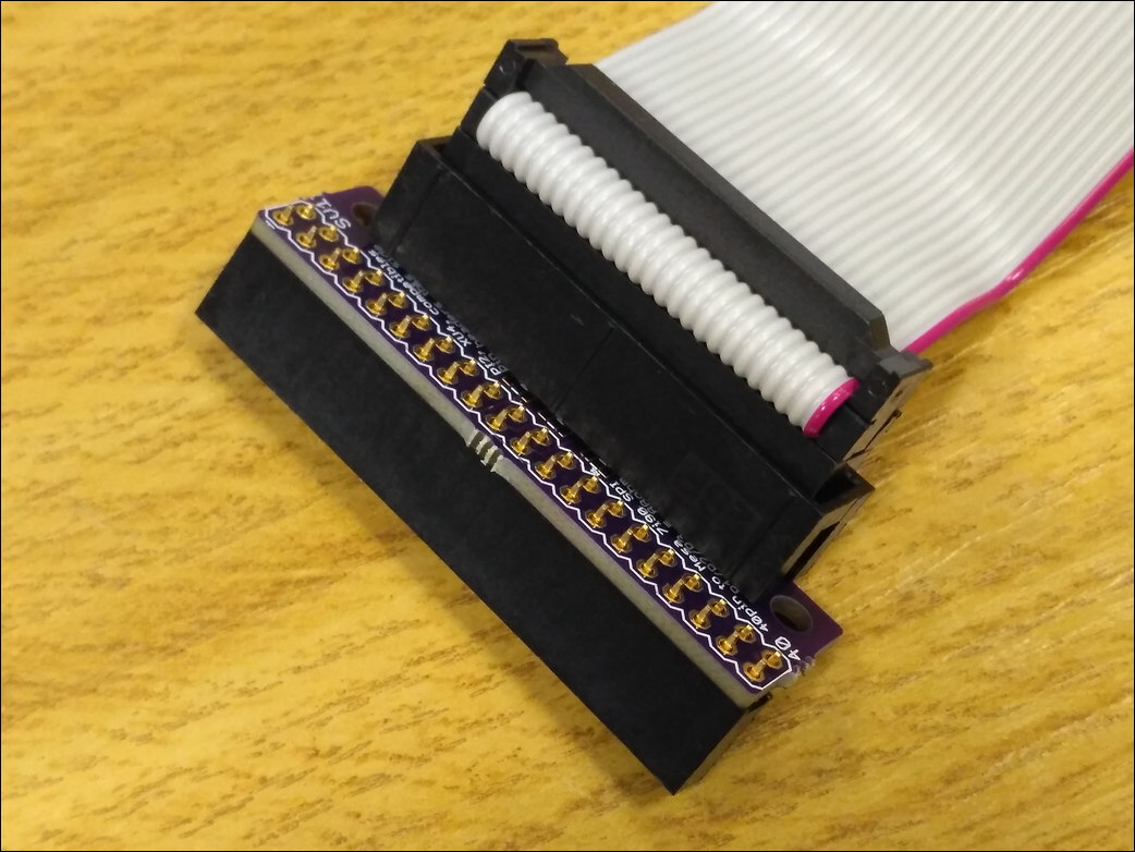

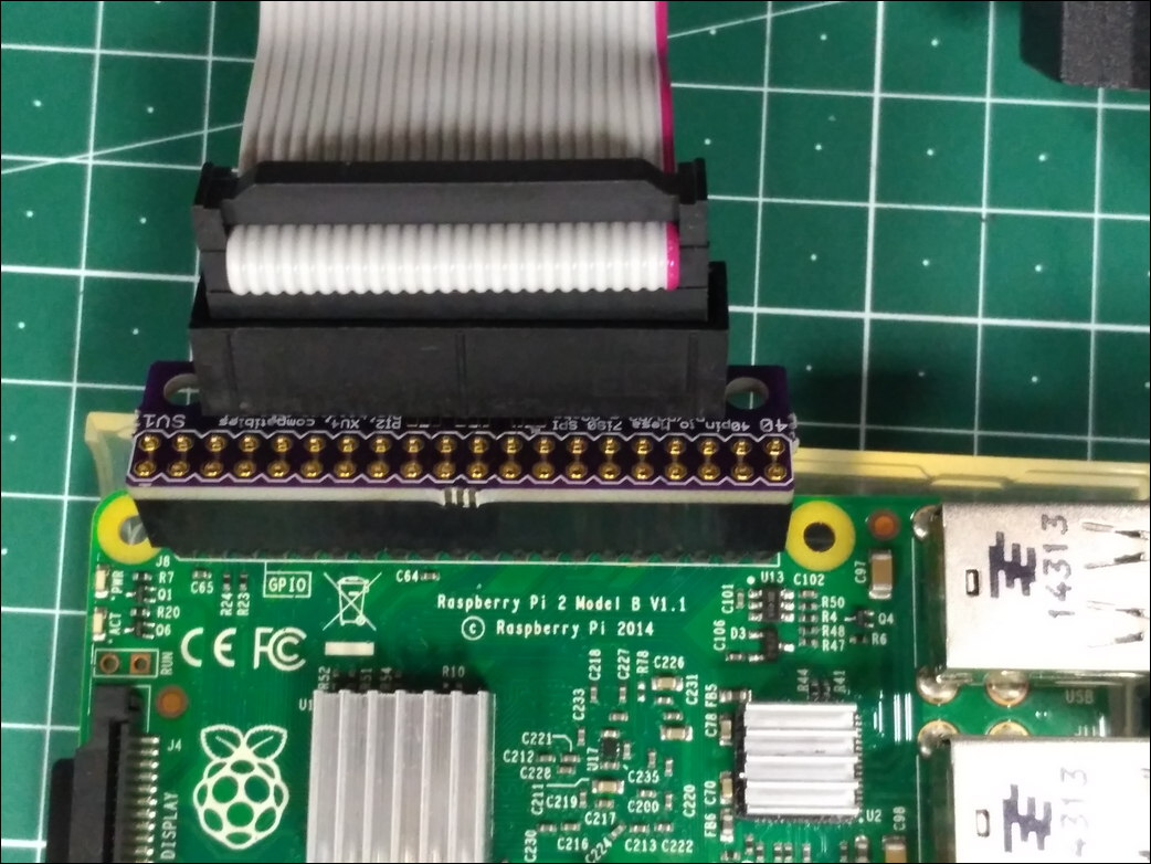

Hello,
I think I should ask here about jepler's Raspberry Pi adapter oshpark.com/shared_projects/bZNakuZs
I'd never ordered anything from oshpark before, so getting the boards was a nice experience.
Now I'm ready to solder, just need to make sure I do it correct.
Please check the pics

Well I found well hidden "1" near 26pin connector and soldered the adapter correctly.
The board seems to work with Pi 2!
