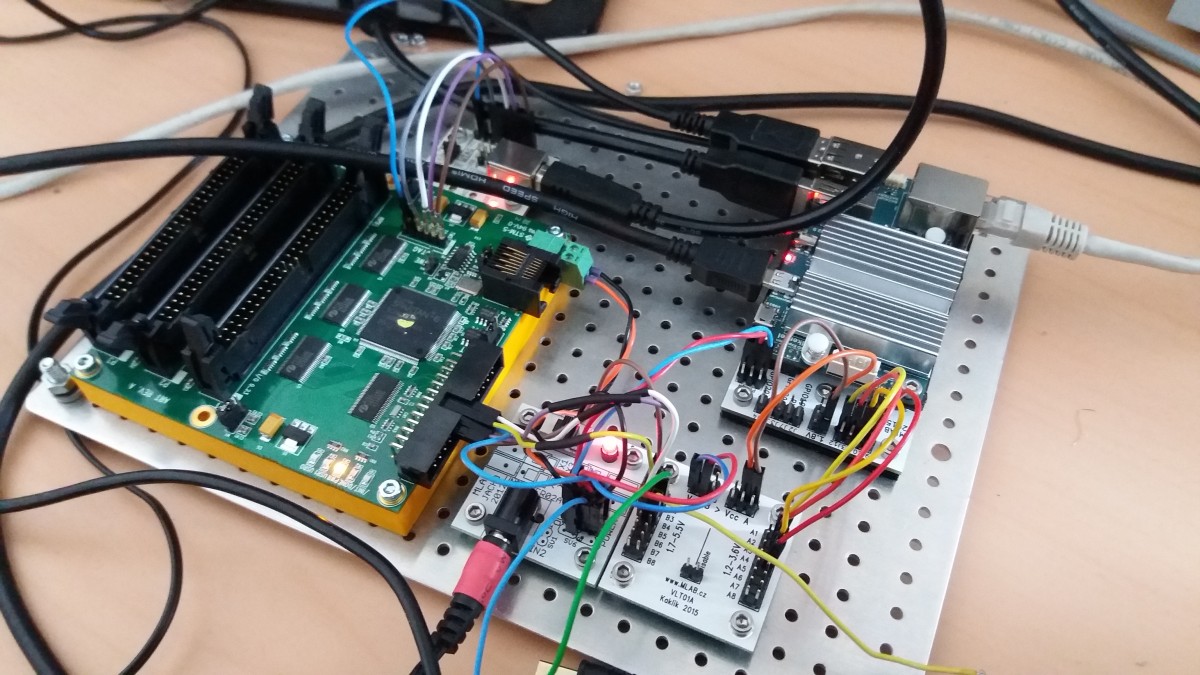

by kaklik
Replied by kaklik on topic Mesa 7i90 in SPI mode
I have the first working 7i90 SPI setup. I have used the ODROID-U3 and VLT01A - MLAB voltage translator for adapt 7i90 to the ODROID's logic.
The 27 Ohm damping serial resistors are on the 7i90 translator' side covered by heat-shrink tube.
halrun
halcmd: loadrt hostmot2
Note: Using POSIX non-realtime
halcmd: loadrt hm2_spi spidev_path="/dev/spidev1.0" spidev_rate=500
probing device /dev/spidev1.0 with rate 500000 Hz
hm2/hm2_7i90.0: 72 I/O Pins used:

Great! As far as the C1 is concerned, if you find a solution within linuxcnc that doesn't harm functionality on the U3, please open a pull request on github.

Uncertain whether to open a new topic, different board but SPI integration challenge.
I am working on integration with RPi3. I tried the hm2_rpspi option without success. I created a new pinout for dual MX4660 configuration and first verified the new .bit file with an EPP image. Loaded the SPI image and discovered mesaflash didn't support the RPi. The challenge is the RPi spidev driver only supports 8-bit word transfers. Long story short I added code to recognize the SPI 32-bit word set failure, fallback to 8-bit transfers and do the necessary byte reordering. Good news is I have a functioning mesaflash utility (at least for readhmid).
I then ported the mesaflash logic to hm2_spi.c. Some success but consistent failure after the board is discovered. Just looking for guidance as to what I missed.
I tracked the error message down into tram.c and found the source of the trouble is the hm2->llio->send_queued_writes(hm2->llio) call from hm2_finish_write() ends up invoking hm2_spi.c::do_pending() with (nbuf == 0) so we get an immediate return 0 and the failure message.
Thank you, Joe
Here's the console output capturing stdin & stderr:
Thank you, Joe
