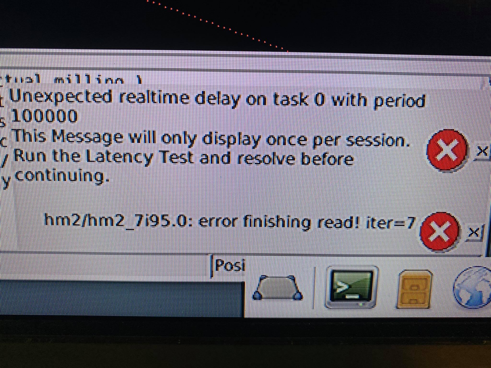

I tried to run the cnc for the first time, sadly enough a error shows up when booting the cnc.
The jitter period for my system was around 27000, i changed this value to see if the error would be solved.
How can i troubleshoot this kind of errors?
Attached you can find my ini and hal file.
Thanks to everyone for the support!
EDIT: moving the jitter period up to 1000000 solved the issue.

28 Jul 2020 21:36 #176287
Replied by PCW on topic Mesa 7i95
The stepgen PID's P term gets set based on the servo thread rate. I think pncconf doesn't re-
adjust this if you change it again so its probably too high, so if you have a 1000000 ns servo
thread (1ms) you should set all P terms in the .ini file to 1000

28 Jul 2020 21:54 - 28 Jul 2020 21:58 #176289
A 1000,000 ns (1 ms) servo-thread period is standard
A 100,000 ns (100 us) servo-thread is going to be too fast for most hardware
I would not use pncconf again once you have the basics setup
To invert the stepgen direction, you can for example:
setp hm2_7i95.0.stepgen.00.direction.invert_output true
