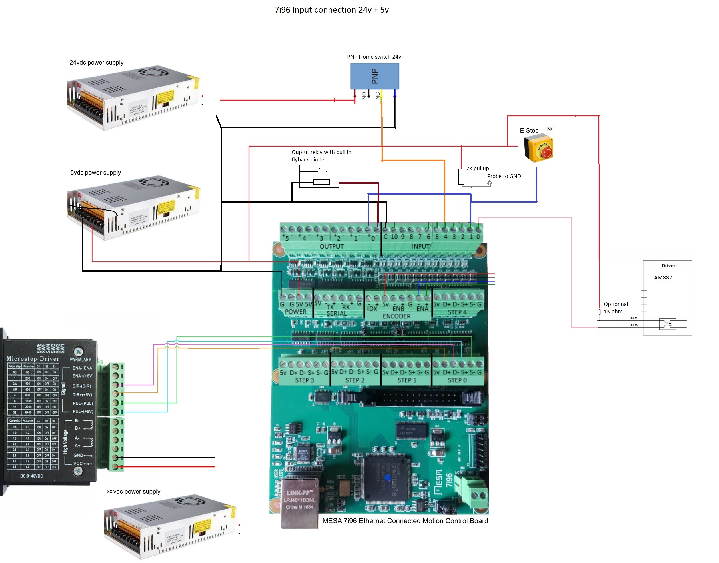

08 Mar 2020 14:56 - 08 Mar 2020 23:32 #159472
by alkabal
Replied by alkabal on topic 7i76e and opto ancoder TCST2103
Last edit: 08 Mar 2020 23:32 by alkabal.

08 Mar 2020 15:36 #159477
Replied by PCW on topic 7i76e and opto ancoder TCST2103
That looks correct
You don't really need a resistor on the +24 to the drives alarm output, but
a 1K or 2K resistor there would prevent damage to the drive if you accidentally
shorted input 0 to ground
