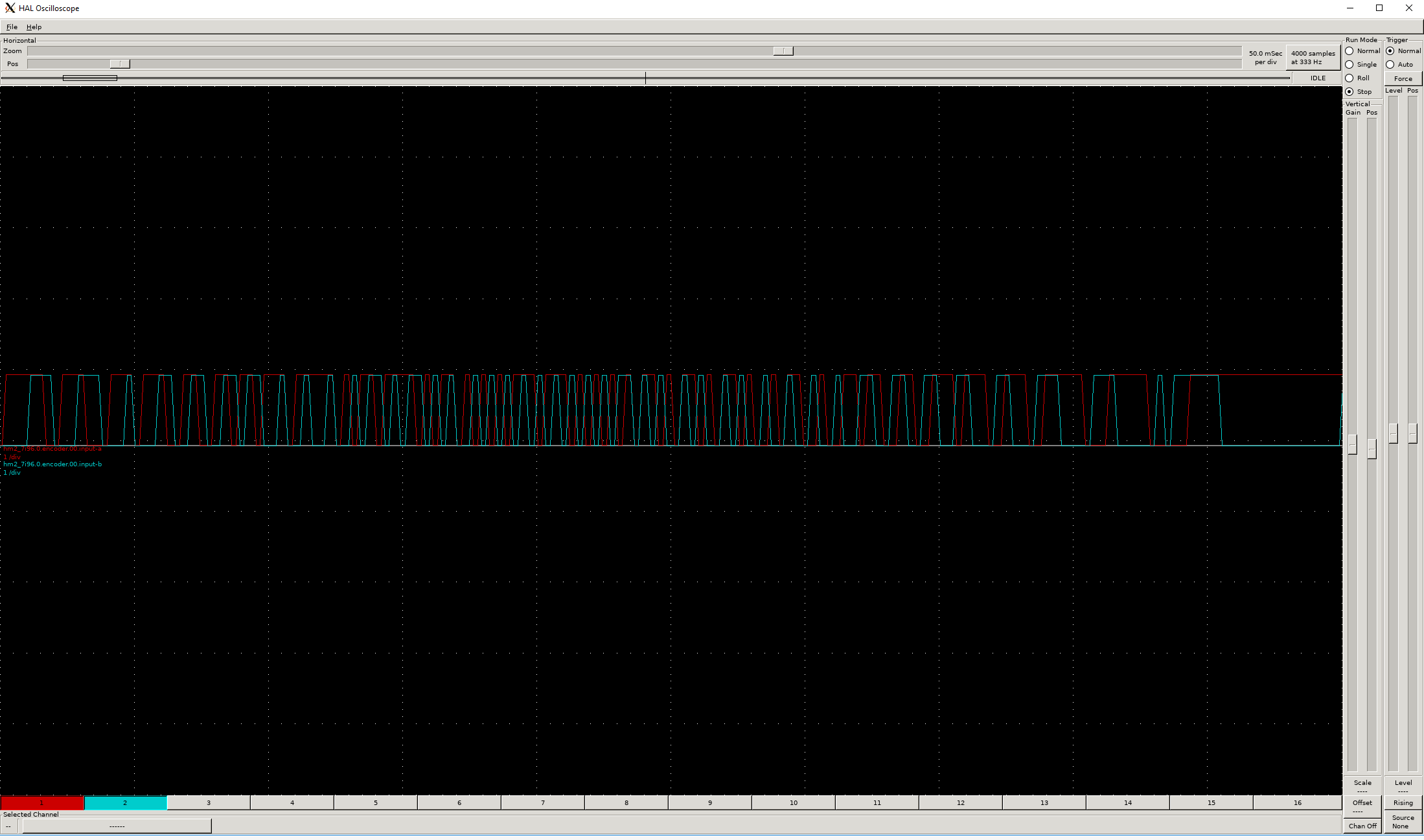

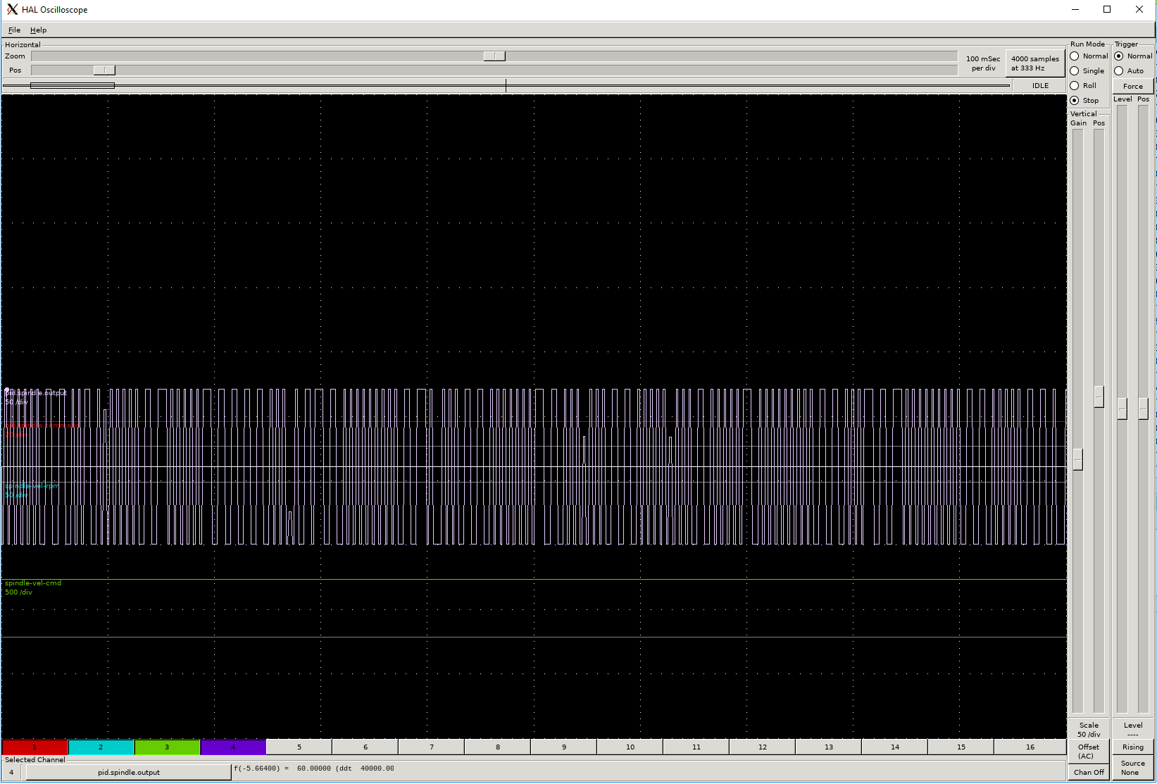

10 Mar 2020 10:31 - 10 Mar 2020 10:40 #159639
by alkabal
Replied by alkabal on topic 7i76e and opto ancoder TCST2103
Hi
Another day another problem
Now with encoder that display very unstable speed (without pid), the spindle seem to be stable.
Quadrature with filter = 1
Quadrature with filter = 0
Counter mode with filter = 1
Counter mode with filter = 0

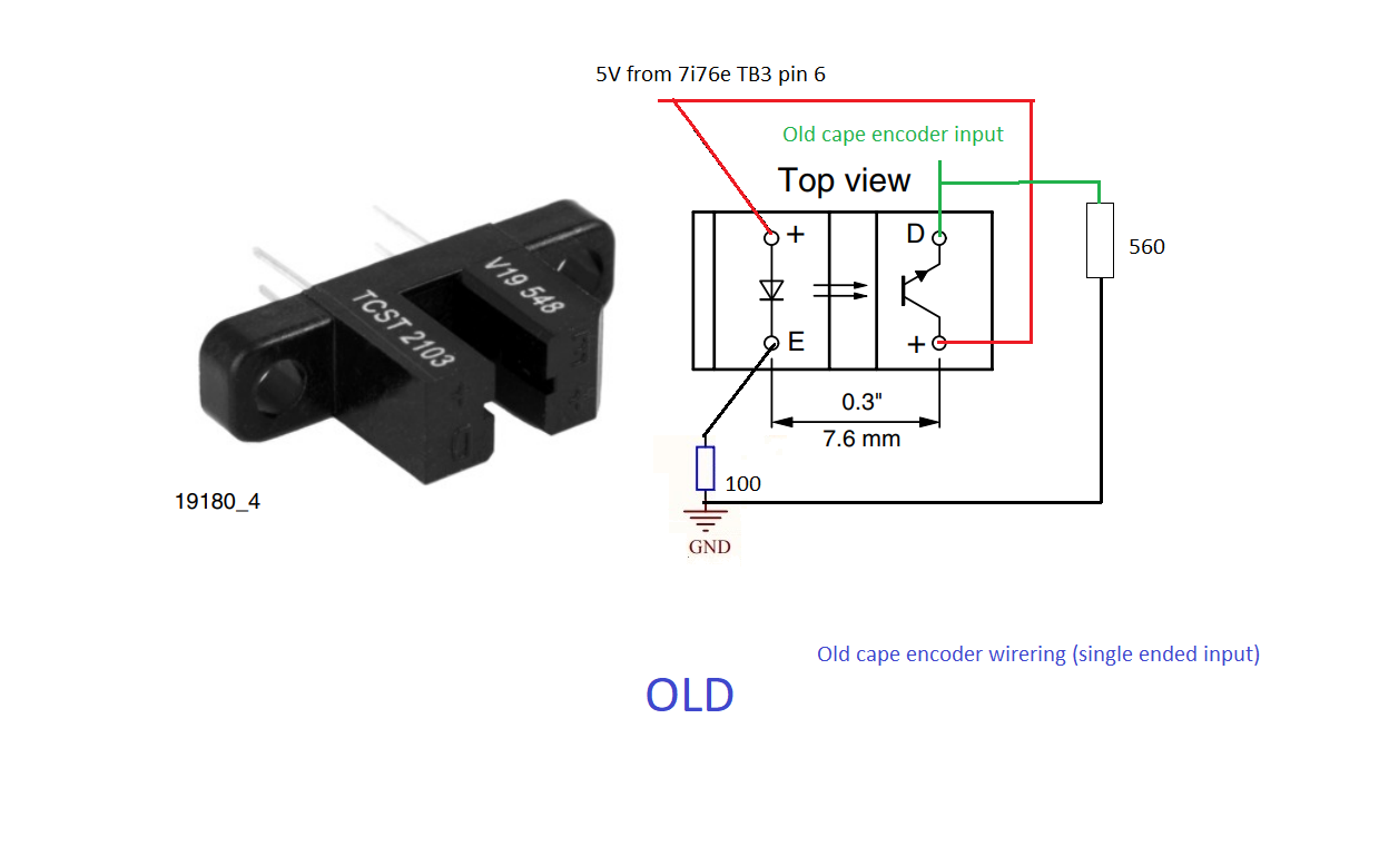

With my oldest board (BBB + furaday cape encoder managed by si8640bc and PRU encoder) i does not have this problem.
(with my opto tcst2103 this cape need pull down 560ohm from encoder input A/B/I)
Did you think this is some electrical noise or maybe not enough precisely mounted encoder A/B ?

- Posts: 18116
- Thank you received: 5335
10 Mar 2020 13:49 #159655
Replied by PCW on topic 7i76e and opto ancoder TCST2103
It might be electrical noise issue, the last plot seems to have a periodic error that may
be a wheel or quadrature issue.
Since this is a low resolution encoder, lowering the encoder input bandwidth will help
if this is an electrical noise issue.
One way to do this is enable the encoder filter and lower the sampling rate to say
500 KHz:
setp hm2_7i96.0.encoder.sample-frequency 500000
You can check for wheel or quadrature errors by slowly rotating the spindle and
plotting the A and B signals:
hm2_7i96.0.encoder.00.input-a
hm2_7i96.0.encoder.00.input-b
In halscope. These signals will also reflect the filtered encoder inputs so can be checked for noise

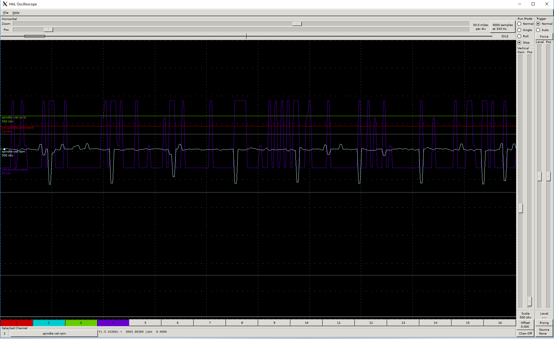

10 Mar 2020 15:52 - 10 Mar 2020 16:05 #159663
by alkabal
Last edit: 10 Mar 2020 16:05 by alkabal.
- Posts: 18116
10 Mar 2020 16:12 #159667
Did lowering the sample frequency fix the near 0 velocity spikes in the velocity?
If not, that suggests a quadrature error
Note that you should only run at say 30 RPM max and 1 KHz sample rate
otherwise you have a data rate much faster than the sample rate so relatively
meaningless data
meaningless data

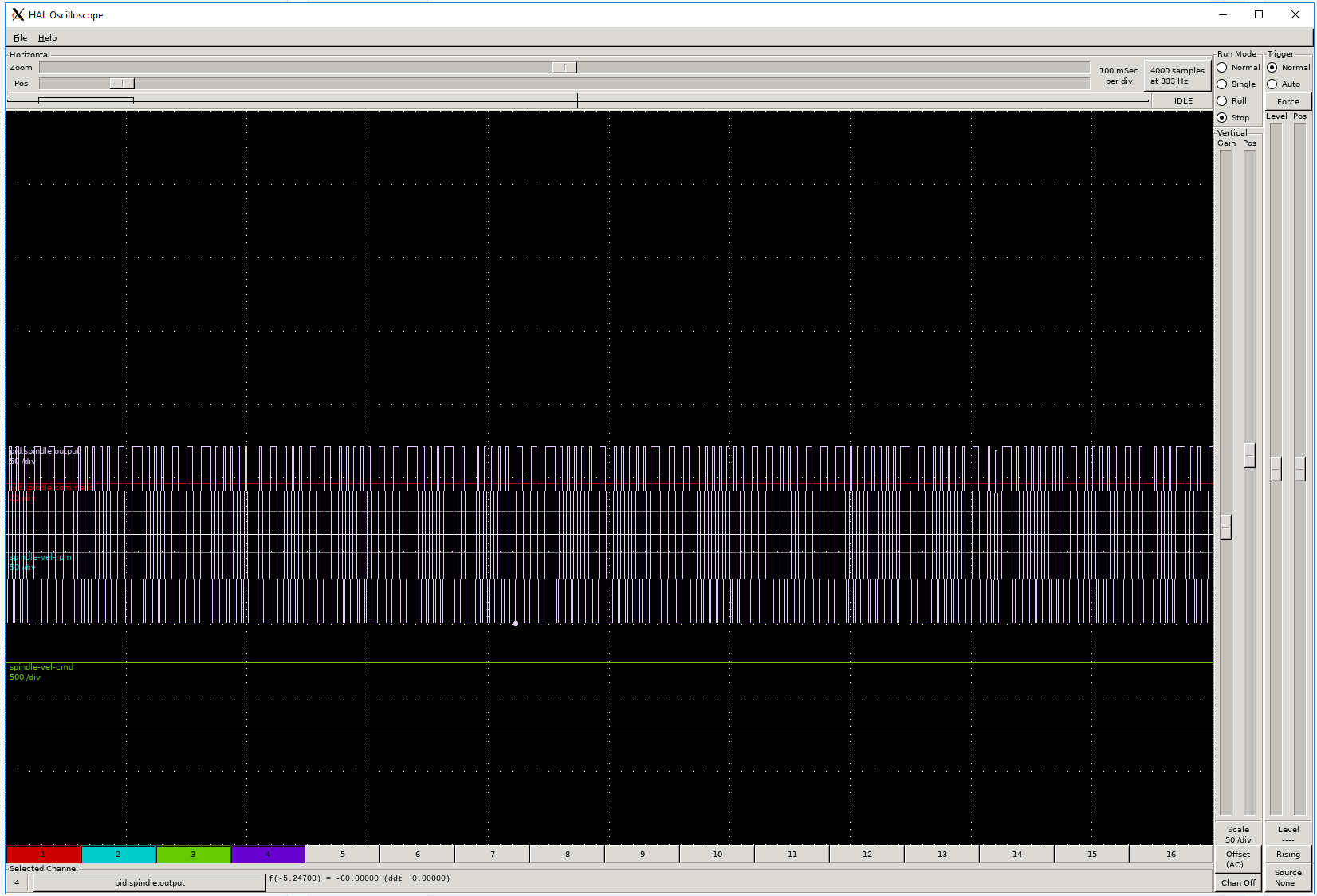

10 Mar 2020 16:23 - 10 Mar 2020 17:10 #159669
by alkabal
For spike i'm unsure for now, need more test but i think not fully better
With counter mode this is without quadrature and i see also some spike
edit : i see something strange the encoder.input-index is allways = 1, i suspect this is reverted
check with multimeter :
aligned to the drill = 0v
aligned to undrilled = 5v
connected like the NEW schematics is according to the result, but maybee it is needed to invert something ?

10 Mar 2020 17:53 #159677
One change is that you had a 560 Ohm load before and now have a 2000 Ohm load
This may have affected the quadrature symmetry. You may be able to adjust this by lowering the LED current.
Note that you cannot actually see the quadrature signals accurately in halscope unless
you rotate the spindle very slowly
BTW you should not use any "D" term in a velocity control PID loop, just FF0 P and I
