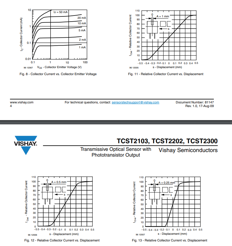

I would use the lowpassed version for spindle-at-speed

Really a BIG BIG thanks to PCW and andypugh !
IMO all work like a charm now with the help of lowpass
i have at the end add pid.spindle.feedback to lowpass because in my brain the noise is electric noise and not unstable velocity : i'm not really sure if this is a good idea but it seems to be ok. (maybee need to do the same for spindle.0.speed-in)
PID setting i'm not expert but i think is ok.
Really the 7i83 is near the real value without any pid, with some difficulty at start but i'm very very happy to Mesa product and community support !
Now i think is time to return happily to orient and other stuff (oh i forgot the problem with index pin...)
