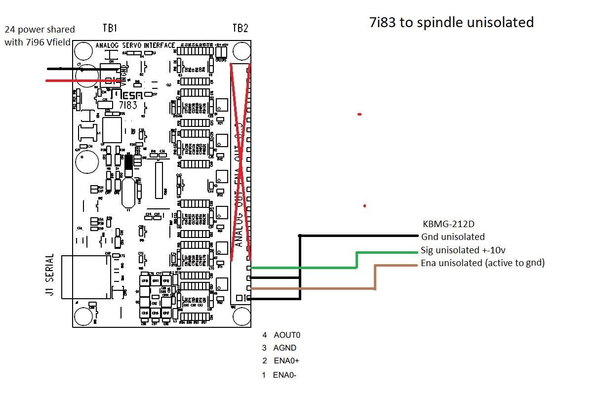

Hi
For now i haven't connected the 7i83 i'm a little afraid but i think the good schematic is the first one for keep spindle controller isolation.

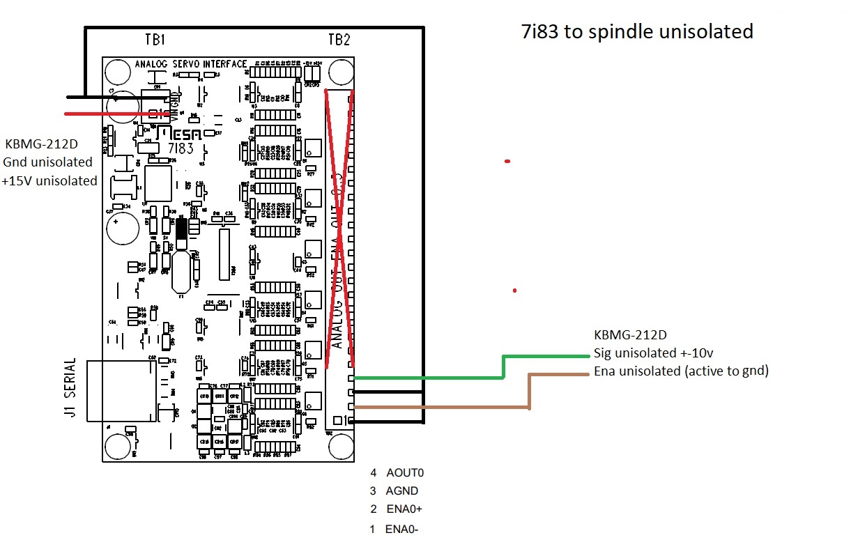

I have Spindle drive connected like the schematics.
PID bypassed for test.
Spindle drive set to 10v for sig input.
I check voltage spindle stoped
Spindle en = 15v
Spindle +15 = 15v
Spindle sig = 0v
Try to start spindle and test rpm
Spindle en = 0.6v
Spindle +15 = 15v
Spindle sig change from 0 to +10 and from 0 to -10 correctly regarding to the rpm asked
But the spindle does not move
adding a switch directly from Spindle en to com change nothing
Test with original potentiometer work fine.
I don't understand it seem to be ok regarding to value but does not work ???
when spindle are activated field voltage move constantly from 12.2 to 14

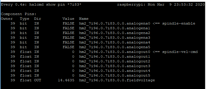

At start :
Spindle en = 15v
Spindle +15 = 15v
Spindle sig = 0v
Spindle en = 0.6v
Spindle +15 = 15v
At start :
hm2_eth: 192.168.1.121: Hardware address: 00:60:1b:16:00:e2
hm2_eth: discovered 7I96
hm2/hm2_7i96.0: Low Level init 0.15
hm2/hm2_7i96.0: Smart Serial Firmware Version 43
Board hm2_7i96.0.7i83.0.0 Hardware Mode 0 = standard
Board hm2_7i96.0.7i83.0.0 Software Mode 0 = analogout_enables
hm2/hm2_7i96.0: 51 I/O Pins used:Attachments:
Last edit: 09 Mar 2020 23:33 by alkabal.
- Posts: 18116
- Thank you received: 5335
09 Mar 2020 23:48 #159611
Replied by PCW on topic 7i76e and opto ancoder TCST2103
Not sure but one guess is that the 7I83 draws too much power from the drives 15V and needs a separate floating supply
- alkabal
- Posts: 476
- Thank you received: 52
10 Mar 2020 00:01 #159612
by alkabal
Replied by alkabal on topic 7i76e and opto ancoder TCST2103
19v power supply from notebook is ok ?
need connecting together supply gnd to Spindler drive com ?
- Posts: 18116
10 Mar 2020 00:04 #159613
I would check to make sure the laptop PS is isolated
