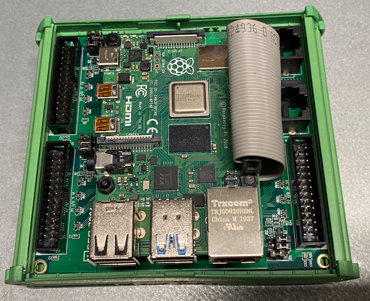

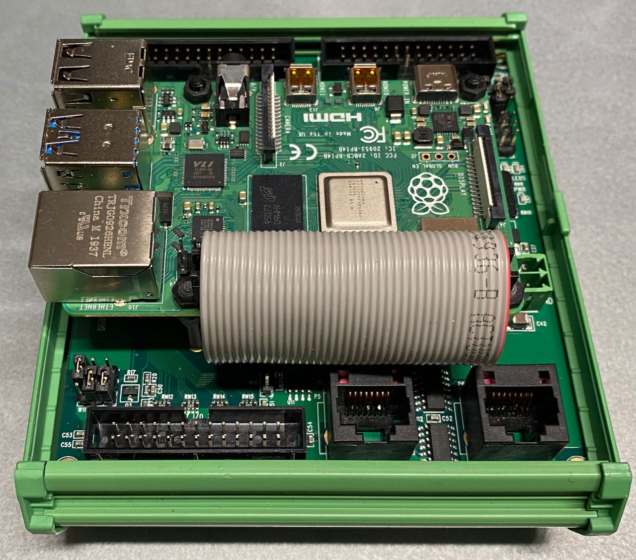

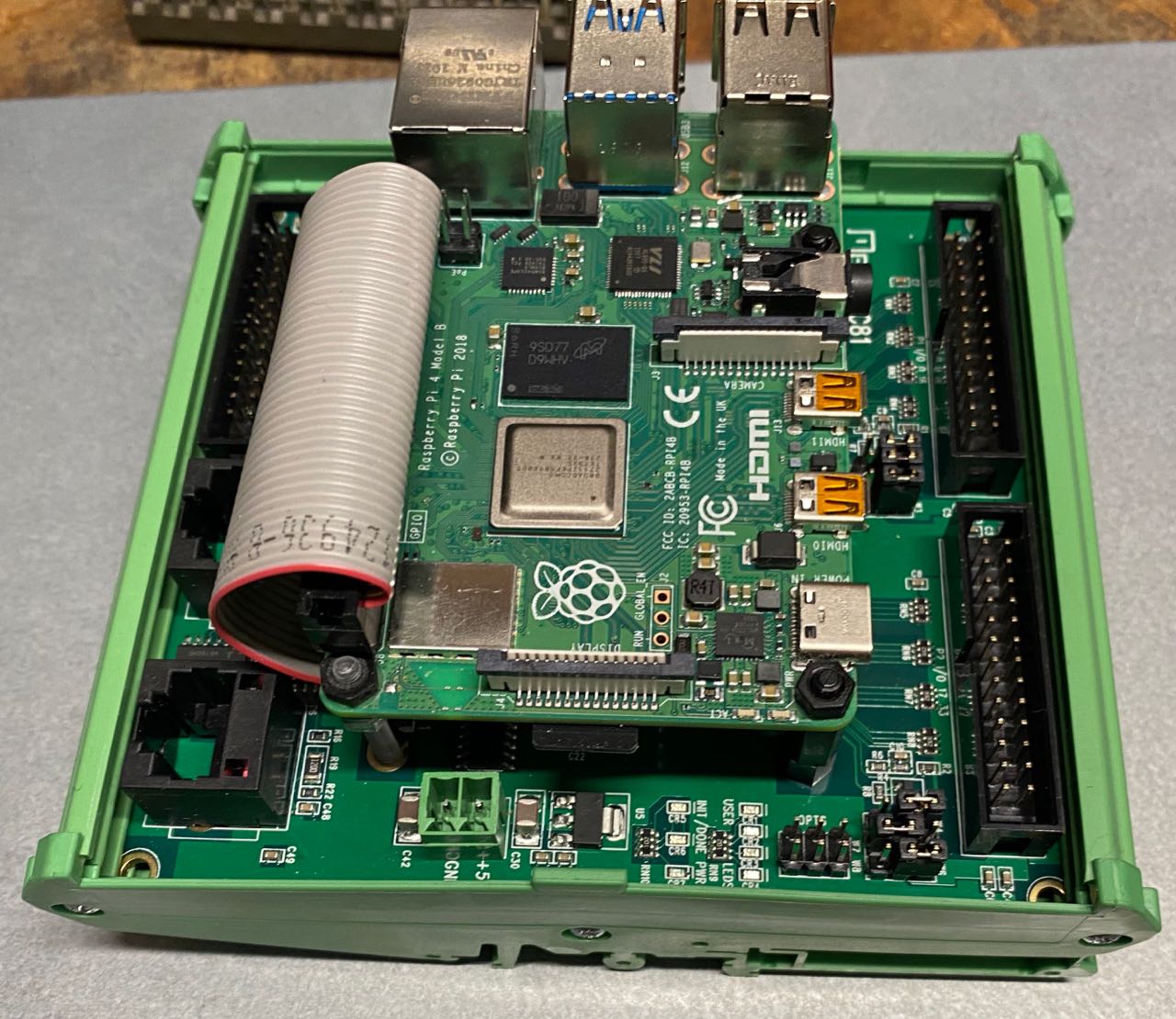

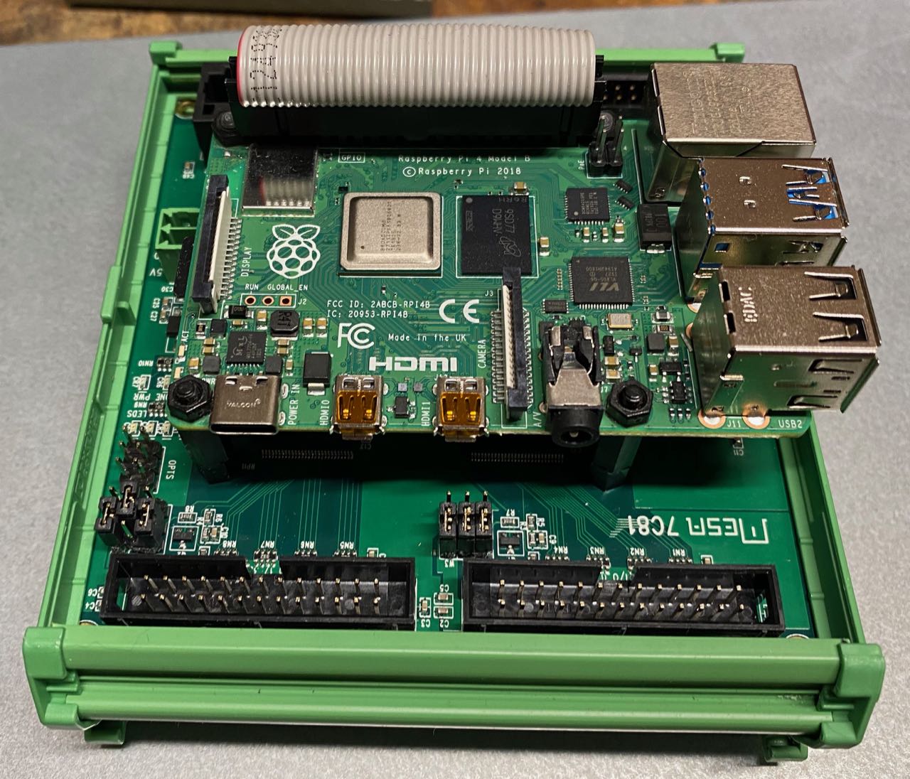

As a newcomer to LinuxCNC and Mesa products I struggled to get may head around the 7C81 interface card and how it all fits together. Maybe the images below will help the someone to get a clearer understanding of the 7C81 and how it all fist together.
The images show a Raspberry Pi 4 mounted on to 7C81, a home made 40pin jumper cable and a DIN rail mount made up from the following Phoenix Contact products purchased from RS parts:
804-7549
804-7546
804-7420
I will provide more photos once I have 7C81 + 7i85S mounted in the switchboard.
804-7549
804-7546
804-7420

1) There is sufficient space for a PoE hat, but I'm not sure that it's needed as the 40pin jumper provides the Pi with 5V power from the 7C81. The 3rd photo shows the 5V connector on the 7C81 which has good current carrying capacity and is more than adequate to power the Pi and the 7C81 + IO modules. I measured power consumption of my setup (7C81+7i85S) at around 1.2A with peaks of 1.5A, but that's without encoders and only one stepper drive connected.
I'm not sure that powering the 7C81 from the Pi via PoE hat is a good option, particularly if the 7C81 is jumpered to provide power to a few other IO modules, as all current for the 7C81+Anything IO modules would have to go through the 40pin jumper.

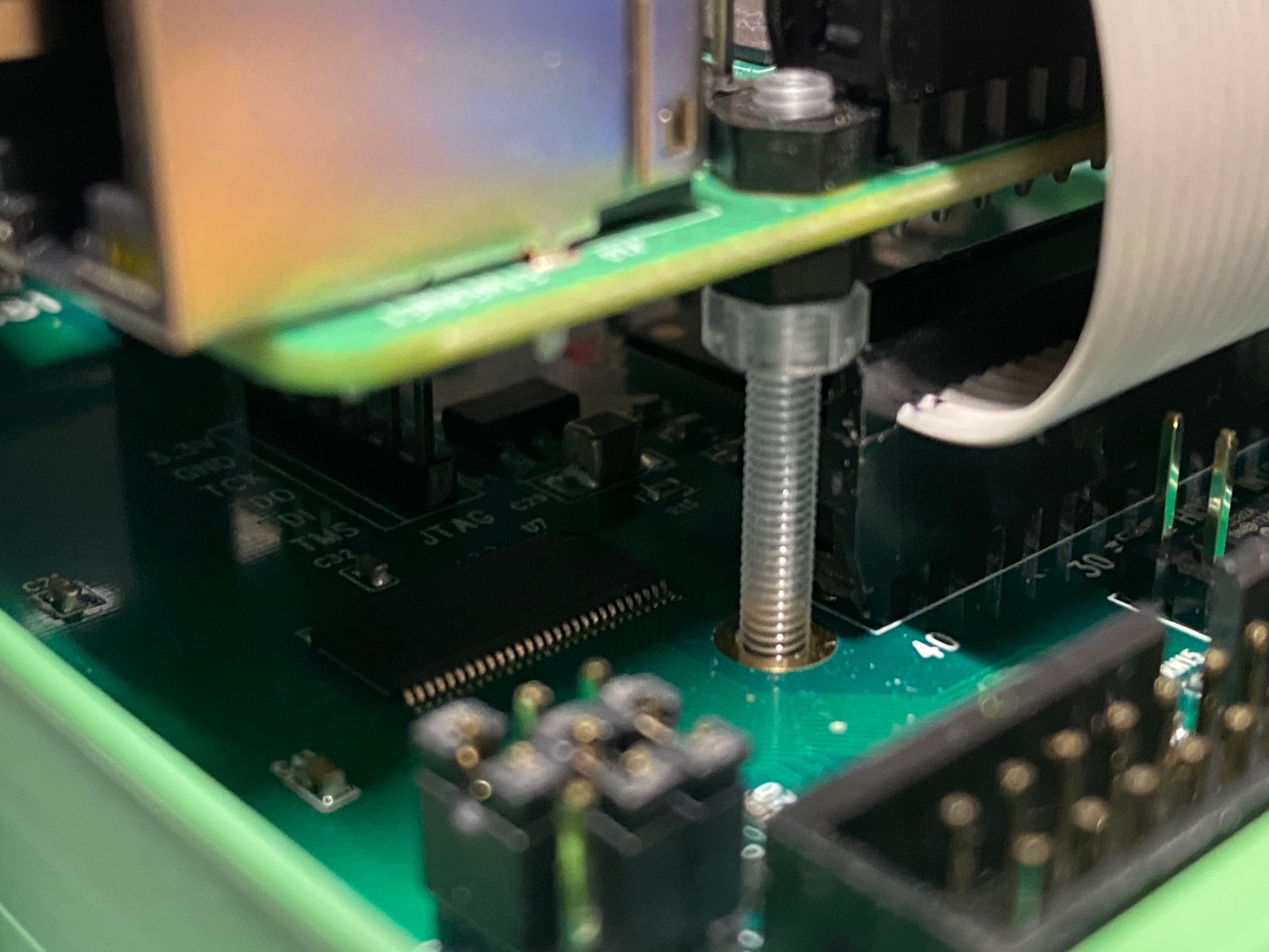

that looks pretty clean in the din rain mount. can you post a more in detail shot of your stand offs on the ribbon cable side? I have been curious as to how others do theirs

Ah yes, that part is bit tricky. It's actually not a full stand off, just a plastic M3 bolt with nuts, took a little bit of effort to get that arrangement into position. It's now installed on a gear tray, so no longer that easy to see .... I will try and take some photos for you tonight.

The bolt coming up from the underside is tightened with the clear nut against the top of the 40 pin connector, a second [black] nut locks the clear nut into place and provides the correct height to match up with the standoffs on the other side. It tends to want to slide off the side of the connector until the pi keeps the two bolts at the correct spacing.

Here is the detail you requested:.... can you post a more in detail shot of your stand offs on the ribbon cable side?
