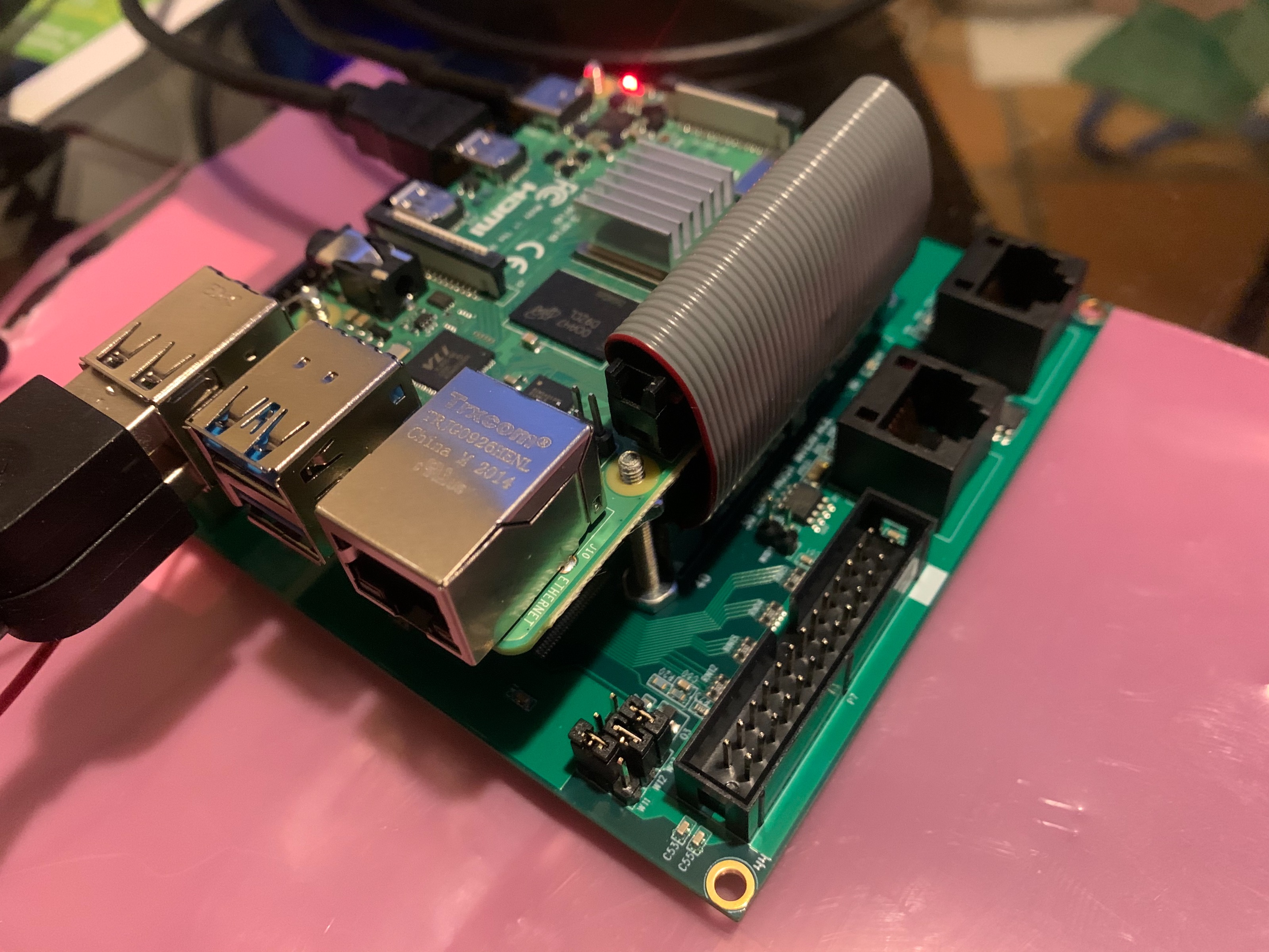

I should have asked what is /dev/spidev0.0?
Thanks again
Thanks again

Replied by JohnG on topic Raspberry Pi 4 with Mesa 7c81
Linuxcnc 2.8.1
Unsure what version of Mesaflash and not sure how to tell. It does list the 7c81 in the help file (which I know is only recently added...)
- Posts: 18093
- Thank you received: 5325
13 Jan 2021 06:35 #195186
Replied by PCW on topic Raspberry Pi 4 with Mesa 7c81
That's the kernel spi device (for access to the SPI hardware via the kernel driver)
Do you have SPI enabled in the RPI?
I will reboot
Cable is less than 2”
SPI is disabled in raspi_config as recommended here:
linuxcnc.org/docs/2.8/html/man/man9/hm2_rpspi.9.html
I did manually toggle leds on and off using halcmd. I assume that was over spi??
Mesaflash needs the device driver enabled
I have in enabled in my config, I dont see that that's
actually an issue unless you are running some application
that accesses SPI (other than LinuxCNC)
That did it! Can’t thank you enough.
