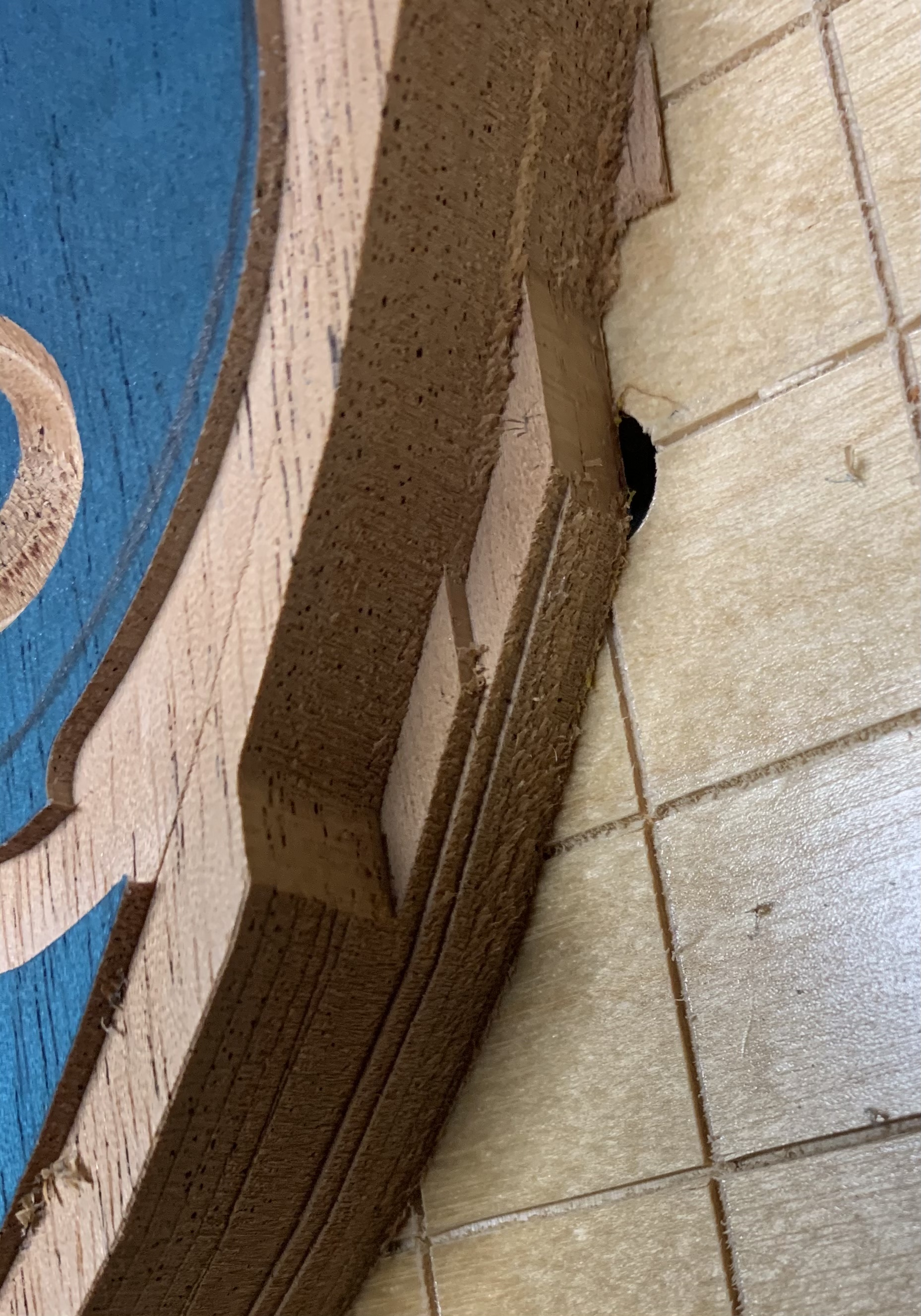

The machine does not lose position.
It is not exactly repeatable in that it does not do the same thing each time but it does do something at the same location of the pass if you are making multiple passes to say cut a part out. I’ll try to get an example picture

My first thoughts are that the 7C81 is too "dumb" to do this.
I assume that the backplot does not show this?
There are many possibilities, including mechanical. Check that all your couplings are tight. Though it doesn't feel like a max-force point or a max-speed (backlash) point.

Definitely not mechanical. It is obvious when watching it that it is commanded motion...
You can see in this photo what it has done after multiple passes. Not exactly in the same spot but same type of error.

When you say it does not lose position, are you saying
the tool returns to the correct path after the deviation?
Maybe a simpler test code would help diagnose the issue
What are your min_ferror and ferror settings?
large values of these can mask steggen setup errors
Posting your hal and ini files would also help

And correct backplot does not show it. Also verified on standalone gcode simulator

I wrote a simple gcode program to test. It was a rectangule with rounded corners I used g02 for the curves. Again, perfect plot on screen but the issue you saw in the first photo labeled “A”

I agree that it looks like a command motion (even on the part) but if it does not show up on the backplot then I _think_ that can only be backlash comp (bad backlash comp).

I would agree except that I created the rectangle specifically to make the motors run in only one direction throughout the curve (x only moving in the negative direction and y only moving in the positive direction) to eliminate backlash as the culprit. I really do not believe it is backlash or backlash comp (which is set to zero anyway)
