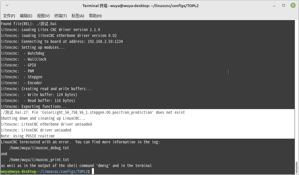

27 Jan 2023 07:47 #262986
by TOLP2
To solve, try to limit your board name to 16 characters or less.
Replied by TOLP2 on topic ColorCNC Colorlight 5A-75E/5A-75B as FPGA controller board
The total length of any pin name cannot exceed 80 characters in LinuxCNC. This name is longer and therefore gets truncated, therefore the original (too long) name does not exists.Now there is a new problem
The following user(s) said Thank You: wuyatom
- wuyatom
- Posts: 42
27 Jan 2023 12:22 #262998
by wuyatom
Replied by wuyatom on topic ColorCNC Colorlight 5A-75E/5A-75B as FPGA controller board
Can you send your hal and ini files for my reference

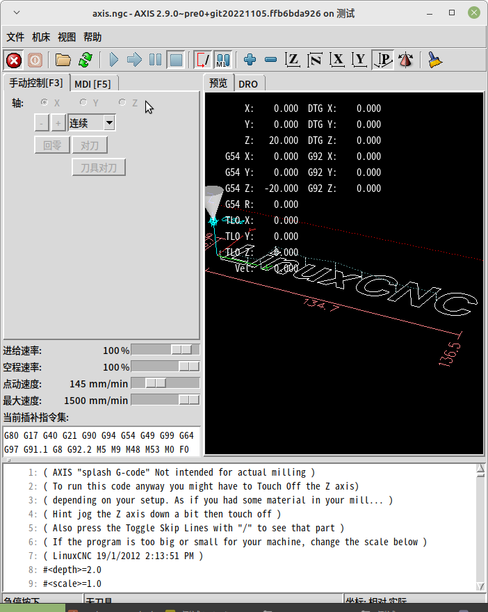

27 Jan 2023 12:26 - 27 Jan 2023 12:28 #263001
by wuyatom
Last edit: 27 Jan 2023 12:28 by wuyatom.
- wuyatom
- Posts: 42
27 Jan 2023 12:30 #263003
by wuyatom

To find out you can open terminal and run "halrun".
then load the two modules with
loadrt litexcnc
loadrt litexcnc_eth config_file="/path/to/config.json"
after successfully loaded type
show pin
which gives you a list of all pins and their names
loadrt litexcnc
show pin

@wuyatom: please clarify what you mean with 'cannot press E-Stop'. Is this in the GUI, or is it a physical button?
In case of the GUI: I cannot help you as you are using Axis and I use GMOCCAPY.
If it is a physical button. In the HAL file you posted I don't see any input defined for the E-stop. If you have an input assigned to the E-Stop and it is still not running, please verify you've modified the buffers. The default buffers are output only!
