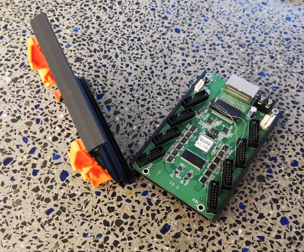

16 Jul 2023 16:57 - 16 Jul 2023 17:00 #275584 by deroj
For those who are interessted, I build a carrier for the 5A-75B board which is compatible to theWeidmueller PF RS 80 system.Order-No.  13244600000.
I attached the link for STL.
www.dropbox.com/s/t3pujahn34qkd9j/Colorlight-5A-75B-PF.stl?dl=0
Last edit: 16 Jul 2023 17:00 by deroj.

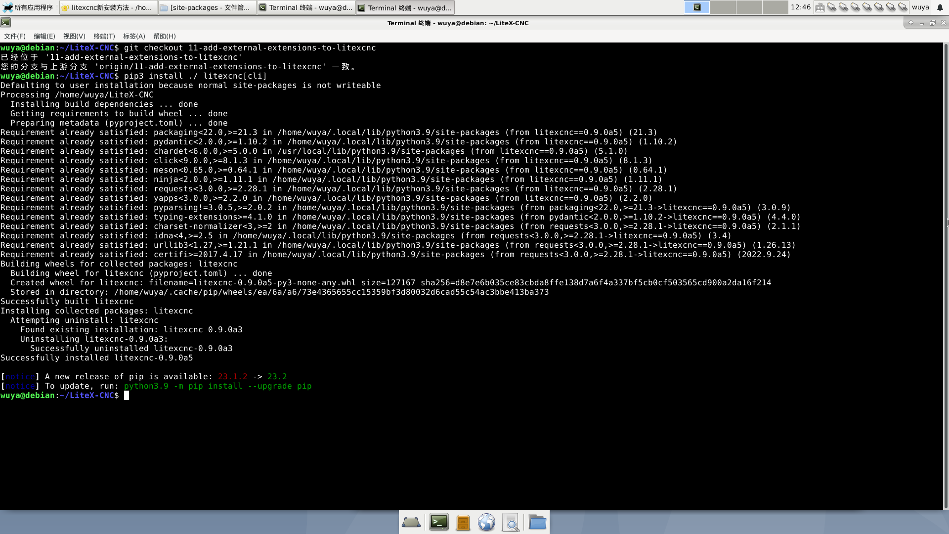

19 Jul 2023 14:13 #275817 by wuyatom
11-add-external-extensions-to-litexcnc How is this branch installed? Are there any detailed steps?

20 Jul 2023 00:18 #275839 by Cant do this anymore bye all
Replied by Cant do this anymore bye all on topic ColorCNC Colorlight 5A-75E/5A-75B as FPGA controller board
git clone github.com/Peter-van-Tol/LiteX-CNC.git
cd LiteX-CNC
git checkout 11-add-external-extensions-to-litexcnc
pip3 install ./ litexcnc[cli]
It is discussed here:
github.com/Peter-van-Tol/LiteX-CNC/issues/15
This the method I use.
Please note take note of the info on this page  for installing\building the driver
github.com/Peter-van-Tol/LiteX-CNC/tree/...compiling-the-driver

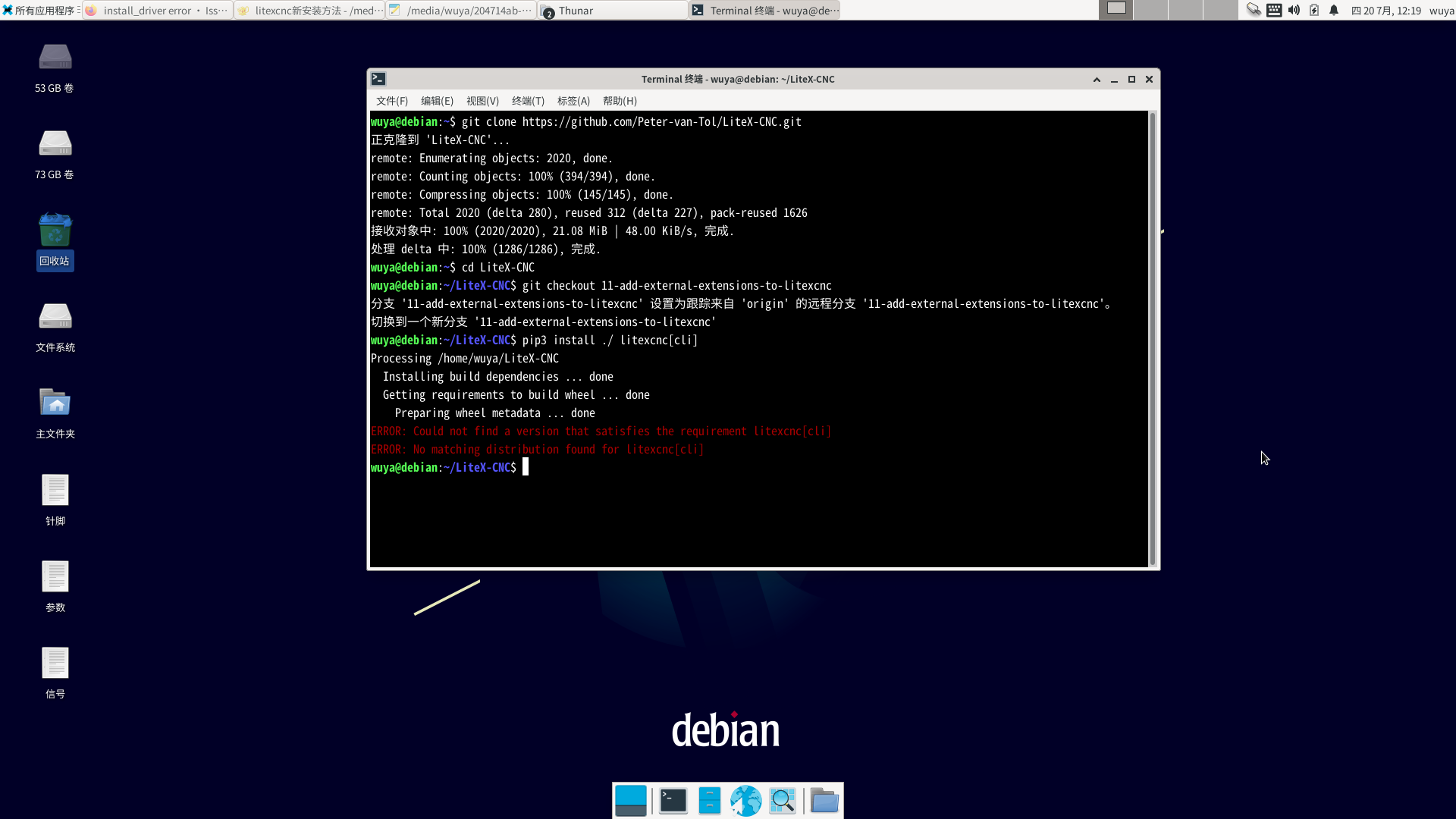

20 Jul 2023 04:25 #275855 by wuyatom
I have uninstalled sudo pip3 install -- extra index url test.pypi.org/simple/ For installations like litexcnc [cli]=0.9.0a5, error messages may still pop up

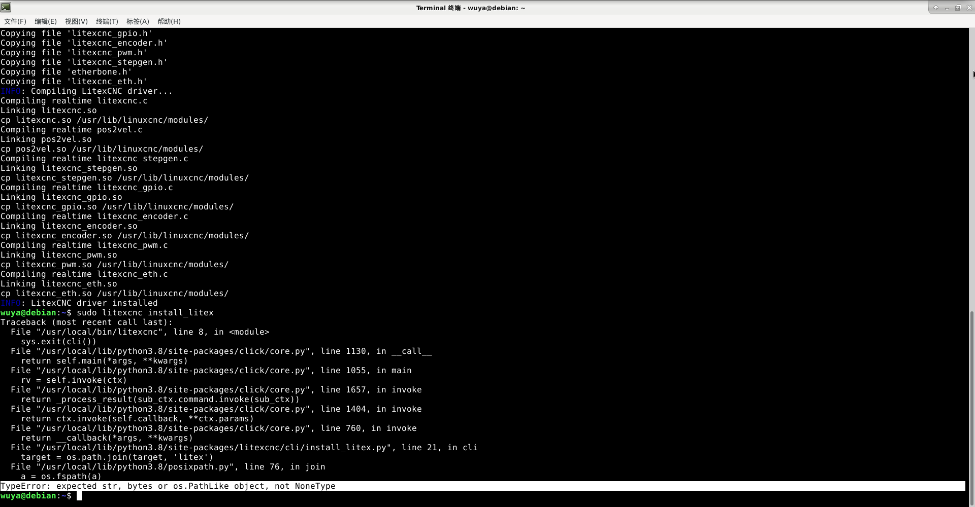

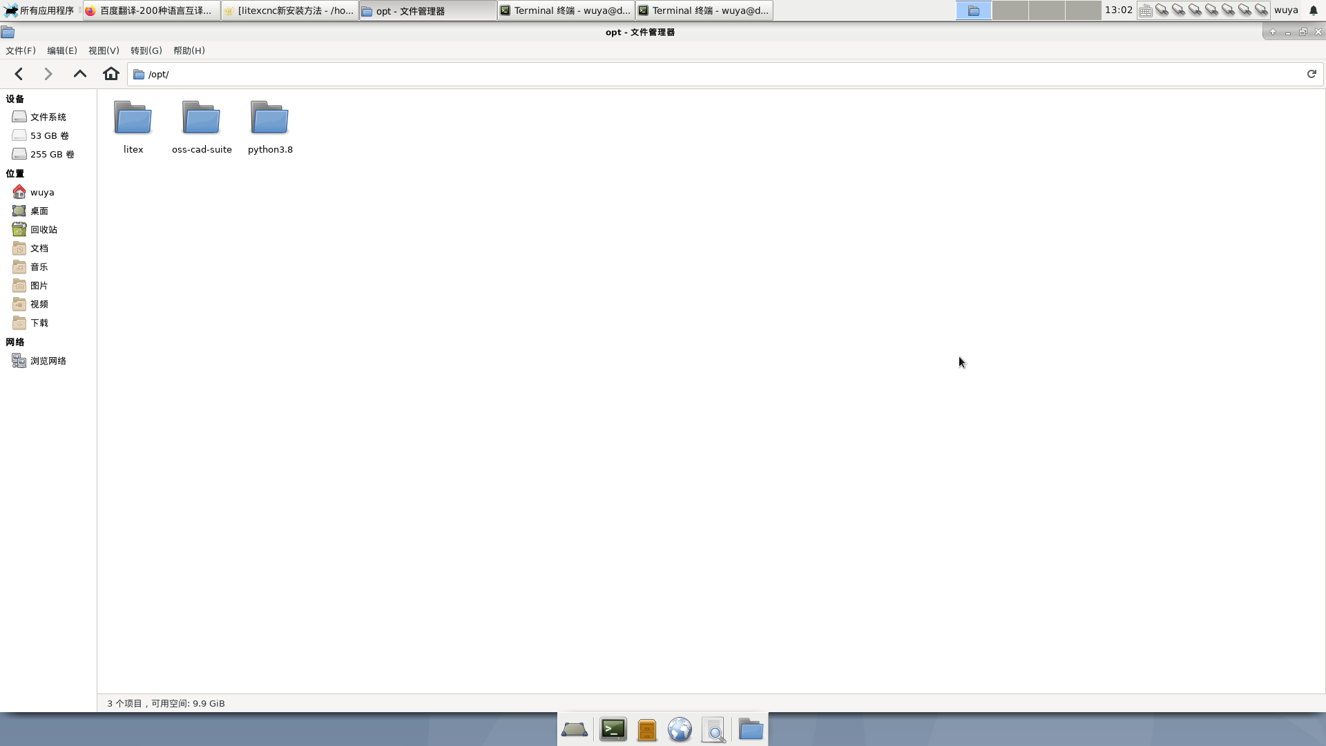

20 Jul 2023 05:06 #275857 by wuyatom
Replacing it with the debian10 litexcnc branch can install it. It was just installed under debian11 and keeps making mistakes,
There was an error installing lite. I used to install lite in the OPT directory and have also compiled firmware. Now, when I switch to the lite CNC of this branch, there is a lite installation error

20 Jul 2023 05:38 - 20 Jul 2023 05:45 #275859 by Cant do this anymore bye all
Try:
pip3 install . litexcnc[cli]
litexcnc install_litex --user
litexcnc install_toolchain --user
I keep to the 11-add-external-extensions-to-litexcnc branch as you don't need to give a path to a config file when loading the driver. This is the branch I've been helping Peter on for installing the driver.
I usually use Bookworm book did notice with an earlier Debian version I had to upgrade pip (or pip3) and setup tools. BTW with Linuxcnc 2.9, if you have done a recent checkout or pull, you no longer need to give a path to the modules directory.
