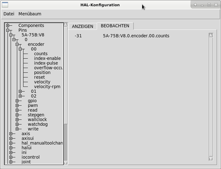

I treid to install 11-add-external... with
poetry install
I could install the driver with
poetry run litexcnc install_driver
before I had to install click and yapps with
poetry run pip3 install click
poetry run pip3 install yapps
But I cannot build the firmware
poetry run litexcnc build_firmware "...json" --build throws
Error: Litex is not installed. Please run 'litexcnc install_litex' first.
But poetry run "litexcnc install_litex --user" throws:
ERROR: Can not perform a '--user' install. User site-packages are not visible in this virtualenv.
So I tried litexcnc install_litex -d "/home/oj/.cache/pypoetry/virtualenvs/litexcnc-nG38Bnph-py3.7"
Then it installed LiteX in the poetry env
But then poetry run litexcnc build_firmware "...json" only opens some kind of "input":
only way to exit is to close the terminal window
EDIT:
Think I got it...
I opened poetry shell
then copied the JSON to the poetry env directory.
After this I run litexcnc build_firmware "/full-path-to-poetry-env-directory/file.json" --build
Second EDIT:
I installed the driver again in this shell with litexcnc install_driver
Did a test with halrun and it worked.
It loads the driver and I can see all the pins.
loadrt litexcnc
loadrt litexcnc_eth connection_string="192.168.178.150" #the documentation says "eth:192.168.178.150" but this didn't work
then I connected a simple rotary encoder and I can see the counts in LinuxCNC

11 Jul 2023 14:09 #275212
by deroj
Replied by deroj on topic ColorCNC Colorlight 5A-75E/5A-75B as FPGA controller board
Hi.
I changed the encoder to have index input.
All I did was edit the config.json -> encoder section
Then flashed the board with firmware, opened LinuxCNC and the encoder works as expected.
I made a small video.
First set encoder.index-enable true.
Then when it detects the index pulse, the counter will be set to zero and index-enable back to false.
www.dropbox.com/s/zg66ako64gm8v3w/VID_20230711_160304.mp4?dl=0
