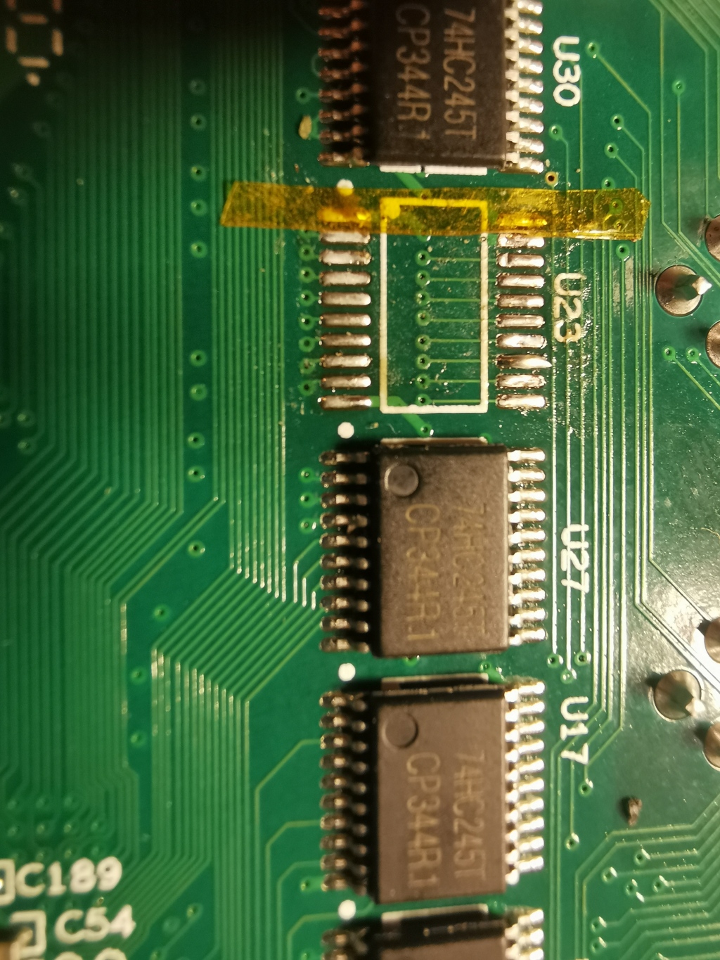

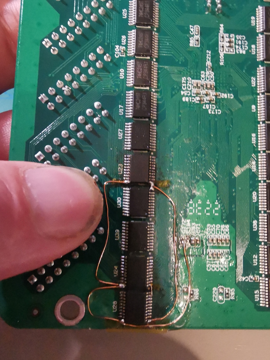

08 May 2023 22:01 #270964 by meister
Transceivers U23,U24,U28 for J1,J2,J3,J4 are changed and the board still works, puhh.
BUT, never ever again ! horrorible !!!
BTW: i covered the 2 pins with kapton tape
