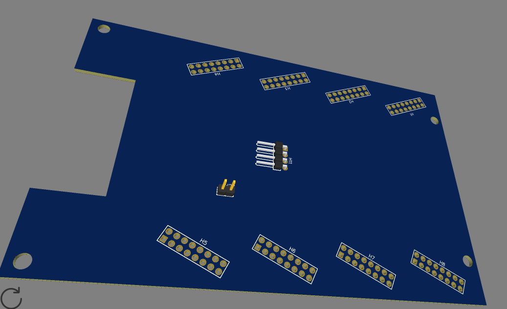

I Also made a PCB Layout which hits perfectly on the 5A75B
You can Import the DXF as a Document (KiCAD, EAGLE, etc.) then you have the exact matching for positioning your headers.
Google Drive:
drive.google.com/file/d/1yBUNk07vlnOByhx.../view?usp=drive_link
Google Drive with Bitfile and JSON:
drive.google.com/drive/folders/1y_3T1eHn...crYeb?usp=drive_link
Google Drive:
