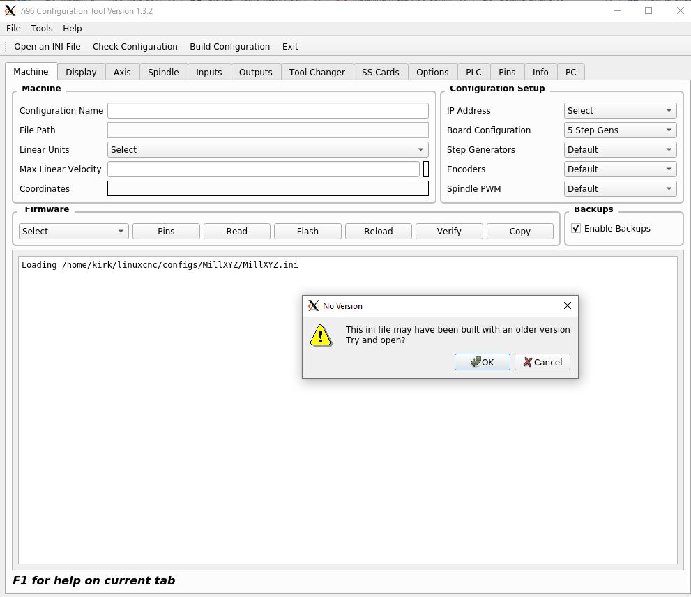

19 Feb 2022 20:26 - 19 Feb 2022 20:28 #235346
by kbec
Replied by kbec on topic Mesa 7i96 with SPINX1 to control spindle speed
I reinstalled my system, then the 7i96 package per the instructions, even though I installed 1.3.4, it reads 1.32
The error I am getting:
File "/usr/lib/python3/dist-packages/lib7i96/loadini.py", line 45, in openini
loadini(parent)
File "/usr/lib/python3/dist-packages/lib7i96/loadini.py", line 148, in loadini
getattr(parent, item[2]).setChecked(eval(config[item[0]][item[1]]))
File "<string>", line 1, in <module>
NameError: name 'NO' is not defined
I am thinking the "NO" is coming from the "No Version" in the popup window and is causing the error. that is my configuration created in pncconf.
loadini(parent)
