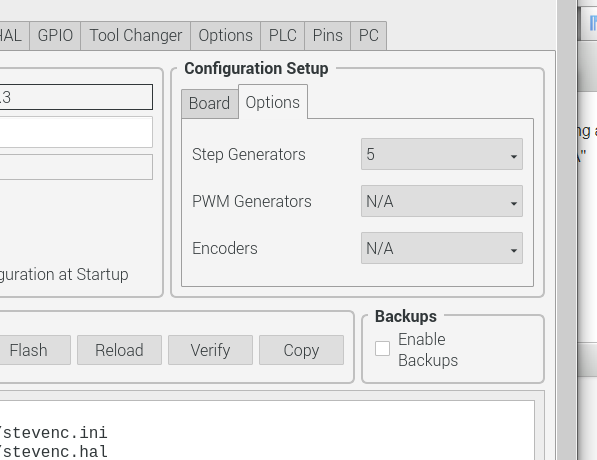

hopefully I'm not thread-jacking. It seems I'm having an identical issue with my configuration (speed indicatior LED not illuminating/no speed response with VFD). I'm using a 7i95 and SPINx1. I've used John's latest config tool to generate the configuration. I've noticed the PWM Generators field is showing as "N/A" is that correct? seems like it should say "1" given I have flashed the 7i95_1pwmd firmware. I wasn't sure what kbec's final hal/ini file ended up looking like so I apologize if the issue I am having is glaringly obvious.
kbec, do you have a successful set of file you can share?

kbec, don’t worry about it, issue was between the keyboard and office chair. Once I gave the spindle an m3 s12000 all was well
