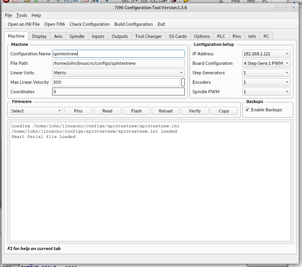

24 Feb 2022 11:29 #235685
by BigJohnT
Replied by BigJohnT on topic Mesa 7i96 with SPINX1 to control spindle speed
Ok, I pushed the fixes but didn't bump the version so just reinstall and test the fixes. I wish I had a 7i96 in stock to test with it sure would speed things up.
JT
JT

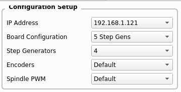

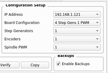

24 Feb 2022 13:49 - 24 Feb 2022 13:52 #235689
by kbec
Replied by kbec on topic Mesa 7i96 with SPINX1 to control spindle speed
Configuration seems better, but still not 100%
As I saved it:
When it loads in:
The quote issue is fixed
still seeing the setp duplicate here(I addressed it manually in the attached hal file):
setp pid.1.error-previous-target true
setp setp hm2_7i96.0.pwmgen.pwm_frequency [SPINDLE]PWM_FREQUENCY
setp hm2_7i96.0.pwmgen.00.scale [SPINDLE]SCALE
I think the issue may be in the pins, I am not sure, but I see the value of hm2_7i96.0.pwmgen.00.enable change as it is supposed to, but the hm2_7i96.0.pwmgen.00.value is always at 0. Other pins show speed increase, etc, but this one stays at 0.
I tried to help myself a little, but everything I looked at is more to parallel cards or something totally different. I appreciate your help, I think it is pretty close. Just let me know when you need me to test something, I'll be around.

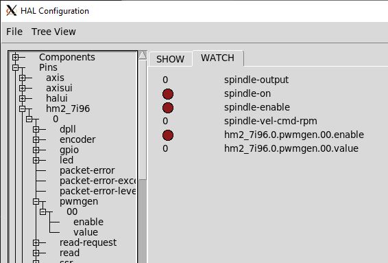

24 Feb 2022 14:52 - 24 Feb 2022 14:54 #235699
by kbec
I am not sure how you programmed the write. I am thinking the parameter I need is not getting written out.
I reloaded and now the config info pulls in like it should.
When I was looking about it last night, I think the missing piece is a tie in between
hm2_7i96.0.pwmgen.00.value and pid.1.output, I am not sure where that pid.1.output is getting set. I am wondering if that is the setp with no content.
setp pid.1.Igain [SPINDLE]I
setp pid.1.Dgain [SPINDLE]D
setp pid.1.bias [SPINDLE]BIAS
setp pid.1.FF0 [SPINDLE]FF0
setp pid.1.FF1 [SPINDLE]FF1
setp pid.1.FF2 [SPINDLE]FF2
setp pid.1.deadband [SPINDLE]DEADBAND
setp pid.1.maxoutput [SPINDLE]MAX_OUTPUT
#setp
net spindle-index-enable <=> pid.1.index-enable
net spindle-enable pid.1.enable
net spindle-vel-cmd-rpm => pid.1.command
net spindle-vel-fb-rpm => pid.1.feedback
net spindle-output <= pid.1.output
net spindle-output => hm2_7i96.0.pwmgen.00.value
#setp

24 Feb 2022 14:58 #235702
by BigJohnT
Also if you can get me a list of pin, parameters and signals and post the text file that will help.
JT
halcmd show > 7i96.txtJT
