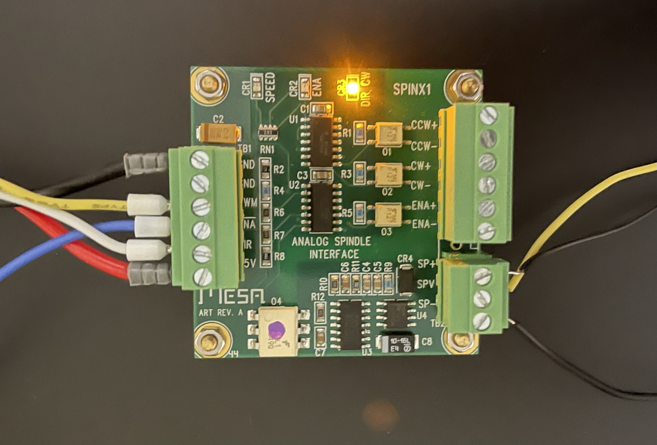

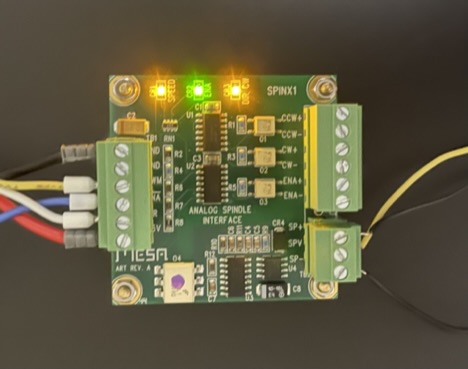

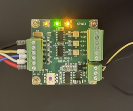

28 Feb 2022 01:36 - 28 Feb 2022 01:37 #235972
by kbec
Replied by kbec on topic Mesa 7i96 with SPINX1 to control spindle speed
Ok, my config seems to be working fine, Now I just am wondering about my output from the SPINX1 card. I am not getting anything from the digital potentiometer output of the SPINX1, the motor just turns at full speed.
I think I am missing a connection?, but I don't know what is missing. I am hoping PCW can help me, or someone else familiar with this.
I have attached some photos. The intensity of the speed LED goes up as the speed sent to it increases, so that seems to be working. The enabled also comes on when it should be running, so that seems fine as well. The direction stays lit as soon as I power it up, I guess that is ok.
Last edit: 28 Feb 2022 01:37 by kbec.
- Posts: 18103
- Thank you received: 5326
28 Feb 2022 03:05 #235978
Replied by PCW on topic Mesa 7i96 with SPINX1 to control spindle speed
Did you measure the voltage on SPV relative to SP- at various spindle speeds?
(and also make sure the the voltage between SP+ and SP- is a steady 10V)
- kbec
- Posts: 133
- Thank you received: 4
28 Feb 2022 04:29 #235986
by kbec
I may have messed up my speed control,, now I need to see if that is ok. I do see about 10.8 V steady between the two poles. I am just not sure what is going on with my controller, the manual pot was working and now it isn't. The speed control pot doesn't seem like it is at mains voltage. I'll confirm once I make sure it's ok and let you know.
Thanks again
Thanks again
