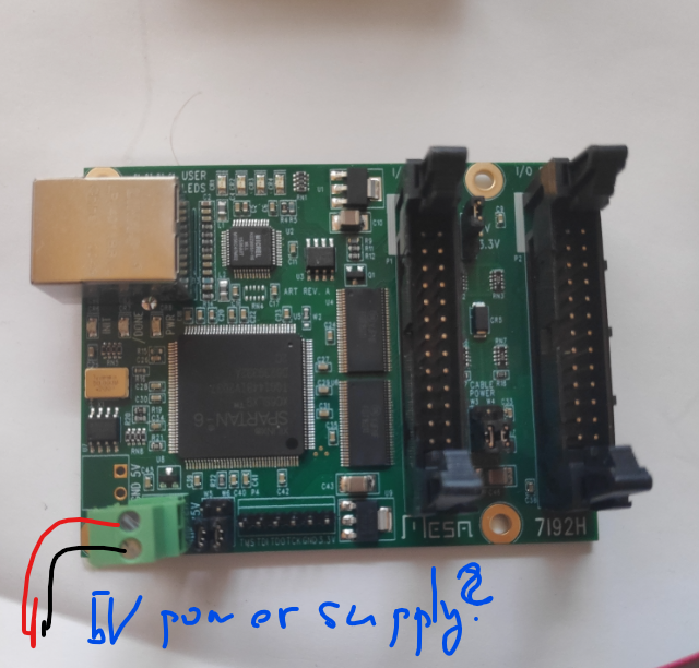

Hello,
I have mesa card 7i92 and I want to use it with chinese 5axis bob. Iam prepared to follow this steps forum.linuxcnc.org/49-basic-configuratio...rallel-port-bob-g540 for pncconf. Iam scared of doing some damage to the card, so I want to know if there is something to avoid if you know. Also, can you please tell me that the 5V place on the mesa is terminal for connecting power supply? I saw some photos where people have connected two wires but also running without connection - because If understand well, there is written its 5V power supply (5V Power) connector for BOB.
thanks

Yes, that is how you supply 5V power to the 7I92

The BOB and 7I92 should be powered from the same 5V source

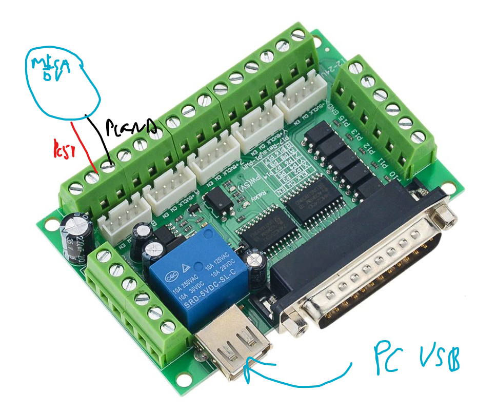

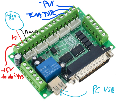

Thx PCW for fast answer.You mean same 5V source - my solution for this is in the picture. I use 5V USB power from PC and connect it to the BOB. Then from the BOB I connect that to mesa. I can measure 4,9V when just trying to see how much it does, but to be honest I dont trust to this solution.Do you think it will be bad if I connect BOB to 5V from the PC and use separated power supply for mesa?

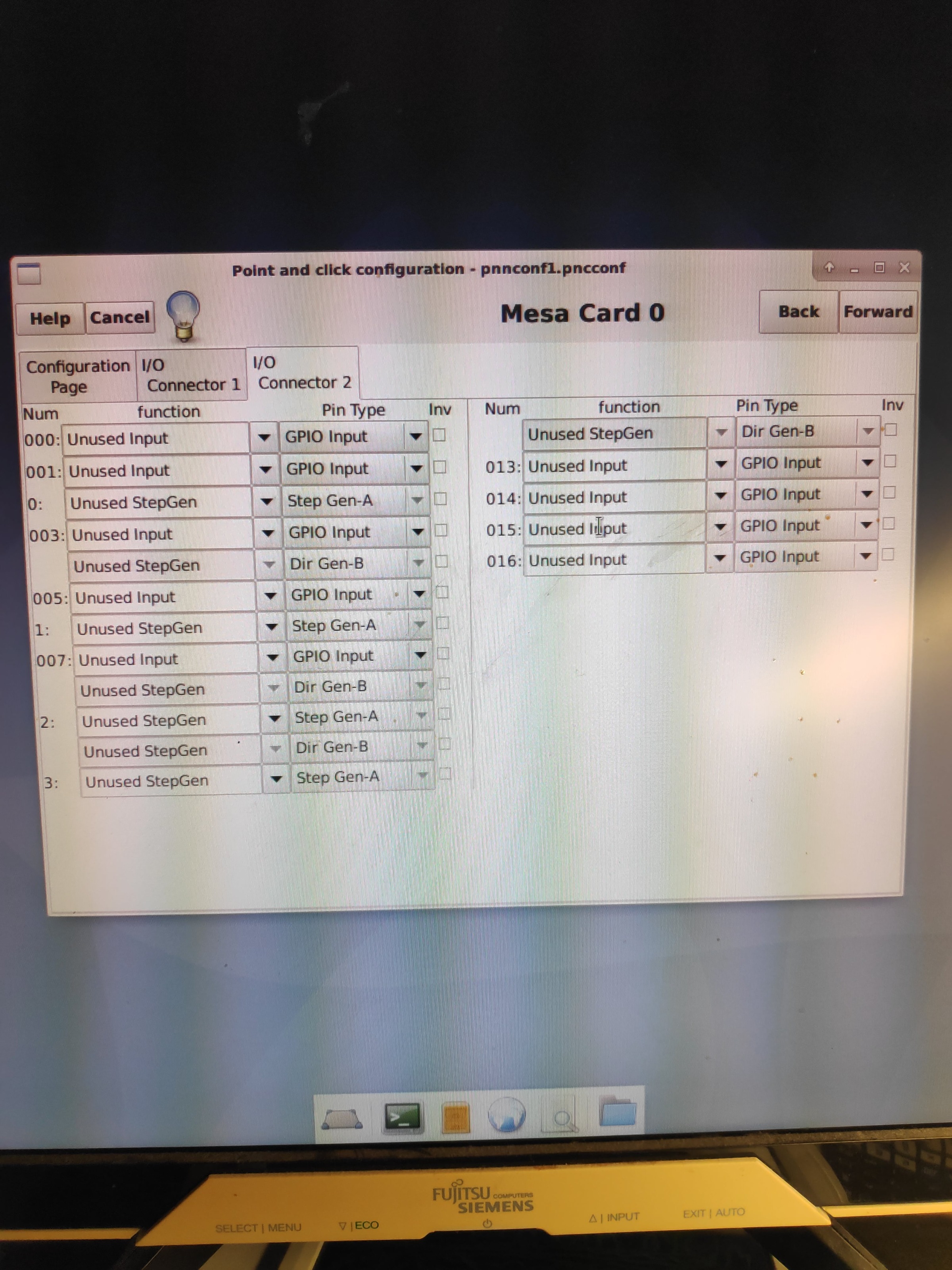

Also, according to the pnconf configuration from the forum.linuxcnc.org/49-basic-configuratio...rallel-port-bob-g540 I dont know what pin is related to the real BOB pin. I saw there is some firmware called 7i92_5abob but I absolutely dont know what to do with that. - I just have downloaded it from the mesa store in zip file.

I would stay with the USB power since its current limited so
a misconnect will not result in disaster.

That should be fine, the 5V to the step drives should just be going to the
drives optocouplers (no connection the the step motor power at all)

Pncconf does not have direct support for the 5ABOB firmware, but to a large
extent, this does not matter as the firmware will get the pin mapping correct
for things like stepgens and PWMgens. You just need to select a similar breakout
(like the G540).
The 5ABOB firmware maps the stepgens to 5ABOB pins
in the expected:
0=X
1=Y
2=Z
order
Note: you can get the pinout reference for a 5ABOB with this mesaflash command:
mesaflash --device 7i92 --addr 192.168.1.121 --readhmid --dbname1 5ABOB
