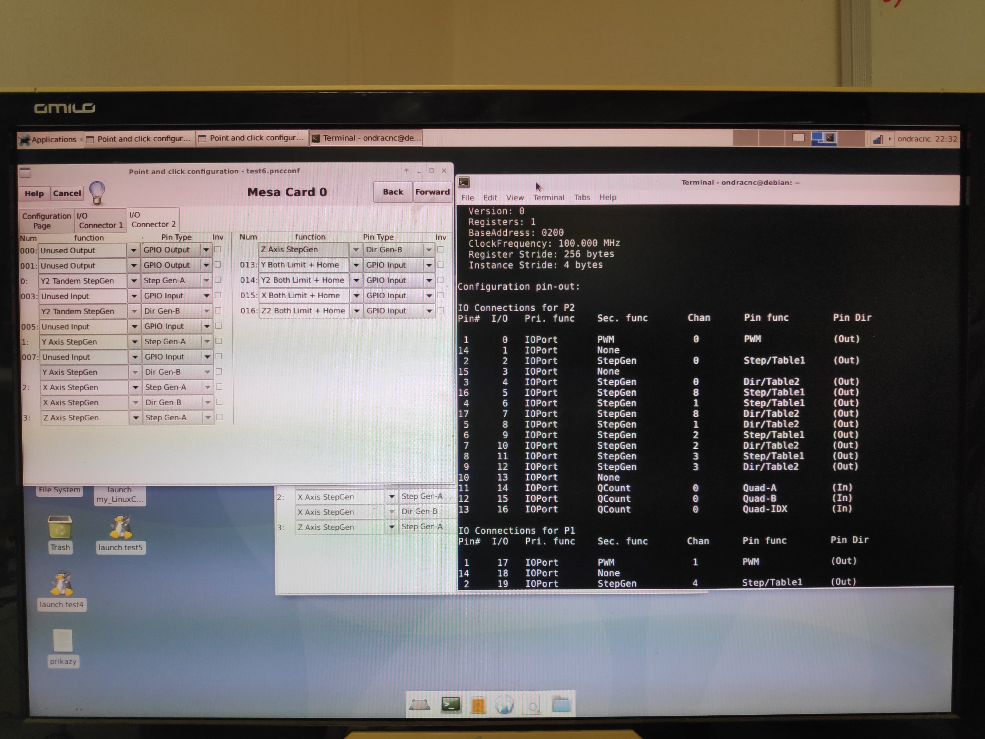

I used mesaflash --device 7i92 --addr 10.10.10.10 --readhmid, the mesaflash --device 7i92 -addr 10.10.10.10 --readhmid --dbname1 5abob output was : mesaflash: unrecognized option --dbname1however Iam still not able to know what pin belong where. there is only Pin and I/O and none of them tell me excatly what Num is that in Pncconf.
I tried to move with motors but I was just getting some errors (Join 0,1,2 on limit switch error), probably not well configured.When I check override limits Iam able to move with motors but its not working properly, some limit switches are not wired well probably...

In the terminal, the result of mesaflash:
PIN# are parallel port pins
I/O are mesa pins, or the pins used by hal file.

You need the latest mesaflash to have the dbname# option:
github.com/LinuxCNC/mesaflash
(build/install options on the bottom)
Here is the result of running the command on a 7I92 with 5abob firmware:

I installed latest mesaflash from github steps.
I think the mesaflash --device 7i92 --addr 10.10.10.10 --readhmid gave me better informations [if those PIN# and I/O are really configuration of mesa]. The dbname1 output give names and I/O pin {dont know whats advantage of this}.
However I was not able to set proximity sensors. They are connected to BOB pins 11,12,13,15 if I look on I/O, then it should be 14,15,16,3. Do this numbers {Num} match to these in pncconf when I set I/O connector 2? Only one proximity sensor seems to be doing something, Iam getting just some errors due to low knowledge of homing machine {but first I want to know that the limit switches are well defined}.
I found something in hal file and changed there this numbers, but its working still same I think...
guys thank you for your help

on the BOB including the PWM, relay and axis names
Did you look at the limit.home switch pins in halshow to verify that:
1. They change when you activate the switch by hand
(on that BOB you need to supply external 12V-24V and the
inputs are activated by grounding them)
2. That they have the correct polarity (false when not activated)
(you may need to check the invert option in pncconf)
Replied by PCW on topic 7i92 + bob
The advantage is that the "dbname#" listing gives the names usedThe dbname1 output give names and I/O pin {dont know whats advantage of this}.

yes problem was in the inverting signal in pncconf... (thx I wasnt even trying this option because I thought its well configured)
Bob is powering with 24V, the proximity (NPN NO) sensors are wired as in previous photo ( wondering if there is not necessary some pull up resistor for example..?)
However one thing is again strange for me. For proximity sensors in pncconf I have set function <Axis> Both Limit + Home, Pin Type GPIO INPUT.
Thats for all axis (X, Y, Y2, Z). I run configuration and click on Home All (btw. everything is connected on my desk not on the machine).
The first is homing Z axis, when is motor turning I trigger the sensor (motor then spins slower), wait a while and again trigger the sensor - from this Iam expecting to have Z axis homed. But it tells me joint 3 on limit switch error.
Am I doing something wrong? I have read linuxcnc.org/docs/devel/html/config/ini-...html#_home_is_shared and was looing on another topics also...

Did you set the home latch velocity as opposite?
