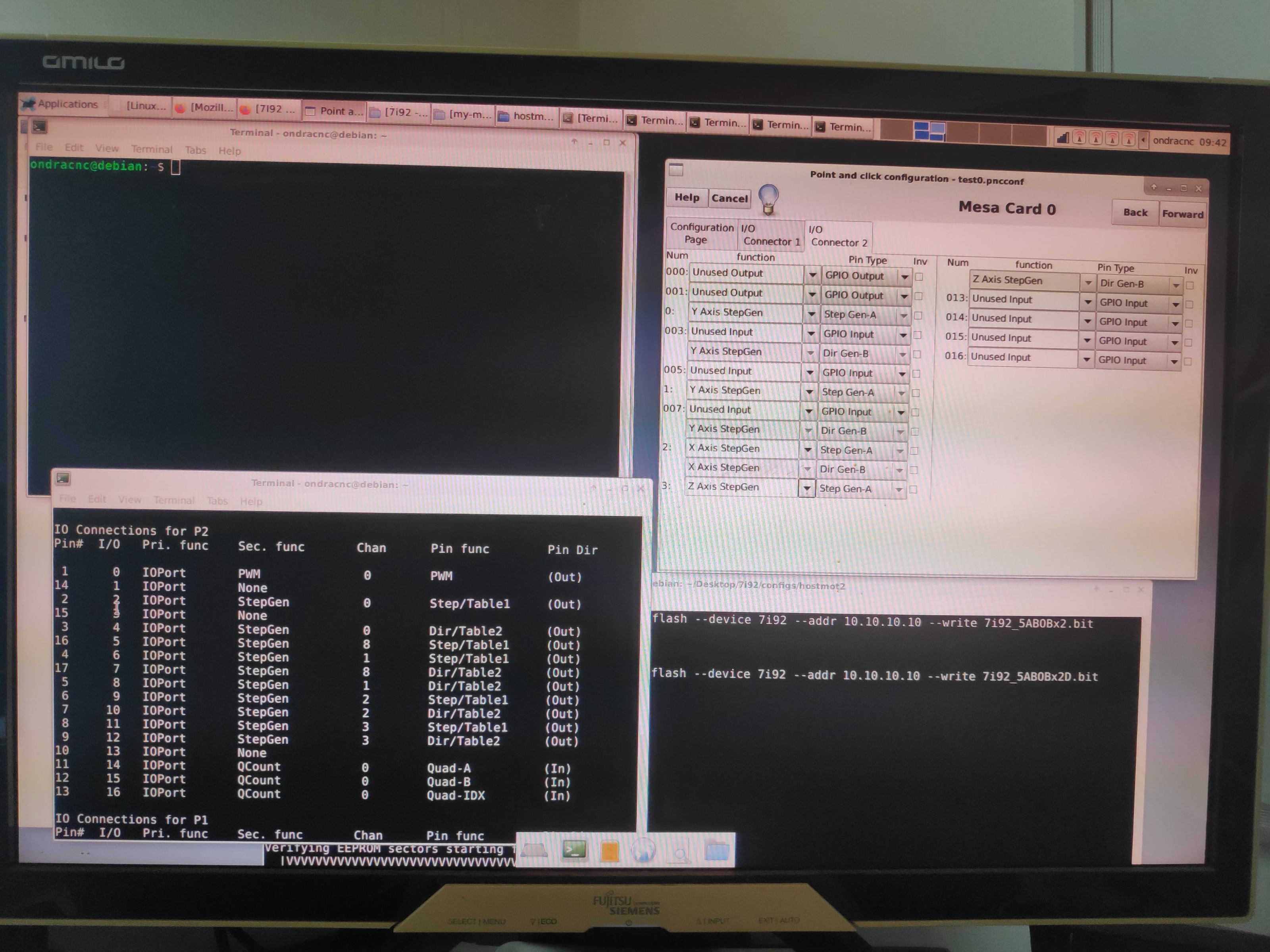

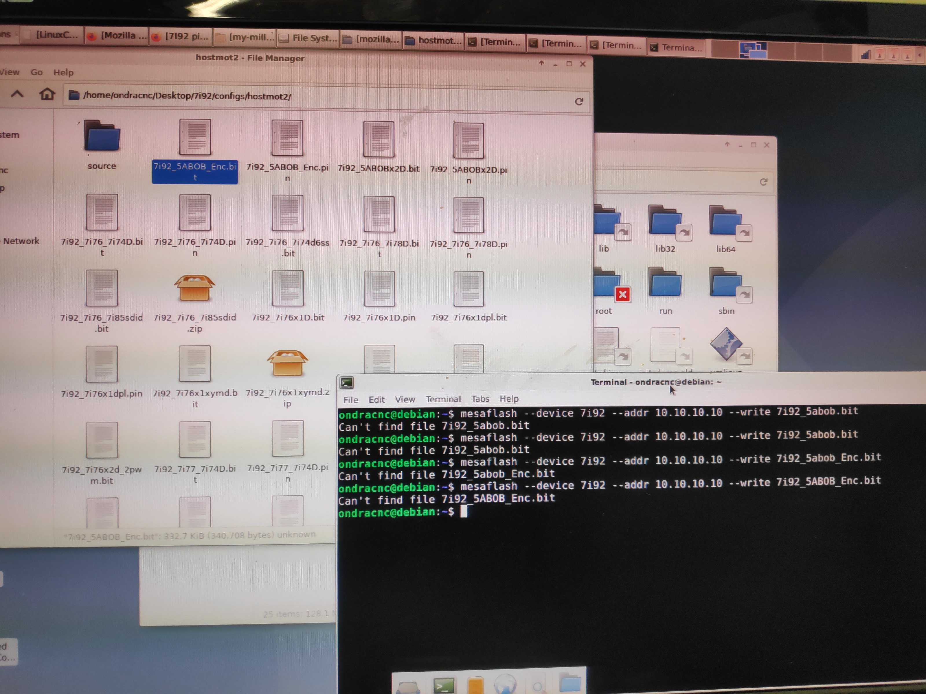

02 Jul 2022 10:31 - 02 Jul 2022 11:19 #246427
by Ondrej
Replied by Ondrej on topic 7i92 + bob

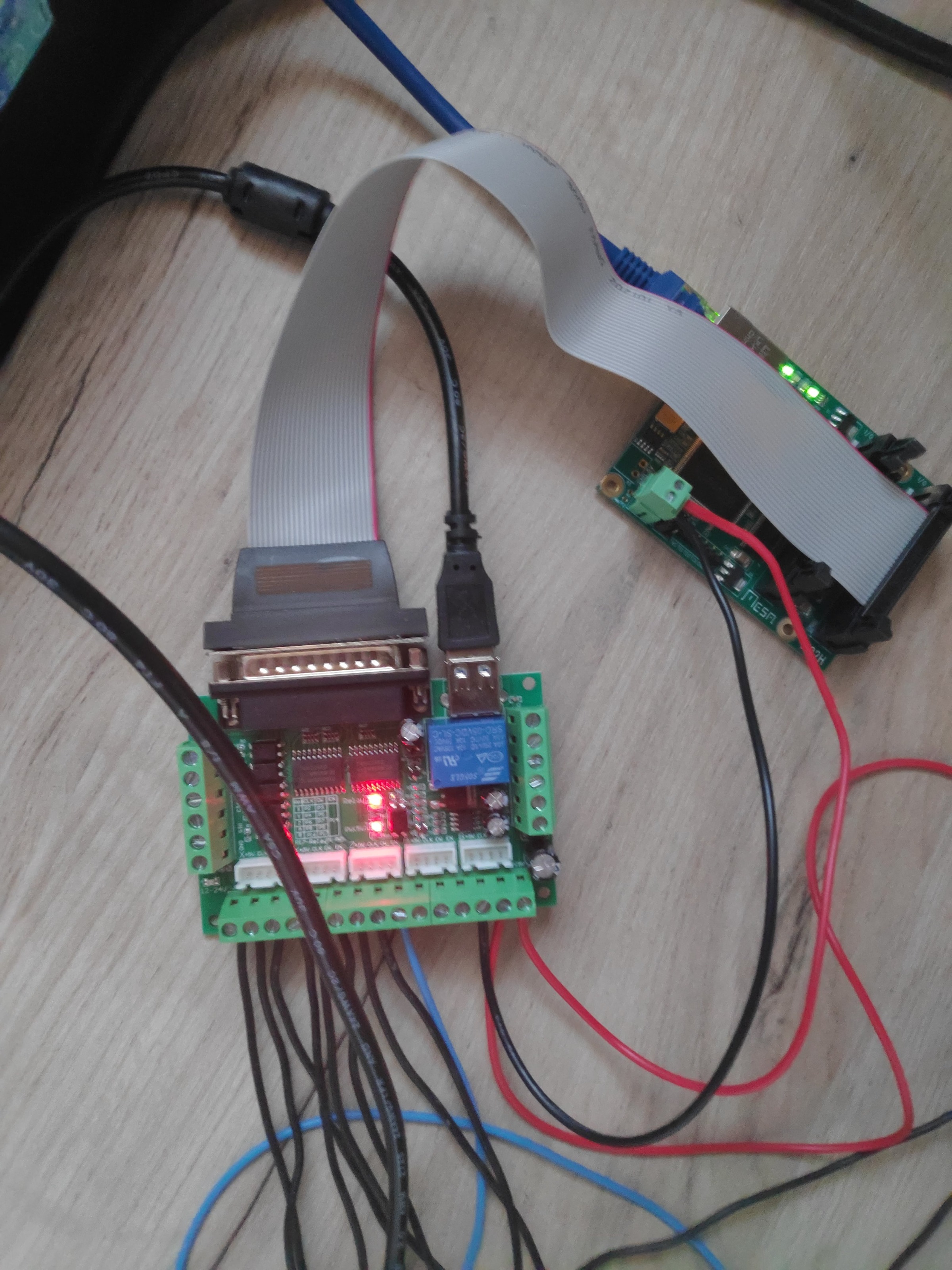

So I have changed W6 to UP - so mesa IP adress is 10.10.10.10. I havent found anything better than JTs gnipsel.com/linuxcnc/uspace/debian9-eth.html for doing something (I absolutely dont know if this is right way what you PCW mean, because I almost absolutely dont know what Iam doing) with enp2s0.
I also downloaded : sudo apt-get install network-manager network-manager-gnome
and used (but terminal wrote there is nothing like wicd in my PC) : sudo apt-get remove wicd wicd-gtk
I power cycled the PC.
Then I typed mesaflash --device 7i92 --addr 10.10.10.10 --write 7i92_5abob.bit
but the terminal answered Can"t find file 7i92_5abob.bit.
I dont know if I have to download this file from mesa store, so I did that.
But in that file there is not this 7i92_5abob.bit but there was 7i92_5abob_Enc.bit so I tried to type this and again it wrote cant find file.
Also the CR1,CR2,CR3,CR4 leds are all ON on the mesa card.
note: for internet connection Iam using USB - wifi adapter.
any thoughts?
any thoughts?

02 Jul 2022 14:28 - 02 Jul 2022 14:34 #246440
Replied by PCW on topic 7i92 + bob

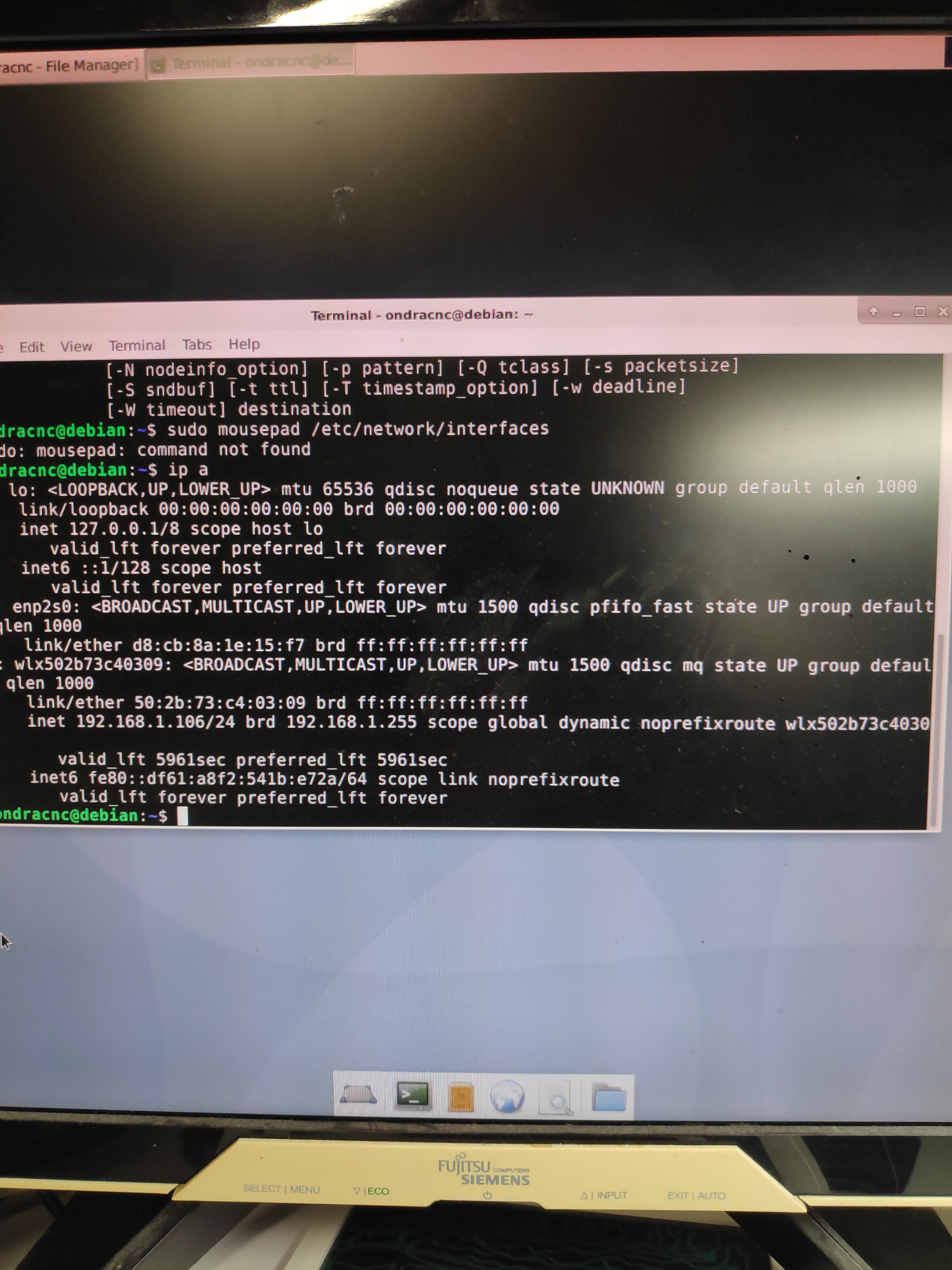

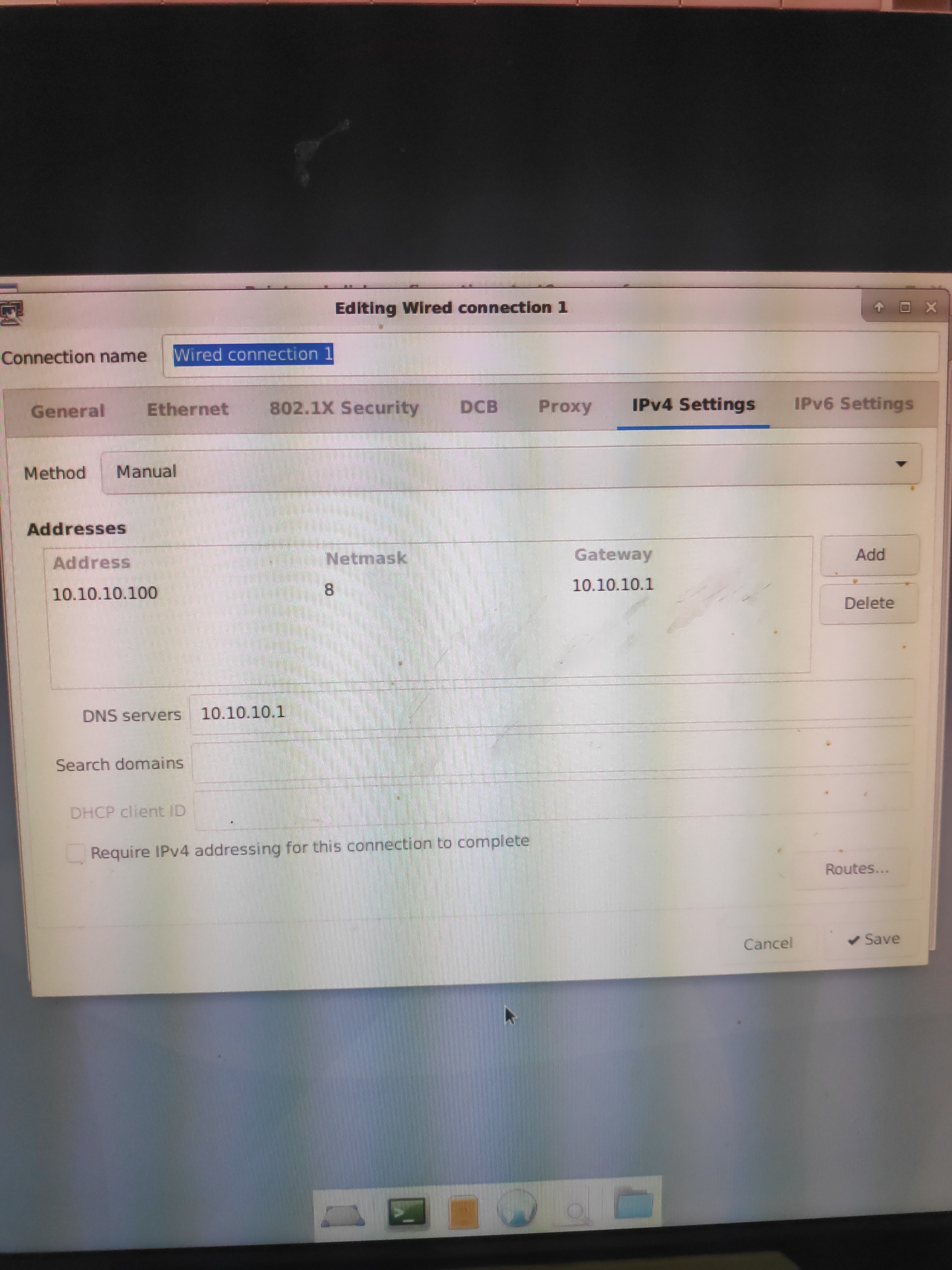

1. You have not set a static IP address on the host PCs Ethernet adapter.
(you can do this with net manager). When done you should get something
like this with the "ip a" command:
2: enp2a0: <BROADCAST,MULTICAST,UP,LOWER_UP> mtu 1500 qdisc fq_codel state UP group default qlen 1000
link/ether ec:b1:d7:6c:a2:da brd ff:ff:ff:ff:ff:ff
inet 10.10.10.100/8 brd 10.255.255.255 scope global <<<<<<<<<< NOTE THIS LINE
valid_lft forever preferred_lft forever
2. You must run mesaflash in the directory that contains the bit file
(or give a complete path to the bitfile on the mesaflash command line)
3. The complete 5ABOB bitfile name is 7i92_5ABOBx2D.bit
Last edit: 02 Jul 2022 14:34 by PCW.

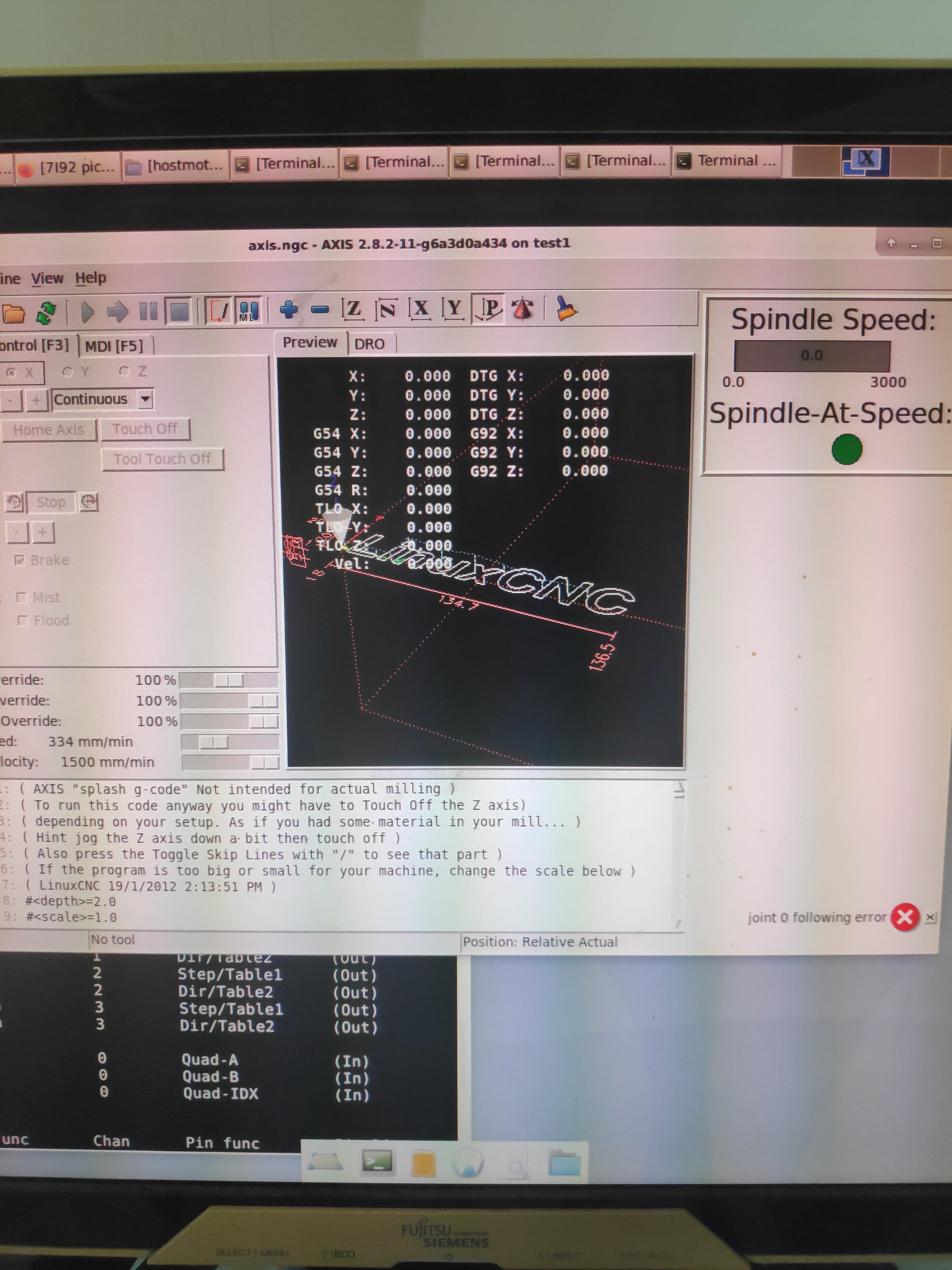

- Ondrej
- Posts: 63

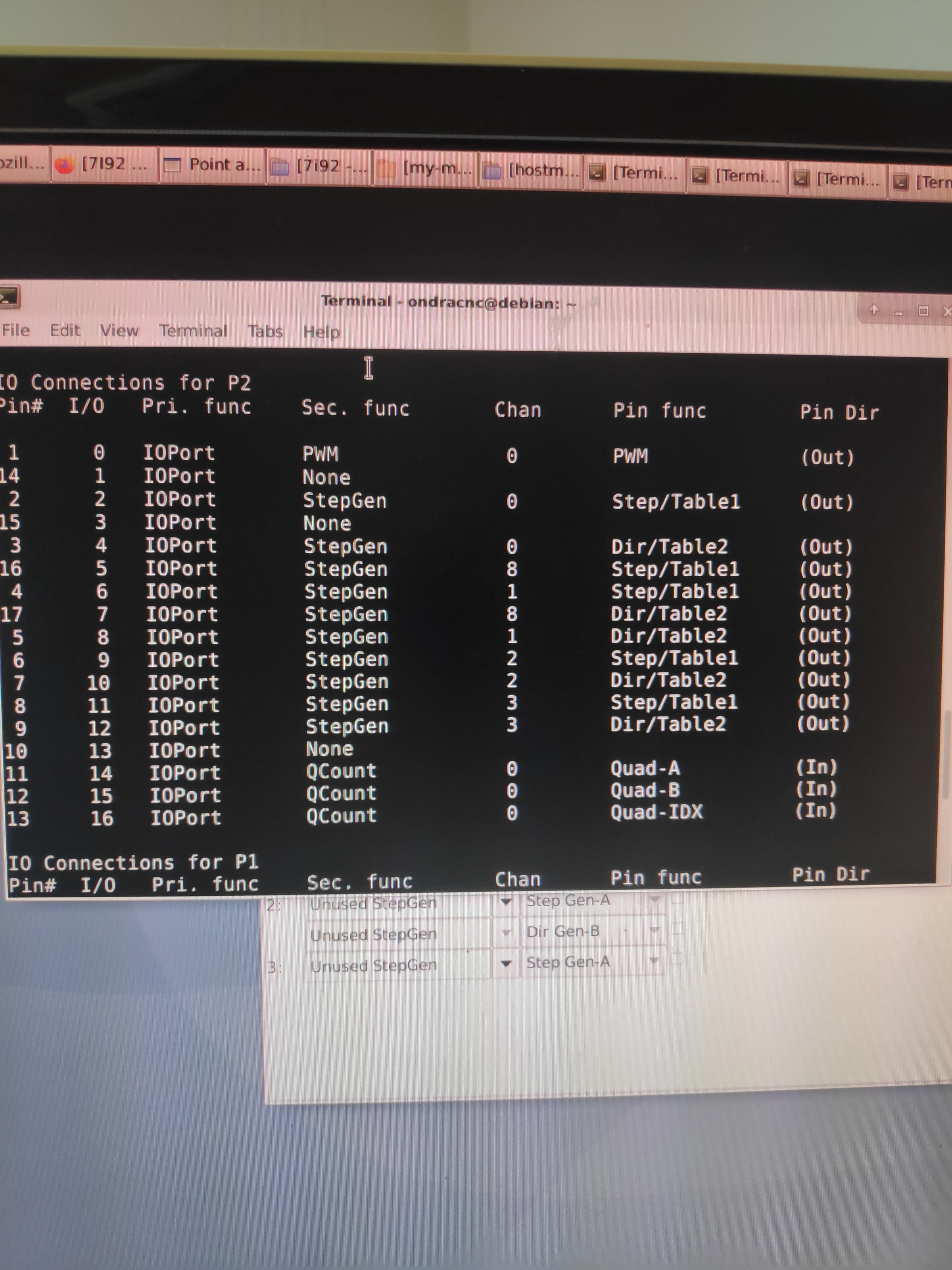

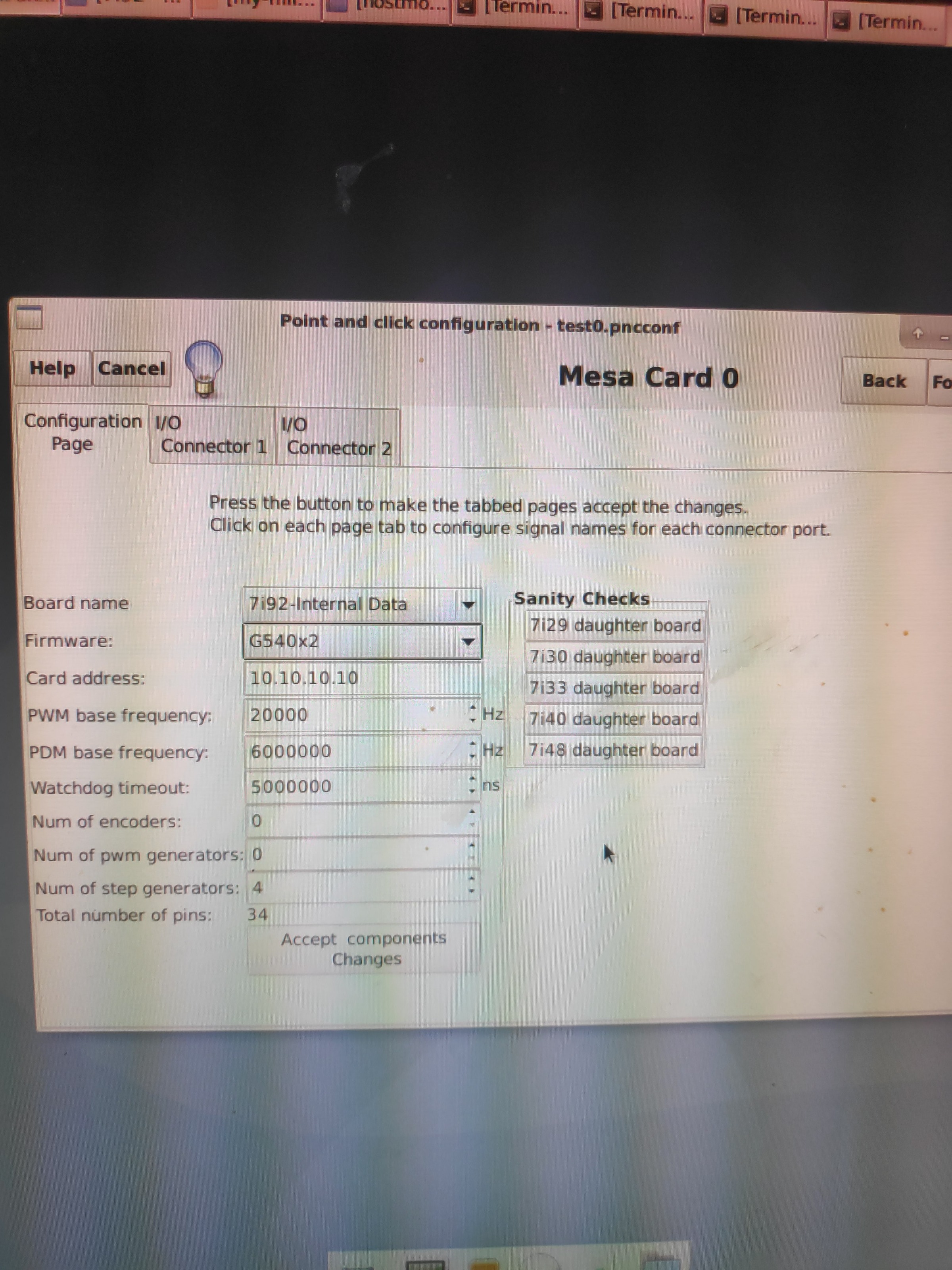

03 Jul 2022 08:31 #246484
by Ondrej
Ok. I think I did sucesfully do that. I followed this steps forum.linuxcnc.org/27-driver-boards/3559...ethernet-mesa-boards
. When I type mesaflash --device 7i92 --addr 10.10.10.10 --readhmid I can see informations about mesacard.

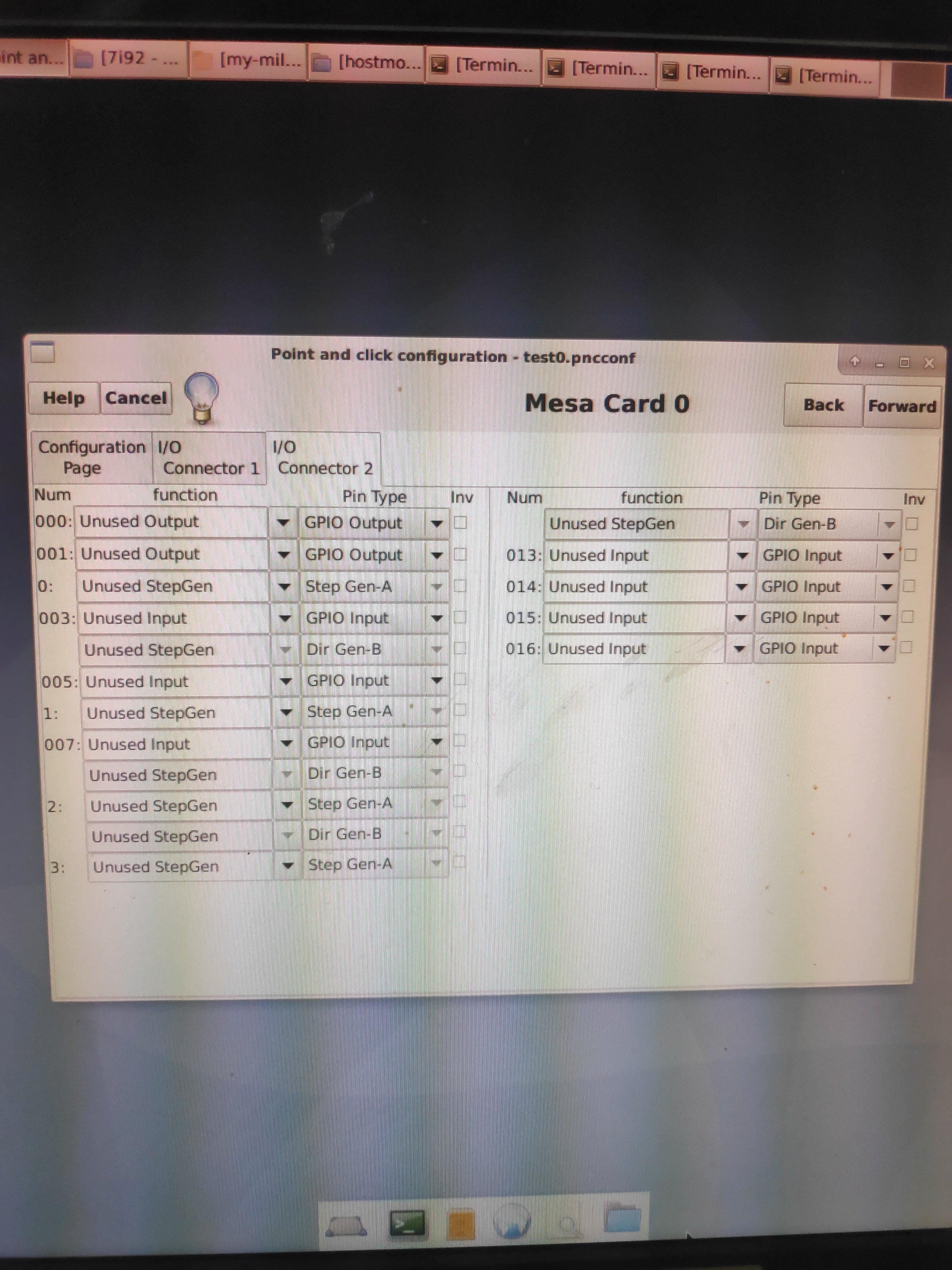

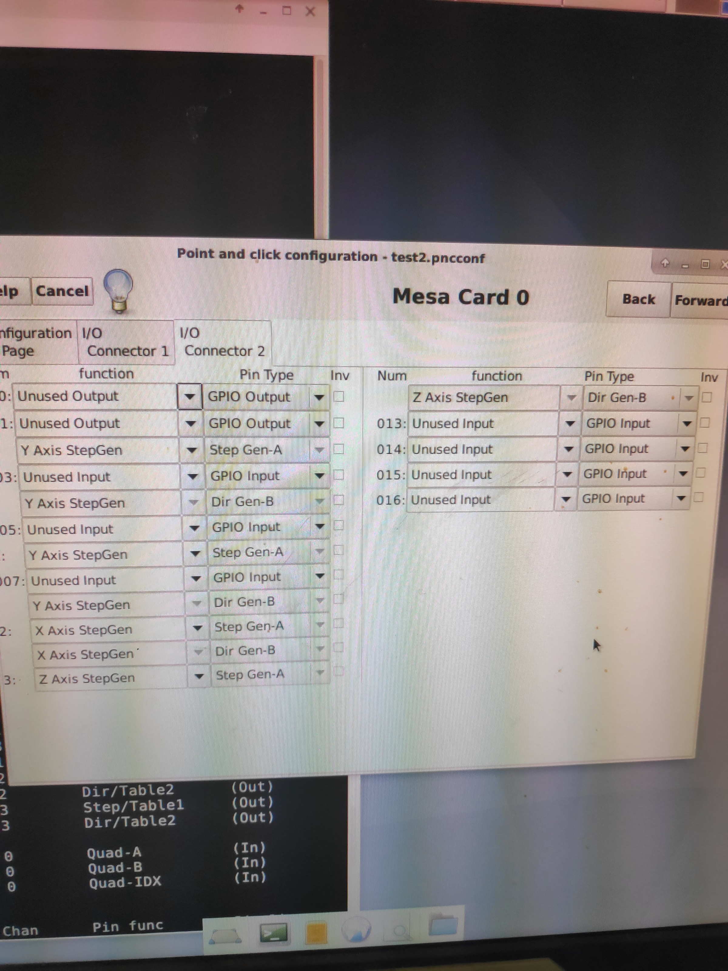

I was doing pnconf - following this steps forum.linuxcnc.org/49-basic-configuratio...rallel-port-bob-g540 with changes according to my needs - I still dont know what pin is what according to the pnconf and bob. I was able to move with motors in testing.
I used this configuration - just motors.
I saved the configuration. Run launch of this setup. Everything seems ok but when I try to move with axis here then I get errors.
I think this will be something problem with enable, because when I was running this setup throught LPT + lcnc I was defining the enable pin. And in this setup there is not, but I was able to move with motors, so I dont know...

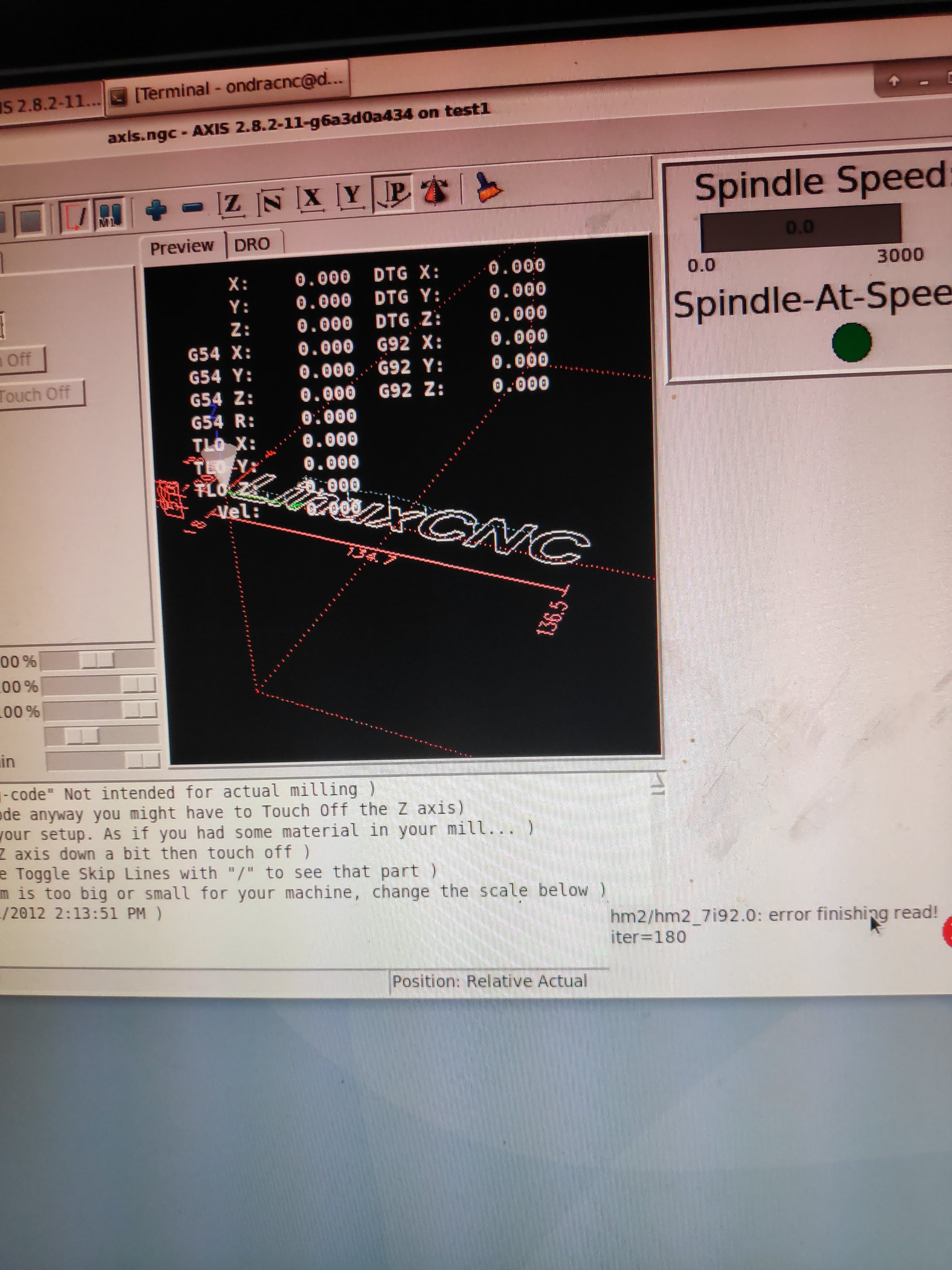

04 Jul 2022 19:02 #246595
by Ondrej
- Posts: 18100
- Thank you received: 5326
04 Jul 2022 19:07 - 04 Jul 2022 19:08 #246596

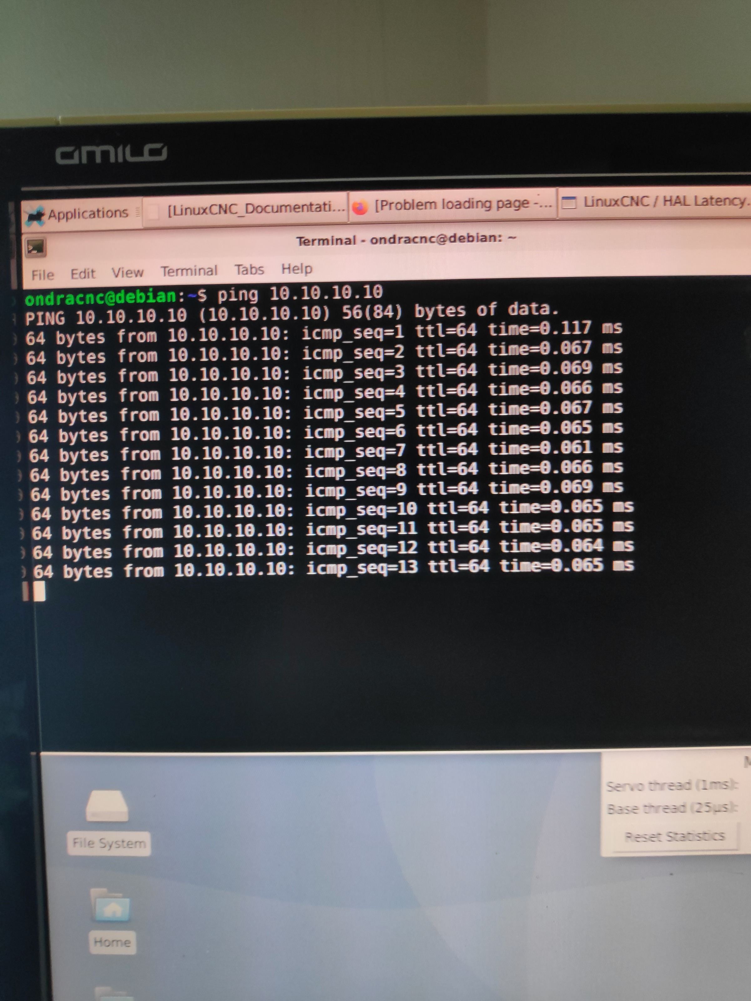

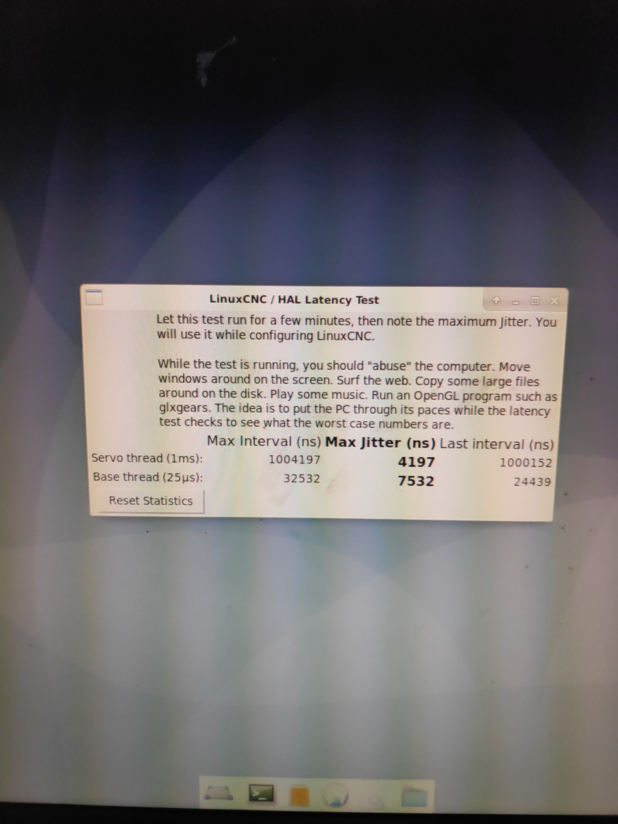

"error finishing read!" is most likely a latency issue on the host PC
Have you run a latency test?
What are the ping times if you ping the 7I92?
(ping 10.10.10.10)
(ping 10.10.10.10)

05 Jul 2022 06:34 #246628
by Ondrej
- Posts: 18100

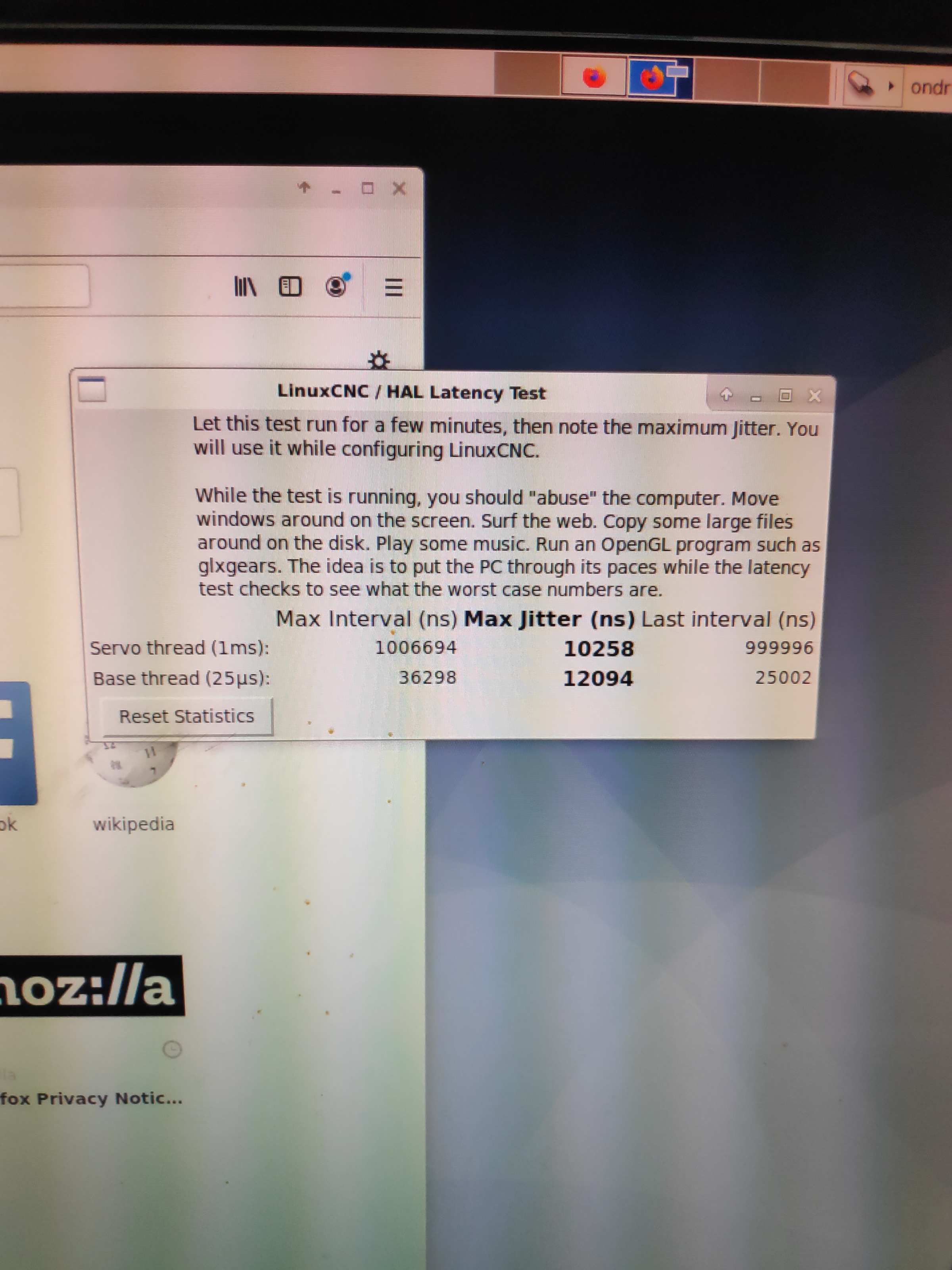

05 Jul 2022 19:23 #246677
The ping times and latency look fine,
What is your servo period?
