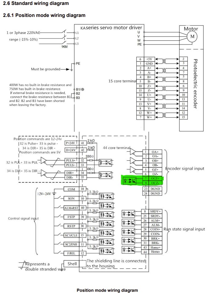

7 wires come from a 6 tool turret, 1 E-Stop, Home X and Z - 2 inputs, Alarm 1 input. In total 11 - all input are used + a spindle encoder.
The differentia receiver needs an other firmware to use the parallel expansion port?
But on the servo encoder output has an other output too, via optocoupler for Z index (if i understand correctly)

I do not know what input to use. One encoder will be on the spindle, so there are no free inputs left, only the P1Are you using the encoder input?

You could use the OCZ signals directly on P1
(if you are careful with wiring)
This would require custom firmware

What type of voltage can use the P1? (3.3v, or 5v; are they pull-up, or pull-down)
I think that I could directly use that optocoupler OCZ signal with 3.3v, 5v, or GND from the card. But I will test it.

The P1 I/O pins are TTL level with pullup resistors to 5V
The accept a maximum input voltage of +7V
and a minimum of -0.6V. They have TTL input thresholds
(~1.7V)
They are fairly easy to damage with negative inputs
without current limit (less than -0.6V will damage the
input clamp diodes)
How do you get a high current negative input? Its easy,
just connect a P1 pin to case ground in a electrically
noisy environment with HF noise from motor drives.
You can protect the I/O from this kind of
a hazard with a small series resistor (say 47 Ohms)
I can make some 7I96S firmware with this option when
I get a chance.

OCZ+ -> resistor ? Om (kOm) -> P1 pin
Is that correct?
What about the firmware?
Is there any tutorial video how to make it, with which software, and what pin to add to specific card to use only the index for homing?

7i96s with stepgen indexes 0..4 on P1 HDR pins 1,2,3,4,5
(DB25 pins 1,14,2,15,3)
