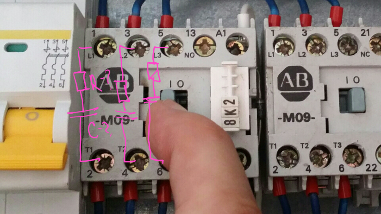

Replied by PCW on topic 7i96S card arrived what setup is recomended
OK if there is a flyback diode on the contactor coil, the noise is likely coming
from the contact side of the contactor
If you cannot isolate the control wiring from the power wiring you
may need to either shield the control wiring or add arc suppression
to the contactor contacts (commonly a R/C snubber is used here)

But in my case the flyback diode and the coil are not working, because I switching ON/OFF the contactor by my hand (without 24v power supply) and the input LEDs are blinking.
I will try to shield it and somehow separate them.
The arc suppression looks like this? What resistance resistor and what capacity capacitor should I use? (if the manipulation wont be success)

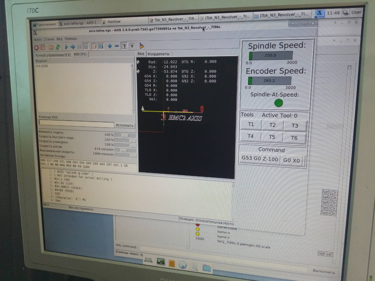

Here are the conf files.2) The Spindle Close-Loop
There is a simple 3 ph AC motor and inverter. They are connected and turning the Spindle CW/CCW.
The Lathe has 3 speeds. On the first speed when I command to turn 200 rpm (almost 1:1 ratio), it's turning with 275 ±2rpm.
The scaling not correct yet. I will do it soon.
Is it possible to use the Close-Loop to use all speeds automatically, without using any other hal component.
(the lathe config will upload on monday.)

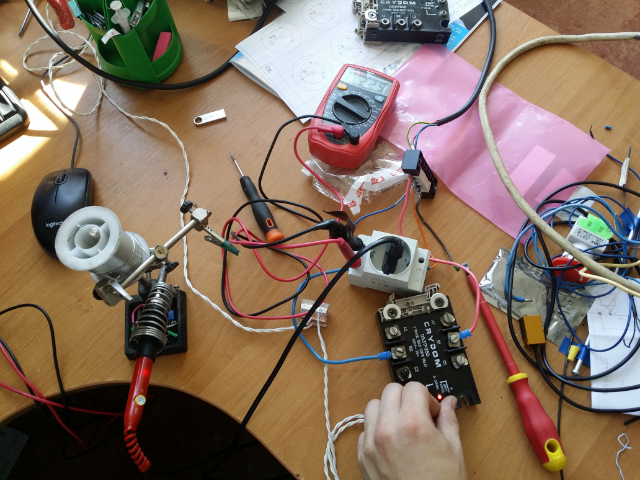

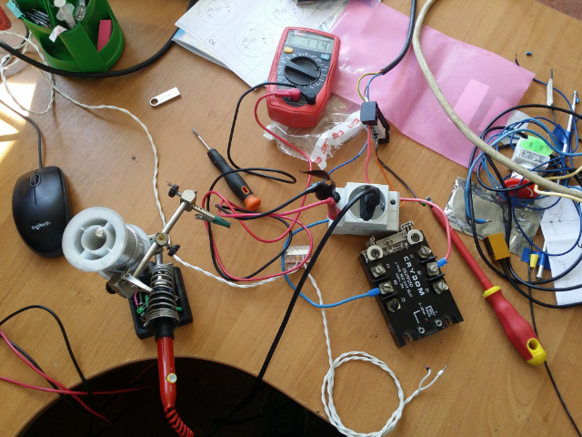

We received 3 ph SSR (i think they are used) - D53TP50D Relay; SSR; Zero-Switching; Cur-Rtg 50A; Ctrl-V 3-32DC; Vol-Rtg 48-530AC; Pnl-Mnt.
But not really understand, are they OK?
Without load I see 220V.
When I plug a load (soldering iron) I see 114v. (but the load not turns ON) With a 25W lamp the voltage is 0v.
When I turn on the SSR with 24v I see 220v and the load is turns on. (With a 25W lamp the voltage is 220v.)
So the question is, Can I use them for Turret CW/CCW switching 2 wires?
The output will look like (A2toA2) (B2toC2) (C2toB2) and goes to the turret 3 ph AC motor.
Wont it blow up (with those measurements)?

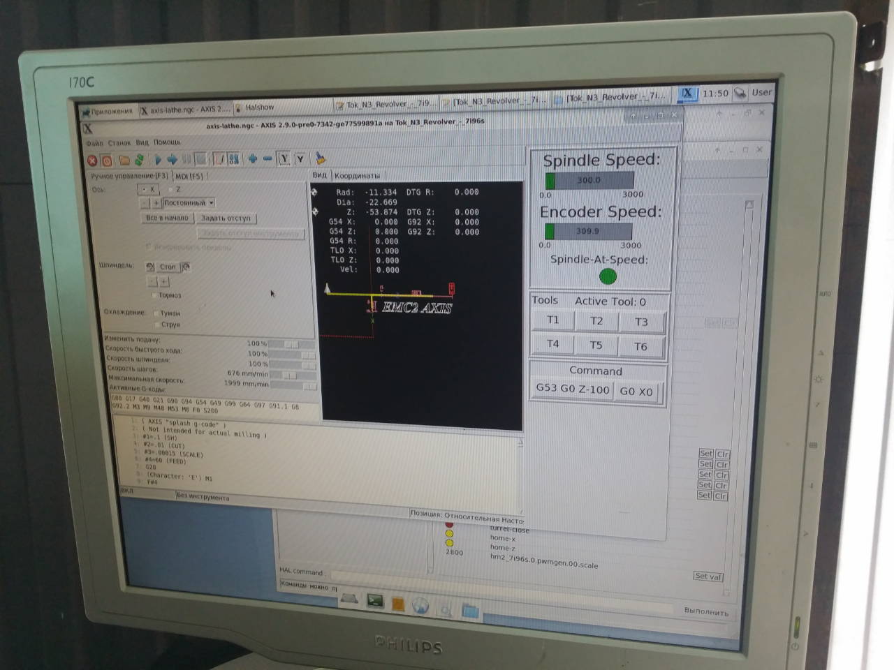

setp hm2_7i96s.0.pwmgen.00.scale [SPINDLE_0]MAX_RPM (in the hal)
I have 275 ±2rpm, when I command to turn 200 rpm.
But when I change the MAX_RPM = 2800 (2700) It should change the pwm.scale, but no effect.
Then I command to turn 300 rpm I have 310 ±2rpm
Then I command to turn 400 rpm I have 425 ±2rpm
So I'm not really understand how to use the 7i96s functionality...
Or I have problems with the 10v output from the VFD - 10.67v
200 rpm (Enc 270) - 0.75v
300 rpm (Enc 310) - 1.13v
400 rpm (Enc 420) - 1.51v
500 rpm (Enc 530) - 1.89v
Encoder showing correct numbers (270 rpm), I've tested it with an optical tachometer (270± rpm on the spindle).

07 Sep 2022 15:28 #251411
The voltages look scaled correctly (200/2900 *10.67 = 0.735862069V so 0.75V is very close)
but its likely the VFD is not terribly linear at low speeds. MAX_RPM will change the PWM scaling
but if you need it to be more linear you may need to use some compensation like the lincurve
component (or run closed loop)
