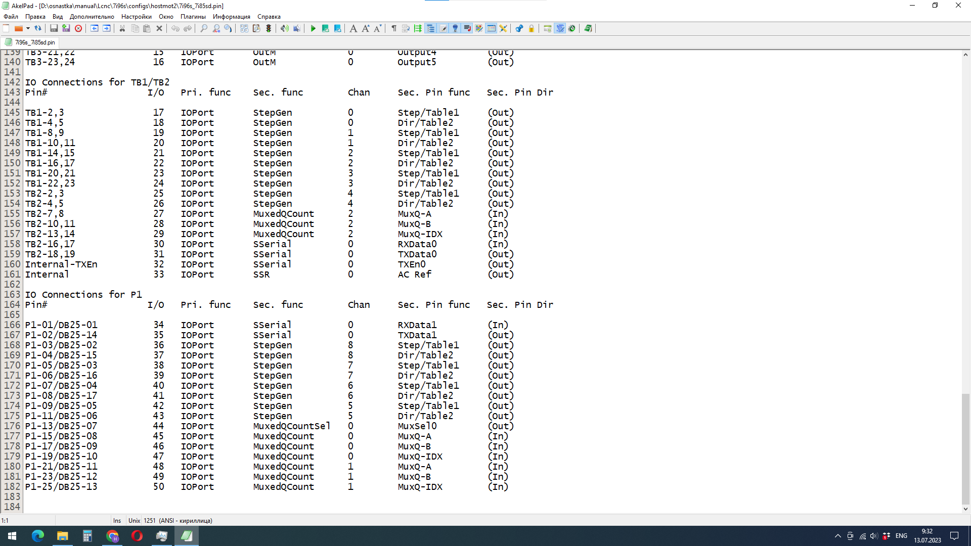

12 Jul 2023 10:56 #275274
by xenon-alien
Replied by xenon-alien on topic 7i96S card arrived what setup is recomended
Hello!
It looks we will need a configuration for a DIY lathe with a few mesa cards - 7i96s + 7i85s + 7i84.
Witch firmware should i use for this combination?
Axis-spindle feedback (encoder, linear scale, homing index), servo step/dir (1 spindle + 3 axis), plus I/O ports

13 Jul 2023 06:46 #275320
by xenon-alien
I did check the downloads and found a few fw for this combination and not understood the only 3 encoders (0, 1, 2) in the 7i96s_7i85sd*.pin file
I have already flashed the card with index support for axis on p1-p5
I have red the recommended topic and it seems the 7i96s_7i85sd.bin is the needed one. Am I correct?
I did pncconf and found the serial part of the setup (never used it before)7i84 is a Smart Serial card, so no firmware required for it, it just works.
I have seen here the 7i96S + 7i85S firmware, probably is included in the downloads from www.mesanet.com, di you check?
Do a readhmid first, might be already on the 7i96S.
- Posts: 21995
- Thank you received: 7488
13 Jul 2023 11:42 #275331
Replied by tommylight on topic 7i96S card arrived what setup is recomended
Those are muxed (multiplexed) encoders, so each of those can read 2 encoders at the same time.
Not sure but seems ok to me.
I have ordered the boards so waiting, then i will have to go through this. I also need analog stuff, so more fun.

- Posts: 18110
- Thank you received: 5329
13 Jul 2023 14:50 #275346
Replied by PCW on topic 7i96S card arrived what setup is recomended
Yes those are muxed encoders so
7I85S:
Muxed encoder 0 = encoders 0,1
Muxed encoder 1 = encoders 2,3
7I96S:
Muxed encoder 2 = encoders 4,5
(encoder 5 is an aliased copy of encoder 4 so not usable)
7I85S:
7I96S:
