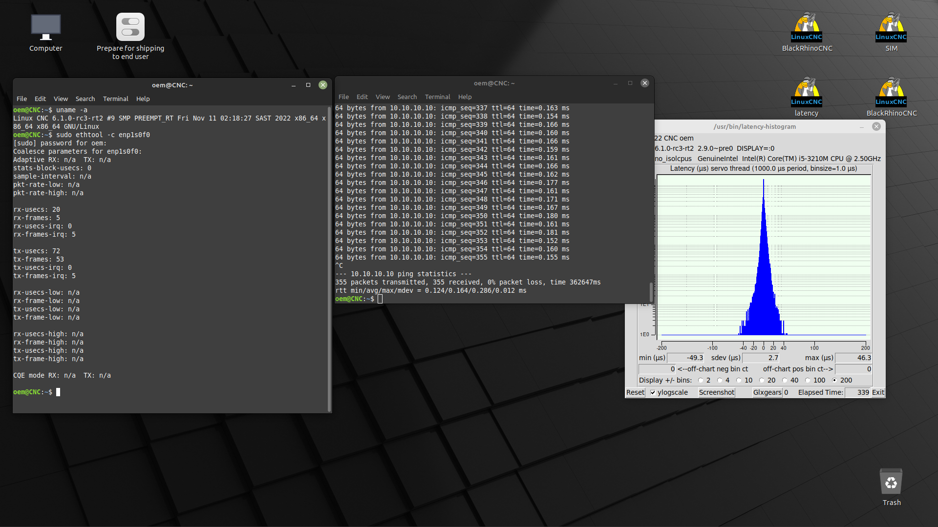

Servo period and timeout make little difference. mint 21 with homebru kernel 6.1 rt cant get this figured yet.
see attached
Just thought of tcp_nodelay?
see attached

linuxcnc.org/docs/devel/html/man/man9/hm...FACE%20CONFIGURATION
Do that and share the same output.
Then if you get erorr finishing read, with linuxcnc running, share the output of
I think i have worked out how to install the linuxcnc bookworm debs on arch linux. It worked for mesaflash last night, now to try on the big debs!
Replied by rodw on topic Mesa hm2/hm2_7i96s.0: error finishing read
It does not look like you've followed the steps hereServo period and timeout make little difference. mint 21 with homebru kernel 6.1 rt cant get this figured yet.
see attached
halcmd show param hm2*tmax* I think i have worked out how to install the linuxcnc bookworm debs on arch linux. It worked for mesaflash last night, now to try on the big debs!

oem@CNC:~$ halcmd show param hm2_*.tmax*
Parameters:
Owner Type Dir Value Name
36 s32 RW 0 hm2_7i76e.0.read-request.tmax
36 bit RO FALSE hm2_7i76e.0.read-request.tmax-increased
36 s32 RW 1725891 hm2_7i76e.0.read.tmax
36 bit RO FALSE hm2_7i76e.0.read.tmax-increased
36 s32 RW 129349 hm2_7i76e.0.write.tmax
36 bit RO FALSE hm2_7i76e.0.write.tmax-increased
this at fail

What CPU hardware/CPU speed/ Ethernet MAC?
