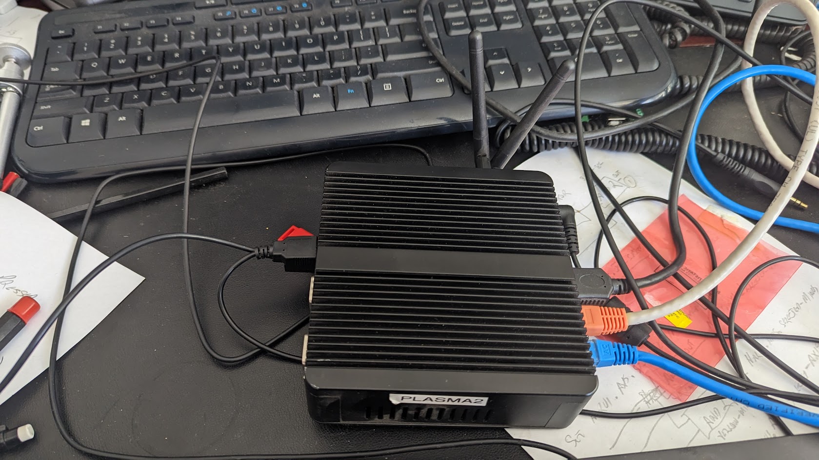

- Posts: 12158
- Thank you received: 4150
15 Dec 2022 21:24 - 15 Dec 2022 21:34 #259587
Replied by rodw on topic Mesa hm2/hm2_7i96s.0: error finishing read
Hmm, this J1900 PC
has the best latency I've seen in a Celeron
Custom kernel from above, isolcpus=2,3, R8168-dkms network driver, 7i76e
and the tmax values are not too bad either.
Ping times
Time to get it back on my machine!
The only thing wrong I can see is that if I set it up as an autostart, most of the time QTPlasmac fails to load due to a hm2 50 ms timeout. Can that be increased?
Attachment not found
plasma2@plasma2:~$ halcmd show param hm2*tmax*
Parameters:
Owner Type Dir Value Name
93 s32 RW 0 hm2_7i76e.0.read-request.tmax
93 bit RO FALSE hm2_7i76e.0.read-request.tmax-increased
93 s32 RW 649800 hm2_7i76e.0.read.tmax
93 bit RO FALSE hm2_7i76e.0.read.tmax-increased
93 s32 RW 310776 hm2_7i76e.0.write.tmax
93 bit RO FALSE hm2_7i76e.0.write.tmax-increasedPing times
plasma2@plasma2:~$ ping 10.10.10.10
PING 10.10.10.10 (10.10.10.10) 56(84) bytes of data.
64 bytes from 10.10.10.10: icmp_seq=1 ttl=64 time=0.664 ms
64 bytes from 10.10.10.10: icmp_seq=2 ttl=64 time=0.244 ms
64 bytes from 10.10.10.10: icmp_seq=3 ttl=64 time=0.229 ms
64 bytes from 10.10.10.10: icmp_seq=4 ttl=64 time=0.227 ms
64 bytes from 10.10.10.10: icmp_seq=5 ttl=64 time=0.229 ms
64 bytes from 10.10.10.10: icmp_seq=6 ttl=64 time=0.229 ms
64 bytes from 10.10.10.10: icmp_seq=7 ttl=64 time=0.232 ms
64 bytes from 10.10.10.10: icmp_seq=8 ttl=64 time=0.238 ms
64 bytes from 10.10.10.10: icmp_seq=9 ttl=64 time=0.230 ms
64 bytes from 10.10.10.10: icmp_seq=10 ttl=64 time=0.267 ms
64 bytes from 10.10.10.10: icmp_seq=11 ttl=64 time=0.241 ms
64 bytes from 10.10.10.10: icmp_seq=12 ttl=64 time=0.231 ms
64 bytes from 10.10.10.10: icmp_seq=13 ttl=64 time=0.235 ms
64 bytes from 10.10.10.10: icmp_seq=14 ttl=64 time=0.226 ms
64 bytes from 10.10.10.10: icmp_seq=15 ttl=64 time=0.231 ms
^C
--- 10.10.10.10 ping statistics ---
15 packets transmitted, 15 received, 0% packet loss, time 14333ms
rtt min/avg/max/mdev = 0.226/0.263/0.664/0.107 msTime to get it back on my machine!
Last edit: 15 Dec 2022 21:34 by rodw.
