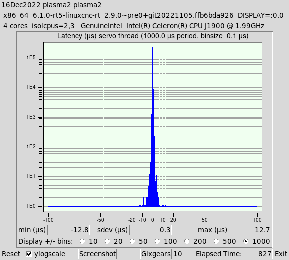

So this custom kernel and using the correct realtek driver solves all issues!
I installed on a problematic i5 All in one and it seems to be running perfect now.
Be sure to use the XFCE graphical environment or issues will bite as the default gnome dektop uses wayland not Xorg so some things linuxcnc expects to find are missing.
Also Gmocappy will not run on Bookworm or Bulseye at present so that needs escalation to the developer. Don't blame me!
I've been through a complete rebuild from scratch so I will post up a seperate how to.

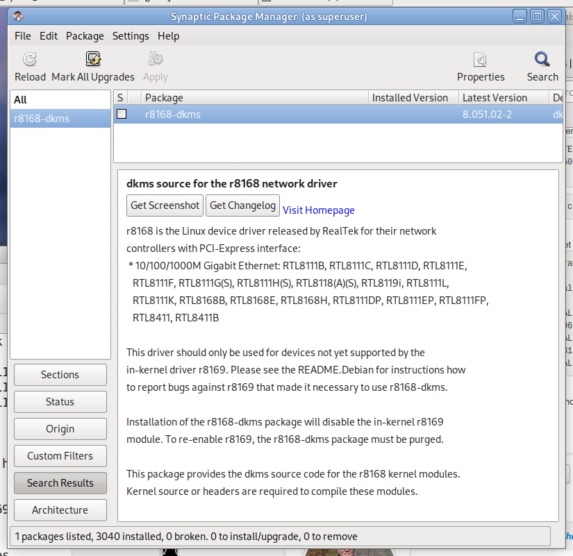

EDIT: I also lost the ethernet card like JT did too but I was able to resolve it.
Boot into the earlier kernel
sudo apt purge r8168-dkms
Reboot back into our custom kernel and the interface should be restored.
Then reinstall
sudo apt-get install r8168-dkms
Reboot to make it stick.

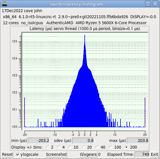

I just installed the 6.1 headers and kernels on this PC.
Running Linuxcnc with my 7i92T I get this for tmax:
I didn't do anything else to this PC and I just got the error finishing read...
JT

Version: Rev X.0xjohn@cave:~$ uname -a Linux cave 6.1.0-rt5-linuxcnc-rt #4 SMP PREEMPT_RTRunning Linuxcnc with my 7i92T I get this for tmax:
john@cave:~$ halcmd show param hm2*tmax*
Parameters:
Owner Type Dir Value Name
33 s32 RW 0 hm2_7i92.0.read-request.tmax
33 bit RO FALSE hm2_7i92.0.read-request.tmax-increased
33 s32 RW 3029671 hm2_7i92.0.read.tmax
33 bit RO FALSE hm2_7i92.0.read.tmax-increased
33 s32 RW 103156 hm2_7i92.0.write.tmax
33 bit RO FALSE hm2_7i92.0.write.tmax-increasedI didn't do anything else to this PC and I just got the error finishing read...
