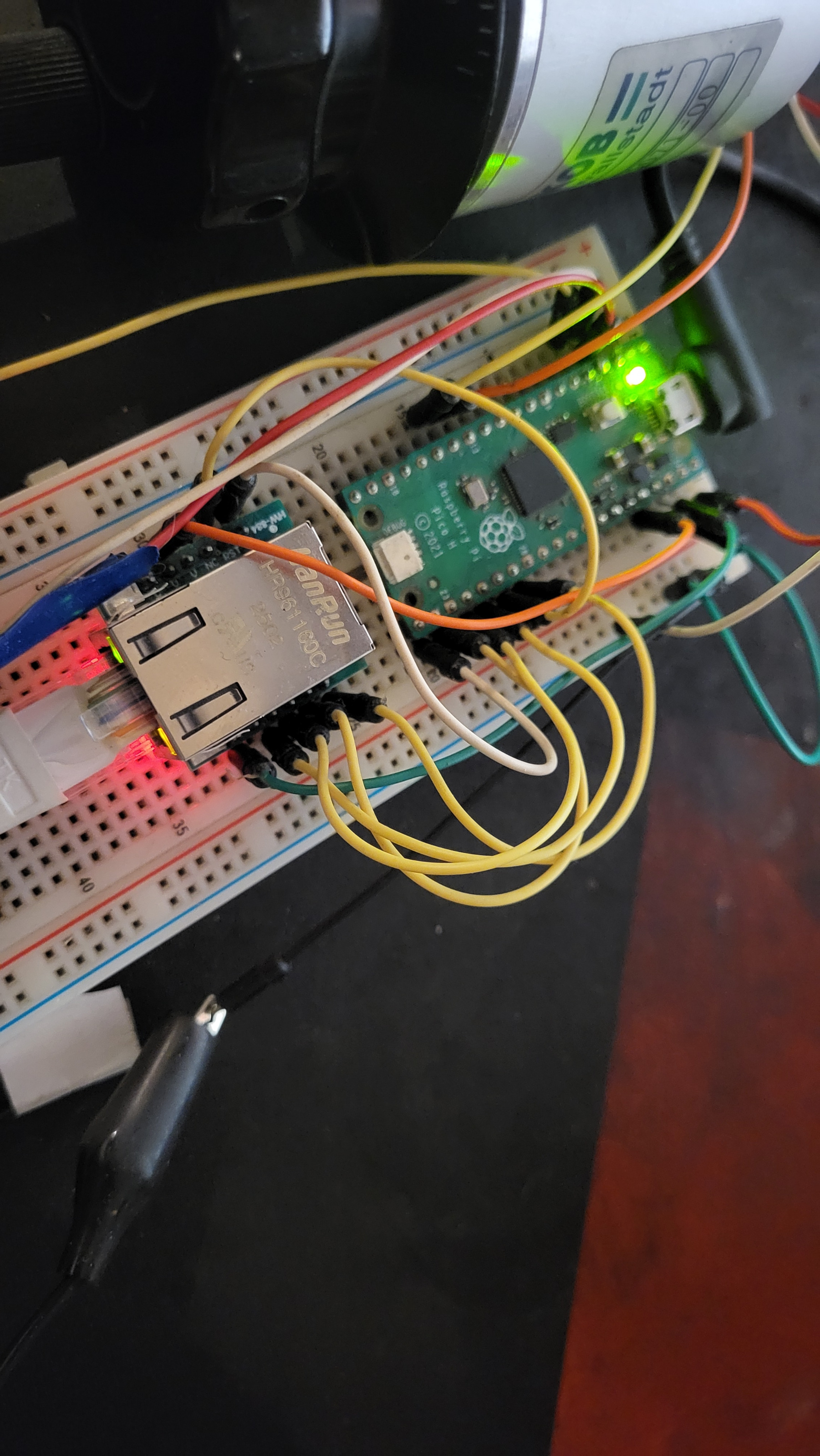

Dear linuxcnc users,
i want to introduce my new open source project based on the W5100S-EVB-PICO . ~10 USD (raspberry pico clone)
features:
1 to 8 step generator with 255KHz maximum output in this version, (possible higher freq) enough for 15m/min with 0.001mm
1 to 8 quadrature encoder counter with 12.5MHz theoretical maximum counting frequency.
current version in the github page is support 4 stepgen and 4 encoders
linuxcnc driver supports multiple instances
planned direct SPI communication with raspberry-pi4 (with normal pico)
github: stepgen-encoder
features:

Update
1.variable pulse width for the step generator (1000nS - 6000nS) set from hal pin.
2.work with pico + w5500 module (connections like in the w5100s-evb-pico)

You say the PI pico connection (connections like in the w5100s-evb-pico), but the Pico pins are different for the SPI0, or am I wrong?

if you use normal pico and a w5500 board, you need to wire like the dark blue pins in the w5100s-evb-pico, pinout here w5100s-evb-pico pinout new video here Embeddedtronics testing stepper ninja

you need a network switch to connect

Precompiled .uf2 in the repository binary directory, you not need to rebuild the project if you want to use
- atrex77
- Posts: 45
- Thank you received: 24
24 May 2025 20:13 - 24 May 2025 20:14 #329072
by atrex77
Replied by atrex77 on topic W5100S-EVB-PICO stepgenerator and encoder driver
The hal driver installation is easy, you need to open terminal navigate to the hal-driver directory and run ./install.sh
Sample hal configuration in the hal-driver/test_config directory

!UPDATE!
the default settings in the code makes the:
4 stepgenerator (up to 512 Khz in 1ms servo thread)
2 quadrature encoder counter (example: 1 for spindle encoder 1 for MPG)
3 digital outputs
1 pwm output (from 1.9Khz - 1Mhz varies from 7bit to 16bit resolution, depends of the frequency)
4 digital inputs
docs how to change this is in progress
3 digital outputs
4 digital inputs
