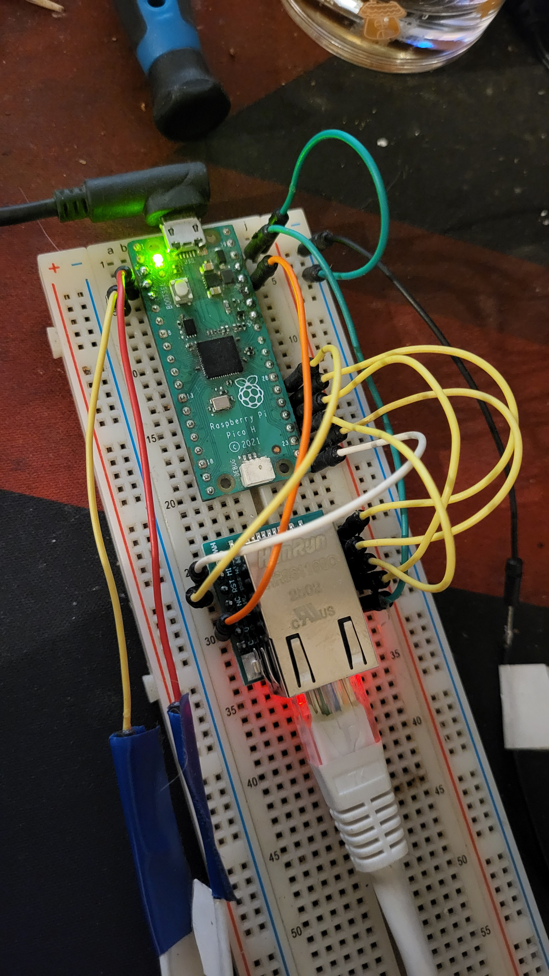

27 May 2025 07:40 - 27 May 2025 07:47 #329193
by atrex77
Replied by atrex77 on topic W5100S-EVB-PICO stepgenerator and encoder driver
Last edit: 27 May 2025 07:47 by atrex77.

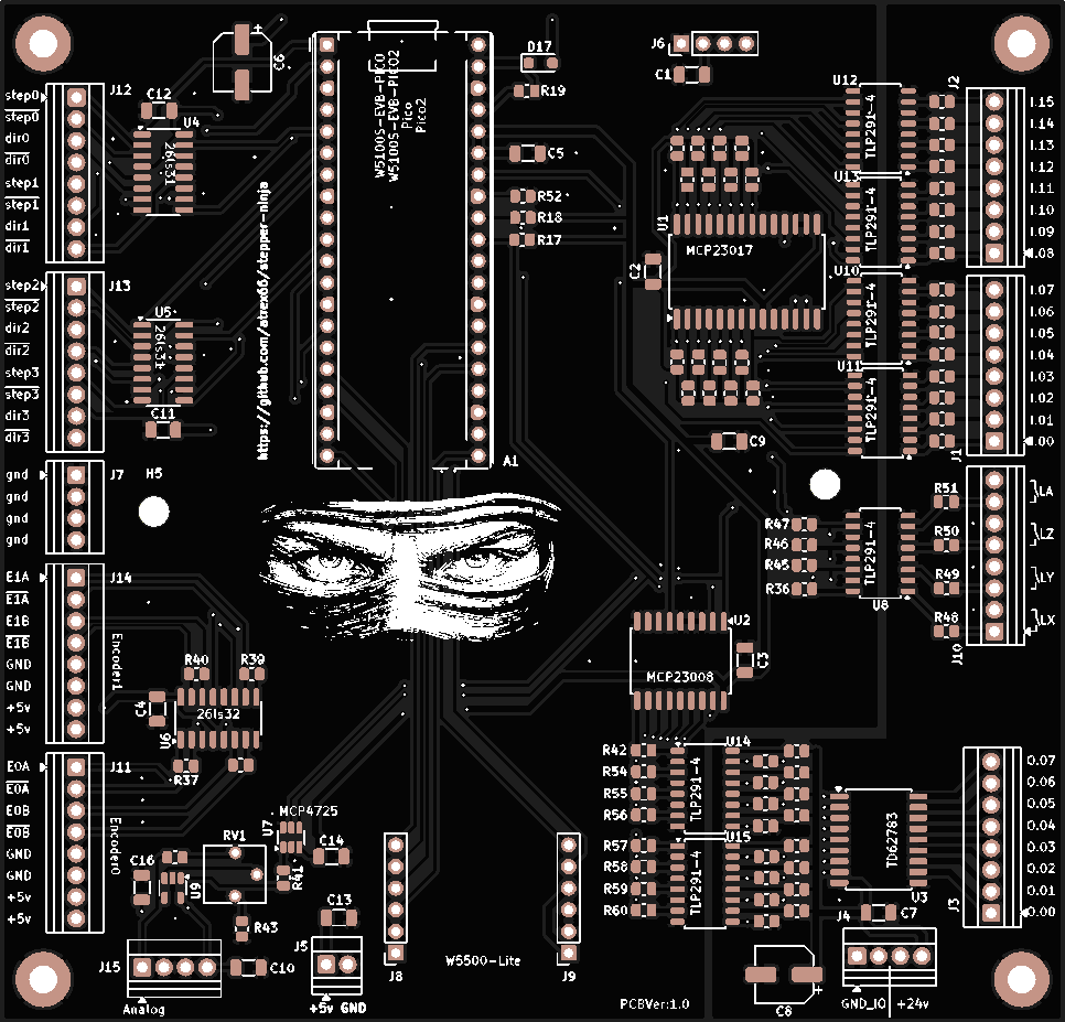

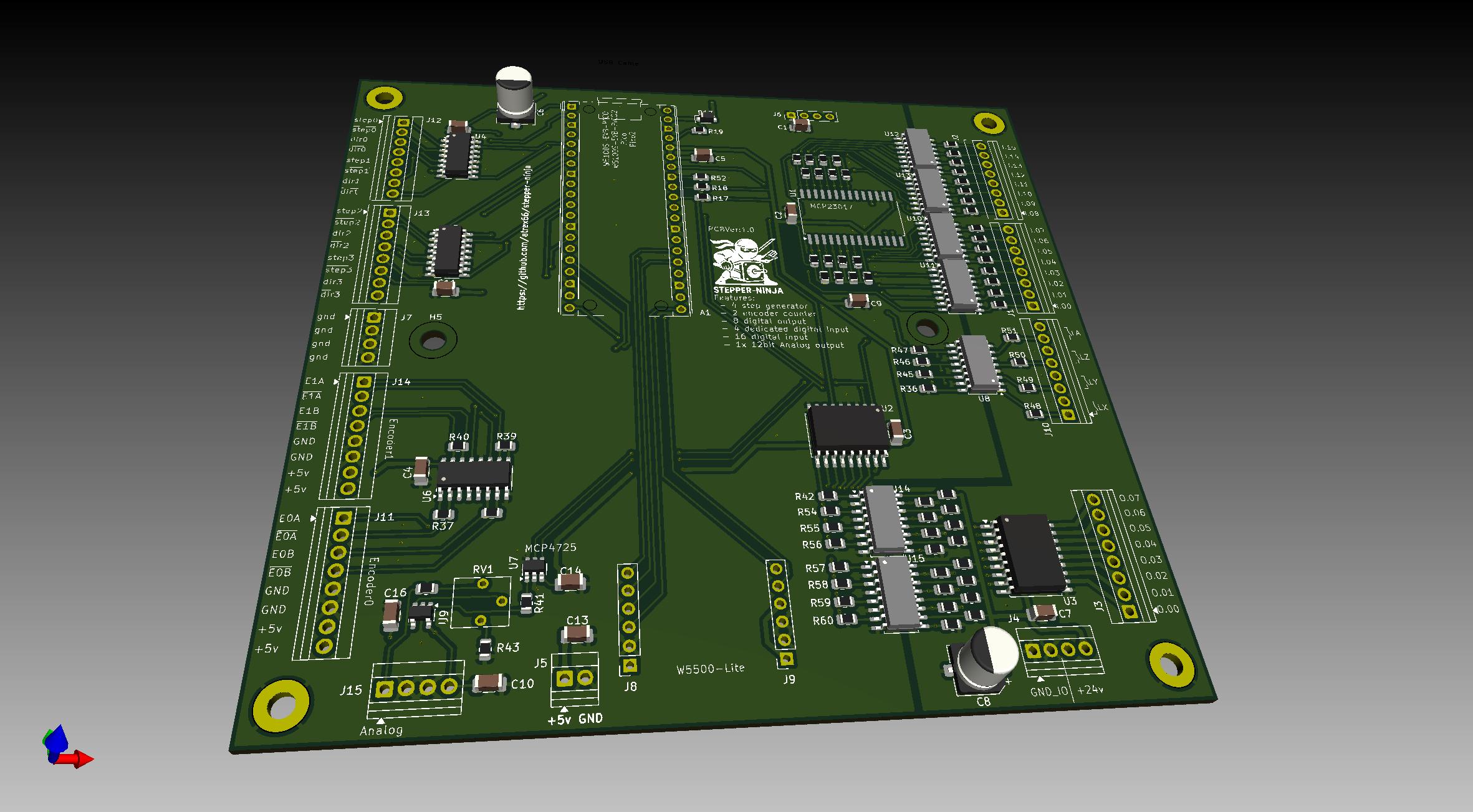

02 Jun 2025 11:19 - 02 Jun 2025 11:21 #329547
by atrex77
Last edit: 02 Jun 2025 11:21 by atrex77.
The following user(s) said Thank You: meister, kzali
- atrex77
- Posts: 45
- Thank you received: 24

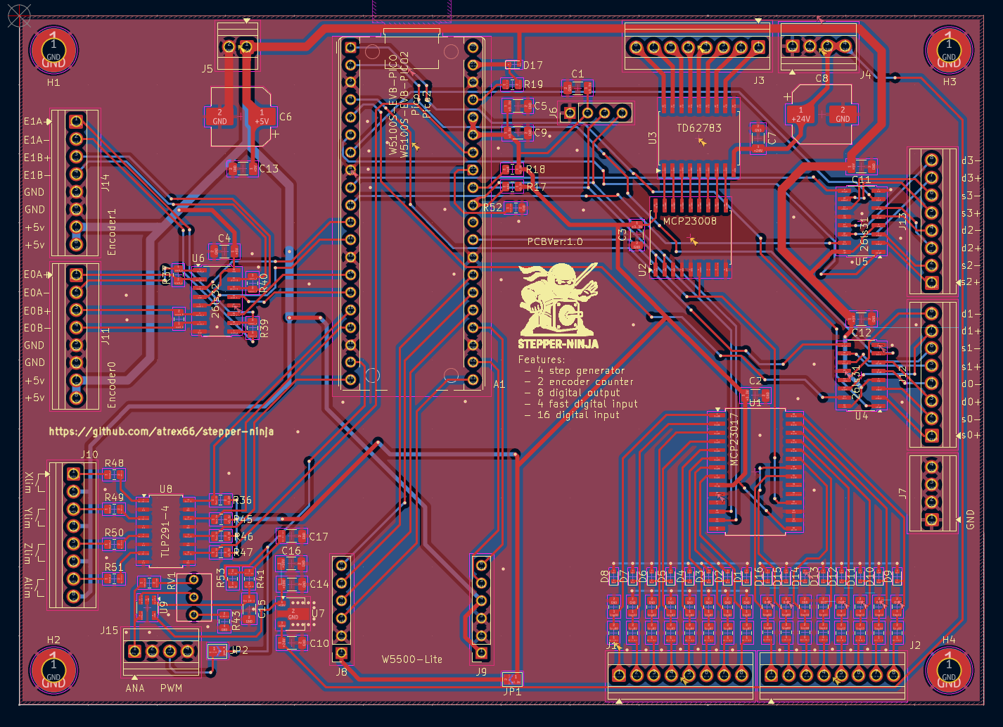

02 Jun 2025 23:18 #329574
by atrex77
- atrex77
- Posts: 45
06 Jun 2025 11:58 #329806
by atrex77
if you want to try i added dedicated hal pin to the spindle encoder index, you can connect it to any input pin, and you can define in the config.h and also set the active level of the signal to active low or active high.
