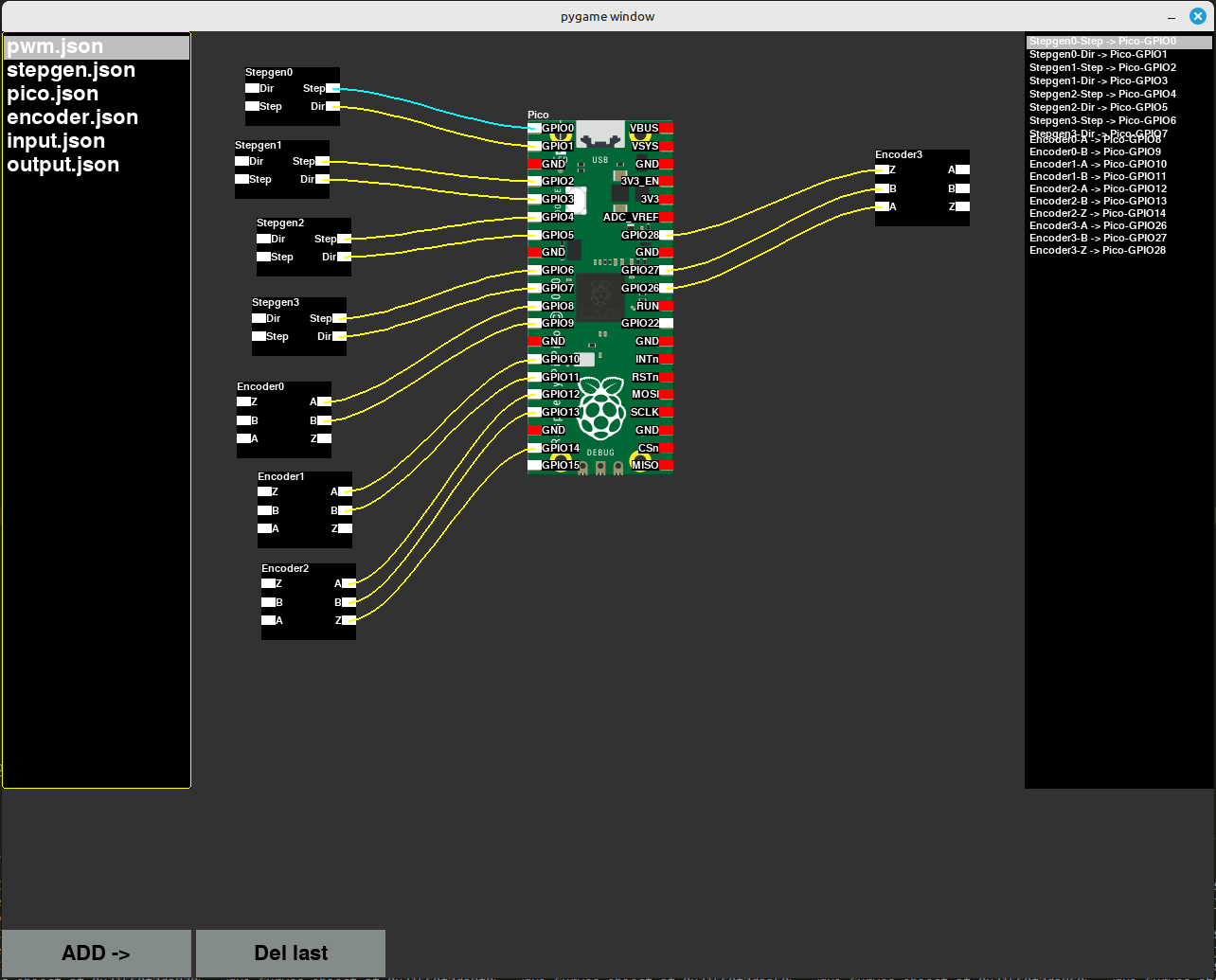

29 Jul 2025 19:21 - 29 Jul 2025 19:25 #332529
by atrex77
started a proper configurator tool in python, early version, if you want to try it clone the test repository.
early sample, most of the functions are not working yet, you can move the components by grab it, make connections by click the pin and click to another pin, and delete the connections using the list in the right side and the "Del conn" button.
Replied by atrex77 on topic W5100S-EVB-PICO stepgenerator and encoder driver
git clone -b test https://github.com/atrex66/stepper-ninja.git
sudo apt install python3-pygame
cd stepper-ninja/configurations/configurator
python3 configurator.pyAttachments:
