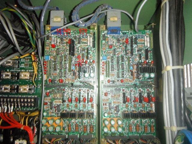

Progress report:
With help from Cory, I think my HAL files are close enough to start connecting stuff.
One of the many new things I will be doing is adjusting the servos to match the 10v power that will go to them now (i don't know what it was before.)
Anyhow Cory use a tachometer to measure his servo speed, I wonder is there an easy way to measure the rpm with EMC2/HAL, or should I just go out and buy a tachometer.
I guess i will probably have to do the same for the spindle, my machine didn't have rigid tapping so I'm not clear what (if any) speed detection it has, other than the servo does have a "Speed Agree" signal.
I'm looking at the board I assume Cory was adjusting things on and see what looks like 11 possible pots to adjust, I think each board (controls 2 axis). I wonder which pots should be adjusted? I put numbers next to the pots, if anyone knows.
Last edit: 26 Sep 2011 15:51 by schmidtmotorworks.
26 Sep 2011 16:12 #13459 by clkeck1
Replied by clkeck1 on topic Re:Mori MVJR Build Log
1 is used to adjust to the rated motor speed. In my instance that was 1000rpm
2 is used to adjust for zero speed.
I have a separate drive for each encoder. But it looks to me that there is another board behind that one with the same pots.

26 Sep 2011 16:29 #13460 by schmidtmotorworks
Replied by schmidtmotorworks on topic Re:Mori MVJR Build Log
Yes there is a board behind it, I was hoping that the adjusters were all on the front board, oh well, something else to take apart.
