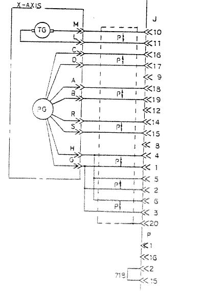

Figuring out some of the HAL connections OK, confused by a few things though.
I find the words" High and Low" in the docs but I'm not familiar with them, I am guessing that going high means changing voltage from either a negative value to zero or to a positive value and going low means the opposite, is that about right? I am trying to find examples on Google but in Germany the search is very difficult (mostly in German).
The main thing that I'm wondering about now is the 7i48 Six Channel Analog Servo Amp Interface.
The HAL file that PCW made for me has sections for each axis.
I see the lines that seem to refer to the encoder
setp hm2_[HOSTMOT2](BOARD).0.encoder.00.counter-mode 0
I guess I need to somehow specify the connection to the encoder wires.
Looking at the 7i48 manual it seems that both the servo and the encoder wires connect to the 7i48.
Does anyone know if or how I need to modify these sections?

Here is a wiring diagram for the encoder connections.

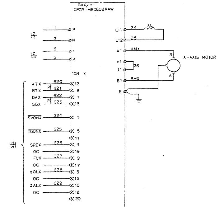

The servo wiring diagram looks like this:
From piecing together info from a few manuals I found these explanations for the abbreviations:
Honda Pin1 SVONX  SERVO ON At LOW the controller is ready to operate.
Make a sequence so that SVON signal is turned on after power is applied
to the controller and main circuit.
Adjusting SERVO ON signal to HIGH turns off control power and main
circuit power
Honda Pin 2 (empty)
Honda Pin 3 OL(X) Overload (normally closed)
Honda Pin 4 SRD(X) Servo Ready
Honda Pin 5 TG ON TGONX TG ON turns low when motor exceeds 1/10 of rated speed
Honda Pin 6 BT(X) Motor terminal B
Honda Pin 7 DA(X) (don't know yet)
Honda Pin 8 (empty)
Honda Pin 9 FU(X) FU Signal becomes low when a fuse blows in the servo
Honda Pin 10 AL(X) Alarm (normally closed)
Honda Pin 11 TG ON TGONX TG ON turns low when motor exceeds 1/10 of rated speed
Honda Pin 12 AT(X) Motor Terminal A or Connected to TG terminal + (manual seems contradictary)
Honda Pin 13 SG(X)  Signal grounding
Honda Pin 14 (empty)
Honda Pin 15 (empty)
Honda Pin 16 OC
Honda Pin 17 OC
Honda Pin 18 OC
Honda Pin 19 OC
Honda Pin 20 Ground
03 Sep 2011 19:51 #12931 by andypugh
Replied by andypugh on topic Re:Mori MVJR Build Log
Almost. In the hardware "high" means at +5V, or +12V, or whatever is being used. In the software "high" means logical true, represented by the number 1.
Low is 0V, or 0 or false.
Not as such. The 7i48 will plug into the FPGA card and all the encoder signals will automatically go to the right places.
In HAL you don't see A, B, Z etc, you see HAL pins for total counts and scaled position as numerical values to be used by the EMC2 system.

Sorry I am so slow to get this. At least one good thing will come from someone with minimla electronics experience doing this and taking notes; I should be able to write this out so anyone like me could do a similar machine in a day or two.
If I understand correctly then, all I have to do is figure out how to match-up the mesa diagram for the 7i48 and the wiring diagrams from Yaskawa and connect the wires and the rest should work?
Now I'm wondering does the spindle get connected to the 7i48 too? or can it be handled with gpio alone?

03 Sep 2011 22:33 #12936 by andypugh
Yes, pretty much.

03 Sep 2011 22:38 #12937 by andypugh
I don't understand your encoder wiring, but as long as the drives do, it might not matter.
Does the drive pass-through quadrature pulses at all?

All I know so far is what I see in the diagrams, if I understand correctly, I think the drive does not pass through quadrature pulses but I don't really understand any of that in fact I am just trying to read up on it now.
Best Regards
