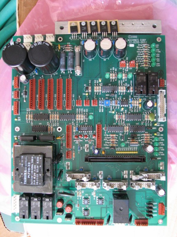

18 Jan 2017 17:56 - 18 Jan 2017 18:13 #86072
by dynamyte24
Replied by dynamyte24 on topic Light Machine Corp. Benchman XTr (retrofit)
Don,
Thanx for the info on the 4th axis jumper plug.
I just got off the phone with Trevor at Intelitek and have a jumper on the way!
I'd like to have the info about jumpering on the board itself, as I'm not certain
that the 4th axis connector on the back wall is the OEM unit.
Yes, my machine has flood coolant.
I have no qualms as to using my DVM and jumper leads.
I've attached a pic of my spare main board, which as far as I can tell is identical to the board in the machine.
Rex
Rex

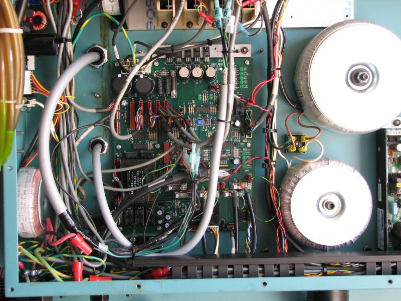

- x-Intelitek Engineer
- Posts: 113
- Thank you received: 22
18 Jan 2017 18:33 #86076
by x-Intelitek Engineer
Replied by x-Intelitek Engineer on topic Light Machine Corp. Benchman XTr (retrofit)
Rex,
My questions about the DVM and jumper leads was meant for TGTROPIC and his troubleshooting issues.
From your photos, you do have the OEM 4th axis connector. I can see the top of it in the wall just below K1, K2, & K3 on the control board.
To change the jumpers to make the machine a 3-axis machine, move HDR2 to the left two pins (1-2), for a 4-axis, move HDR2 to the right two pins (2-3).
Don
Don

- dynamyte24
- Posts: 15
18 Jan 2017 23:08 #86102
by dynamyte24
Don,
Thanx so much for the 3-4axis jumper info. I just ran over to my shop to try it out, and it lit right off with no 4th axis encoder error.
Life is good!!
Rex
Don,
Life is good!!
Rex
