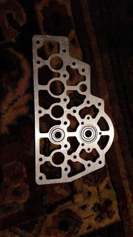

I went with the Kflop/Kannaolg because of the Mesa supply problem. I gave up waiting for them to be able to send me a card. At the time I think they were in the middle of supplying someone with a commercial application so my order was constantly being bumped.
I have everything but the tool changer working. I made this part using a .25", 2 flute end mill, running at about 2500 RPM and 4 IPM. It takes about 2 hours for all the operations but I'm really happy with the accuracy. The bearings are press fit and that was what I was after. However, the numbers say I should be able to run about 4000 RPM at 12 IPM... The piece complains a lot and running it over 11 IPM I experience a spindle shut down that I believe is something in the Ultra 100. I used the application you shared and finally was able to talk to the unit! Now I just have to learn what it all means.

OOOPS! Forgot to mention... the cut depth per pass, .0625".... Should be able to do twice that according to the numbers.... must be for Bridgeport sized machines.
