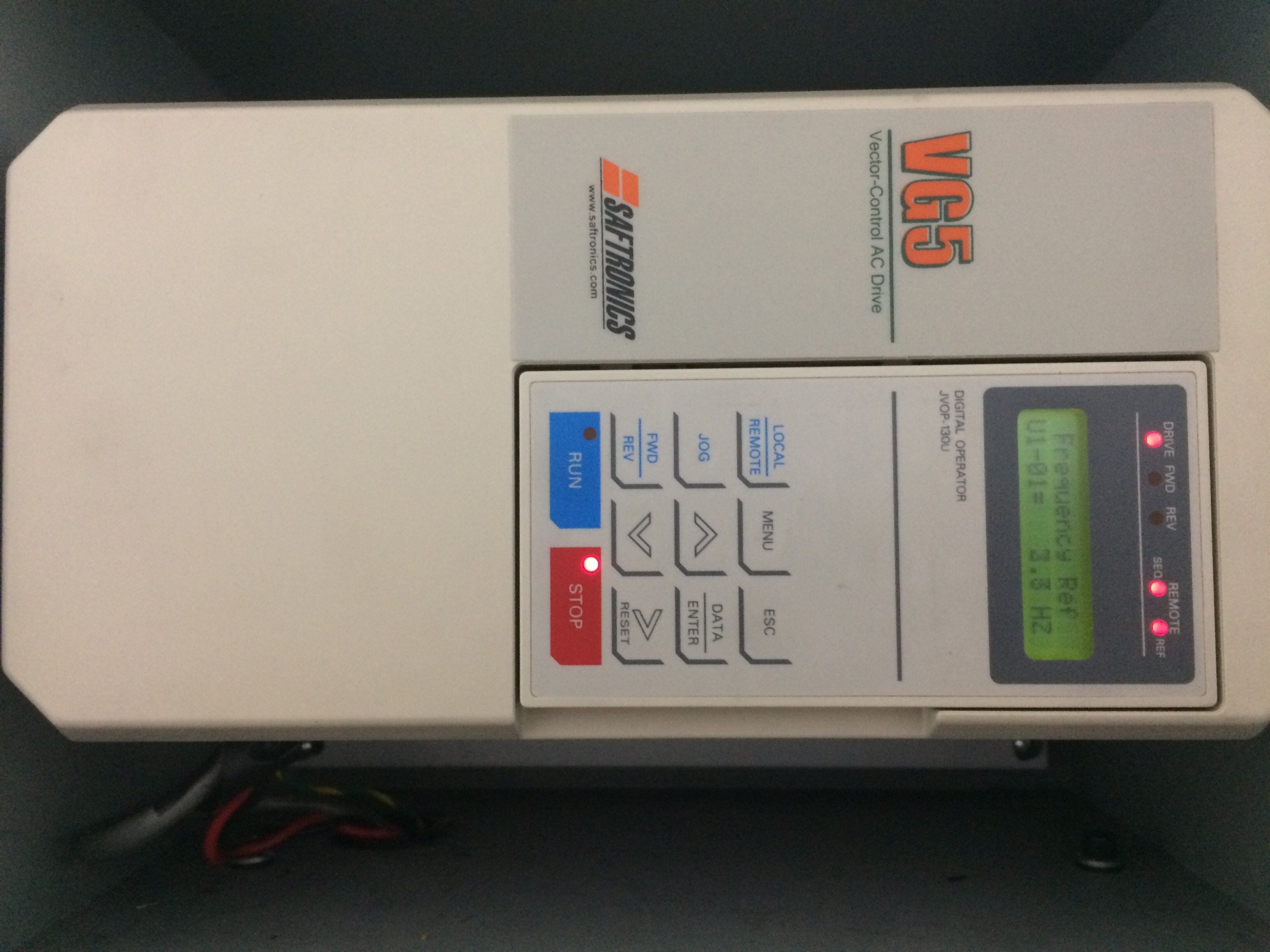

Hello X...I could REALLY use your expertise and have attached a file containing all of my board discussion since joining on 12/10/16 to help save you the trouble of flipping through several pages. I am hopeful that you can offer some additional troubleshooting help.

TG, can you please post a photo of the inside of the control box on the back of the machine? I need to see the version of the machine, control board configuration, speed control, etc.

17 Jan 2017 12:14 - 17 Jan 2017 13:12 #85972
by TGTROPIC
Replied by TGTROPIC on topic Light Machine Corp. Benchman XTr (retrofit)
Last edit: 17 Jan 2017 13:12 by TGTROPIC.

TG,
That is the speed control I was expecting to see. Can you also provide an overall view of your backpack layout? I remember that the speed control is in an external box above the backpack, but what I am concerned with is the PCB stackup/layout inside the electrical box. Specifically is it a single board system or are there two boards stacked one-on-top-of another? My thinking at this point is that we are getting an undesired spindle fault and that is causing all your problems. Once I see your configuration, we can begin.
Don
