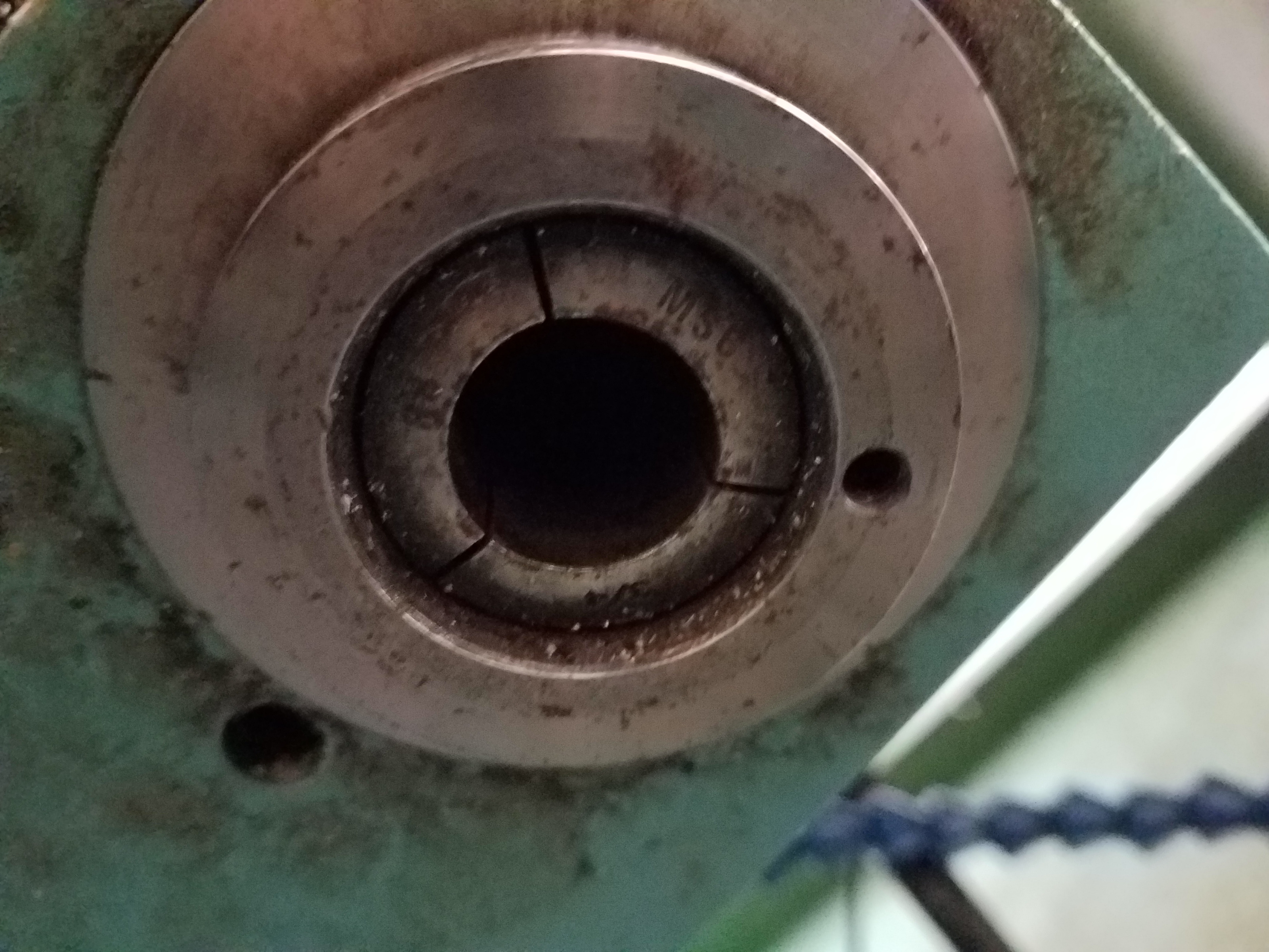

24 Oct 2018 03:20 #119311
by steve_a
Replied by steve_a on topic Light Machine Corp. Benchman XTr (retrofit) Spindle Sensor Question
Question.... This is a picture of the tool clamp from underneath. There is a screw hole on the rim. Mine came as seen and the question is, "am I missing something here?" Also, I have been trying to read the proximity sensor and I am pretty sure it is working, but it is not sensing anything. I assume it is an index for the tool changer. Is there supposed to be a magnet or a piece of raised metal that it is supposed to detect?
Steve
